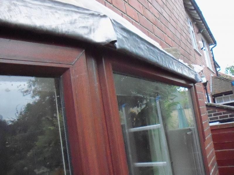

lead work above a bay window

Hi all i hope someone can help. we have just had some lead flashing above our bay window from 5lb lead. however the lead shows the beating,or working marks and im not sure if it is just rough or to be expected. there are no cracks or anything but ive never seen the lead before it weathers so it realy catches the eye

Wow...thats shocking mate. Those corners should be bossed down on the corners so that its flat like the rest of the drip edge.
What length and code is that lead by the way?
calder code 4 450mm wide with code 4 150 wide piece on top overlapping by around 75mm.

Done by a " roofer" not a Time served plumber : Guess which I am ;) Code 4 is 4pound ( per sq. foot weight) code 3, 5, etc. all pro rata . So your " roofer" can`t use a set of scales , unless he`s weighing in the scrap lead :rolleyes: Give him an enema of Patination Oil too :LOL:
What's going on immediately above the lead? You really require a leaded drip cap ( a throated, wood angle fillet flashed with lead), pointed into the brick bed. Code 4 is sufficient for bossing in and around the angle.
1.5m or five feet is max length for lead.
The bottom "lip" thats rolled in will, over time, droop and the flashing may begin to flap and even split.
Is this flashing covering some unsightly detailing above the frame?

nigel Im not too sure what your imput refered to however the size/quality of the lead was taken by me off the "new" roll i saw him unwrap and work ( alas not magic but there you go)
He was recomended to me by a now very apologetic friend as a " qualified old style plumber" who had done a lot of lead work.
The top lead was wrapped to a fascia board and the lead face finised on the same plane as the brickwork above. the lead went into the wall by 15-20mm and the gap between lead and brickwork pointed with lead mate.

Most people don`t ;) It`s just that you said originally that you`d had some work done in 5lb. lead - Which it should have been - you got 4lb. and unfortunately someone who can`t work it :cry: Patination Oil should have been used to coat the finished lead and stop it leaving white deposits where water runs off it . ( using it as an enema on the "roofer" was a joke )
