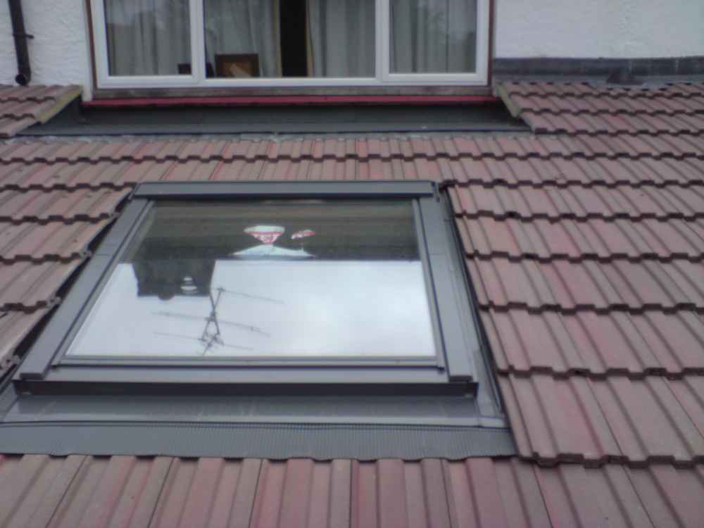

Hi
I need to put lead skirt on top of my roofing but the tiles are Redland 49s. This means that there is quite a lip on the bottom and trying to mould them to the shape of the tiles is going to be hard enough on the side of the tiles let alone the bottom.
Whats the easiest way to do this?

Yes that is it but normally (well all i have seen) the tiles are at 90 degrees to the wall, in my case the tiles are parallel
I'm afraid that i dont know what you mean - could you post a pic of where the tile meets the lead?
I'm at work at the moment but i have done a search on the internet and found a picture showing the opposite of what i have. The pic attached is where the tiles are at 90 degs from the house, these would be reasonably easy to 'boss' as they run in a similar line and the lead only needs to be moulded into the grooves on each tile.
On my roof it is different as it is a pitched roof /\ shaped as you look at it so my tiles are parallel to the house, just wondering how to boss these tiles when they are running the other way as there are two bits that would need covering, the grooves in the tile and also the ends of each tile.
Not too sure if this helps

Like this type of thing?
If so same thing, lead gets formed/bossed around the tile profile.
Yes that pic is correct and similar to mine, only differences are that i have a continuous groove to slip the lead into and the tiles (being Redland 49s and not flat) are quite a strange shape to form. The big issue i have is at the bottom of the tile where meets the next tile, the flat ones in the pic are probably considerably slimmer than the Redlands.
