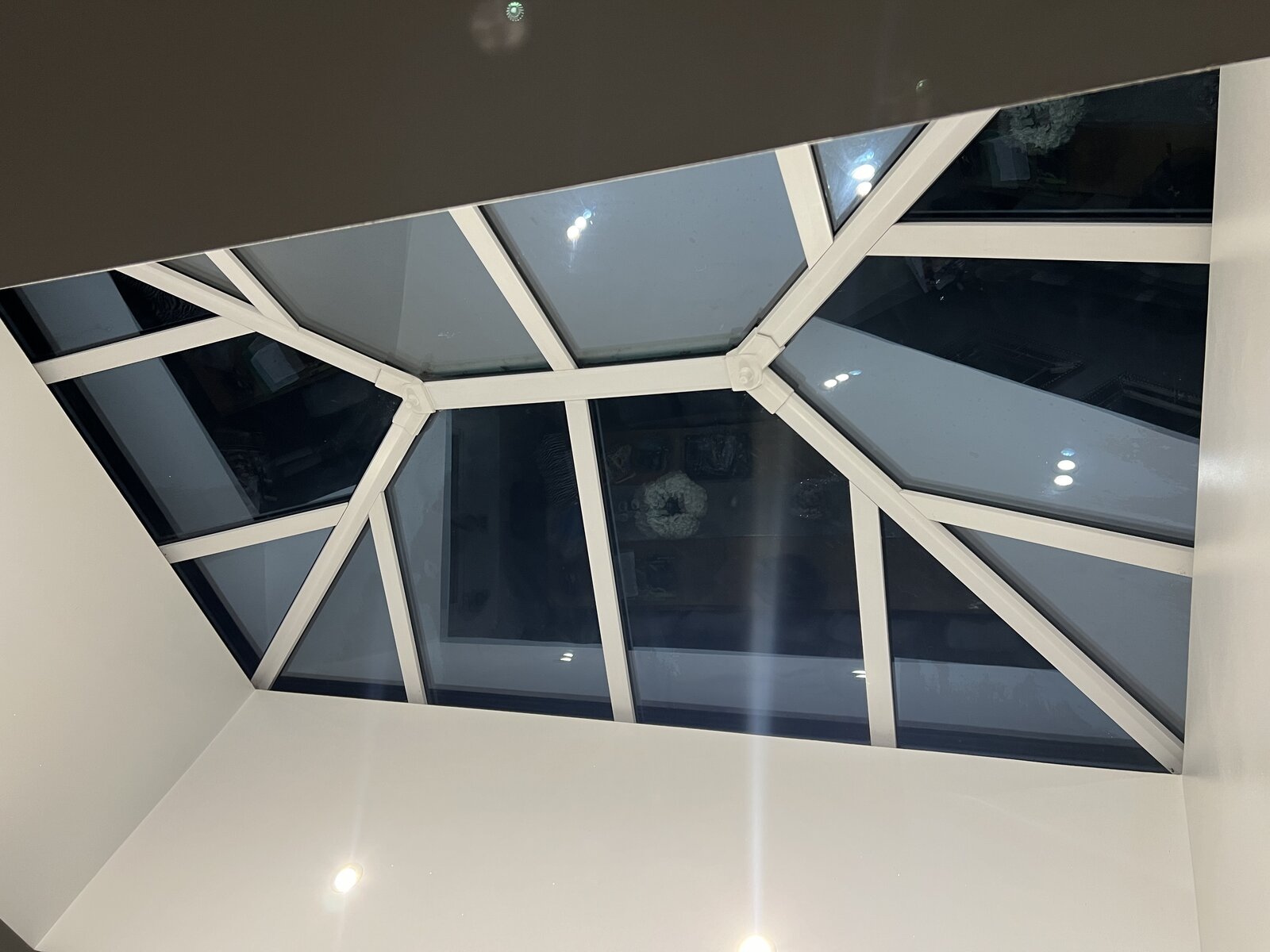

I’ve got one of these that is now around 10 years old. Noticed a small leak from one of the window seals for a pane.
I can easily get to the top of this. Can you please advise on how I go about resolving this. Many thanks.
Tricky
Mark where the leak is, then on the roof take off the cover capping and see if you can see the leak path - it could come from some distance away.
These are generally drained, so water getting in should get out at the bottom of the hips and rafters, so look for a leak point, that follows a route inside. Sometimes you can see staining which indicates the leak.
I saw some videos online where they are using CT1 to seal suspected leaks along the glass and framing. Does that work in your opinion?
