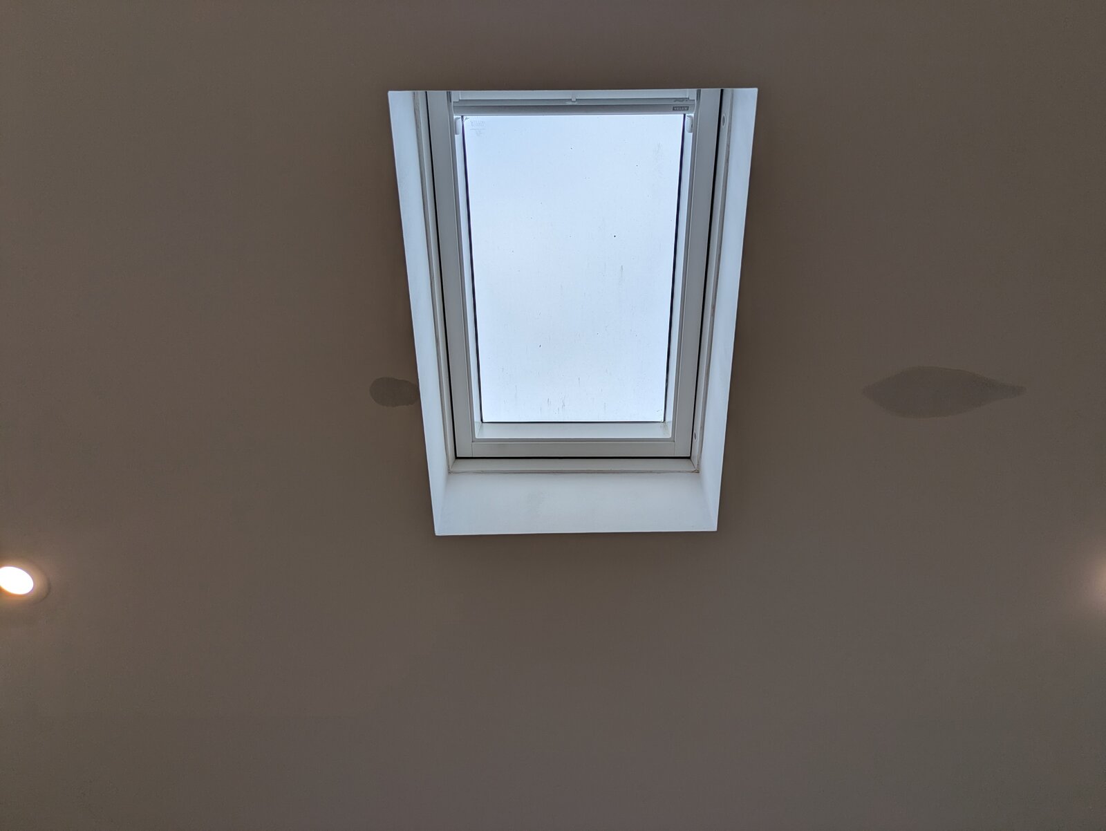

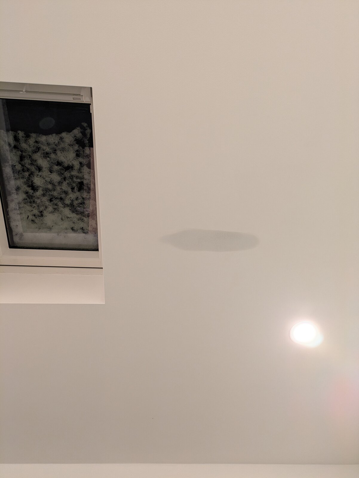

Hi
Last summer we had a single storey extension with a vaulted roof built. The extension is divided into 2 rooms with a Velux in both.
During the snow before Christmas when we had the snow, we noticed a wet patch to the right of both Velux windows, strangely in almost identical places in both rooms.
The builder said it was due to the snow and has put some leading on the tiles around the widows.
It dried up once the snow melted and all was good until this last week.
The wet patches have came back this week but they seem to come and go. They are normally there in the evening and gone by the morning. I'm starting to think is this due to the extra heat in the room in the evenings.
Has anyone got any ideas of what could be causing it and how we can stop it?

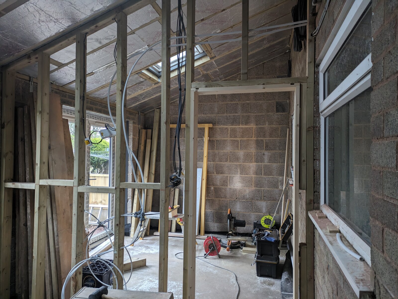

They are not the best but I will add some more photos I took of the roof during the build.
Fix some plastic over.
If water is under it's a leak.
If water is on the plastic surface its condensation

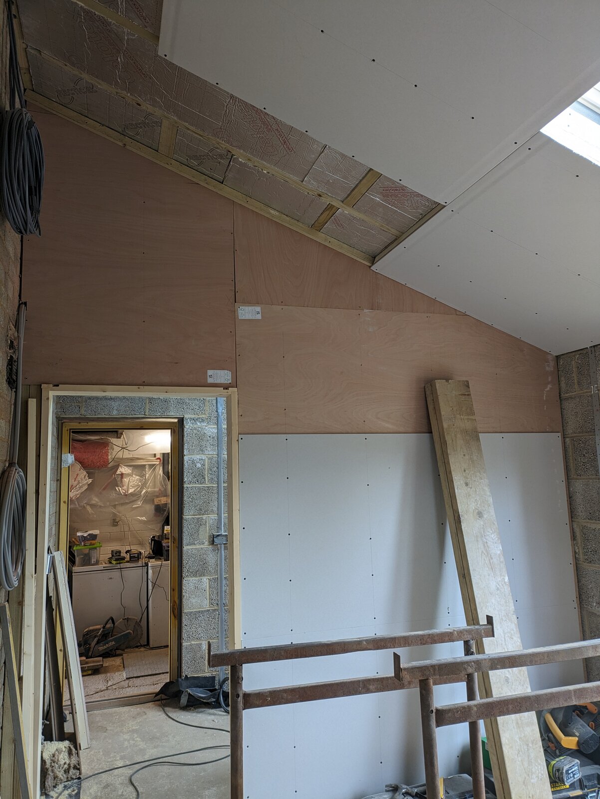

Looks like it's coincidental with the joint between the plasterboards.. Water dripping onto the back of a plasterboard tends to show through at the edges first

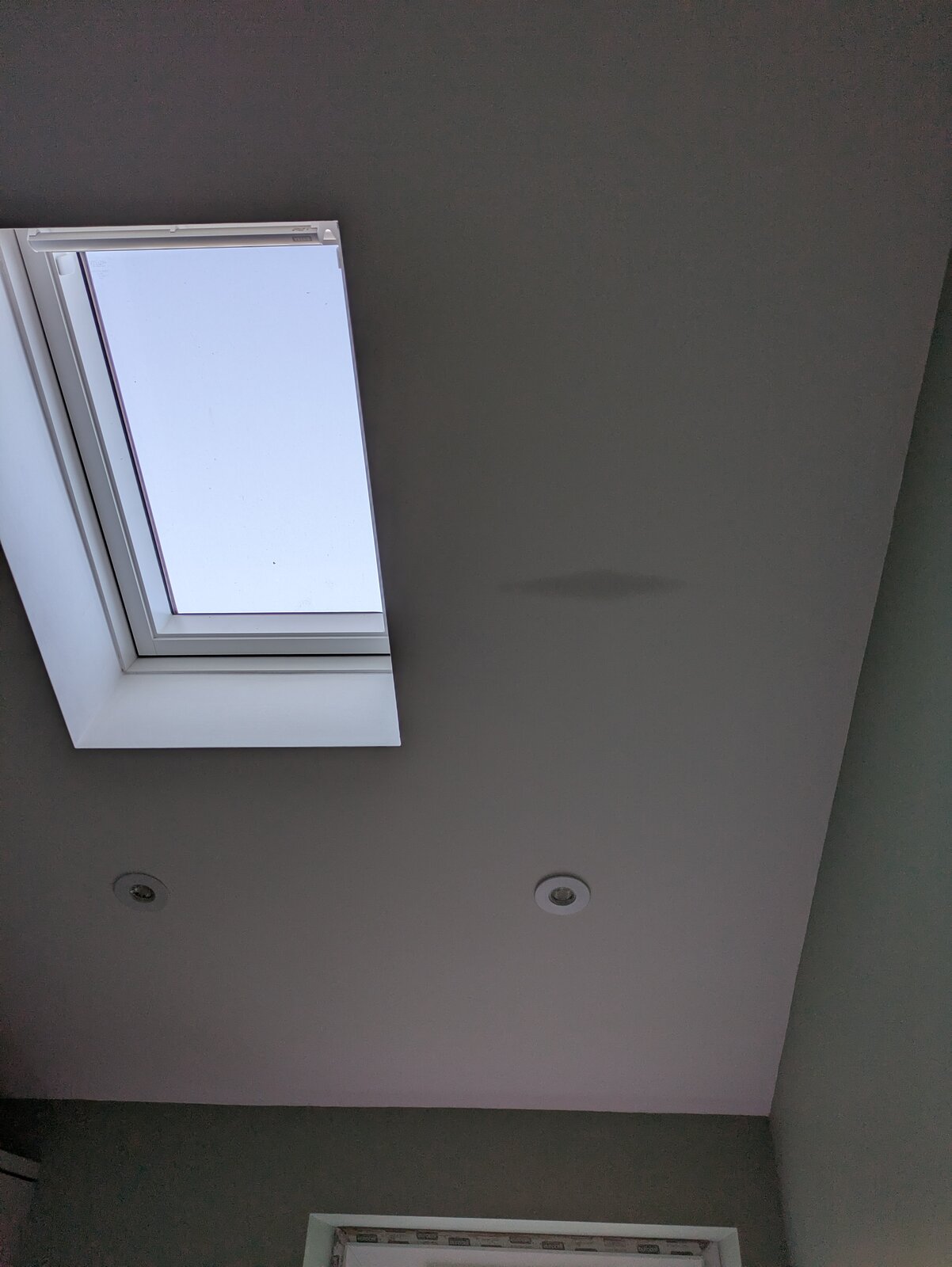

This morning for the first time it has appeared on the other side of the window.
My thinking is it's condensating in the roof space and dripping then running along the insulation until it finds a way out, which as you say @robinbanks is the edge of the plasterboard.

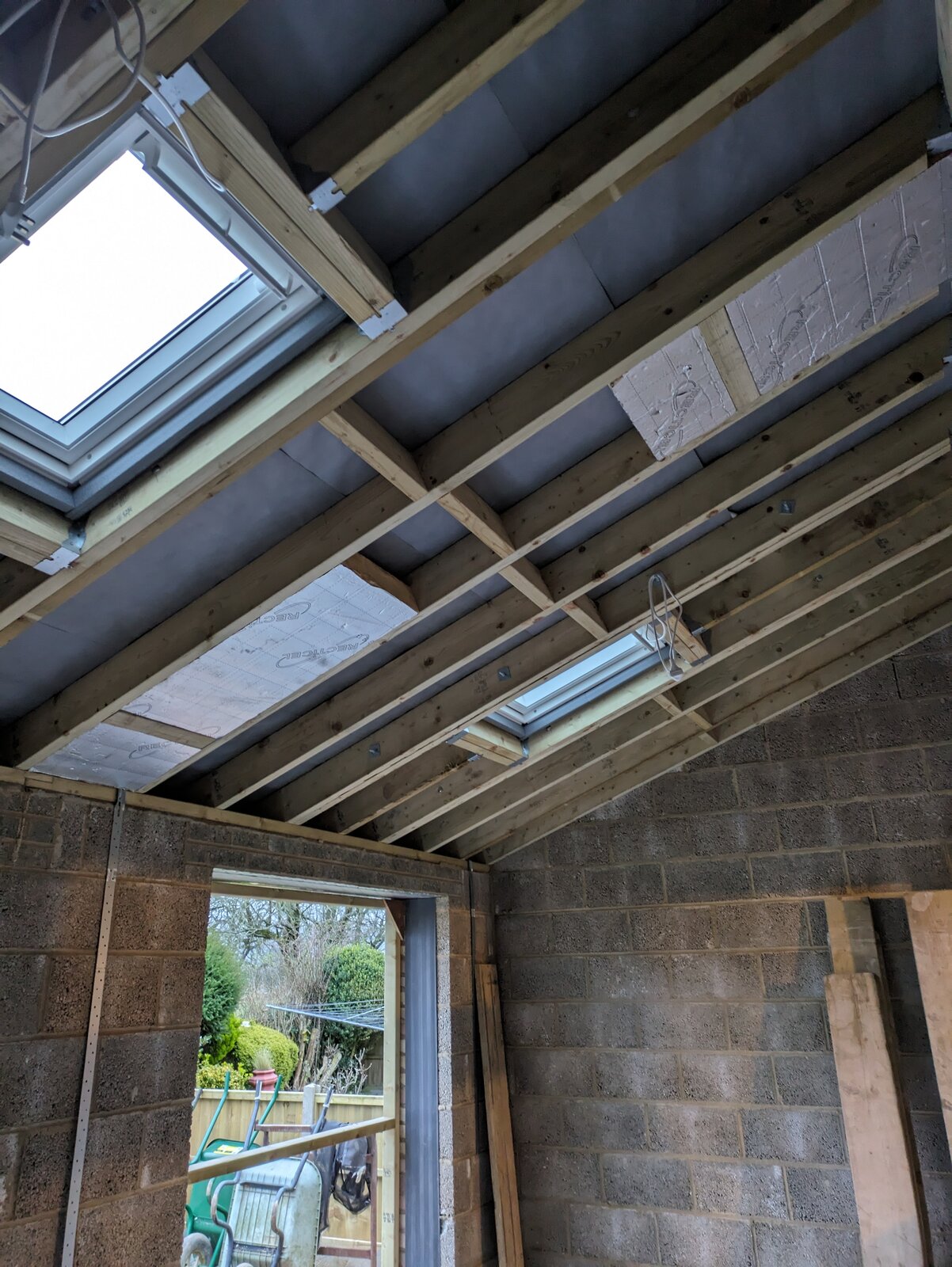

Can you take a ridge tile off and poke a drain camera down between the membrane and the insulation/above the membrane and see if you're getting any condensation forming on the underside of the tiles and or the membrane?
Was a VCL installed on the room side, behind the plasterboards(perhaps the insulation boards were foil taped together where the met the studs - if you looked up did the whole ceiling look silver with no wood coloured bits on show? Like this bit here:

He should have foil taped the joints on the insulation boards or installed a vapour barrier..I would say it's condensation.
I'm pretty sure you could still see the timber, I'm not sure what that single piece of silver tape was for.

Show the BCO the pics you have before the plasterboard went on! The insulation boards should be foil taped and the roof tiles half bonded as per manufacturer's installation instructions.
