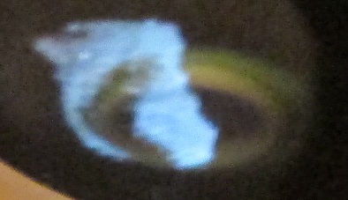

There is a damp patch under the hot water cylinder, but no sign of water dripping.
When I examined the underside of the cylinder using a mirror I could see some white stuff near the central indentation. Here's a pic - you can see part of the mirror in the bottom left corner.
There's no sign of any damage to the cylinder and water hasn't come through the ceiling below. Is this limescale, if so how did it get there?
The cylinder is only standing on two bearers, so most of the cylinder is unsupported. Shouldn't there be a piece of wood, about 450mm square and 25mm thick on top of the bearers to distribute the weight?
The plumber is coming later today to look at the problem. I'm guessing that it means a new cylinder (vented). Which are the good makes?
Standing on two bearers is not good. Should be fully supported ( flooring grade ply being an example )
How old is your cylinder? If you renew, think about adding an emersion as a back-up
Possibly a pinhole leak, enough to make it damp and get the deposit build up, but not enough to be noticeable to the naked eye otherwise.

Don't know how old the cylinder is. We've been here over 10 years and the cylinder was in place when we moved in. The foam casing is 30mm thick and a light green colour; unfortunately the only label on it just says " Choice: Energy and Environment Efficiency. ODP Zero Insulation." The plumber, who has just left, reckons it could be the original, therefore installed about 30 years ago.
The plumber mentioned that some cylinders are made of a "copper substitute" (stainless steel?) due to the high price of copper. He also mentioned Gledhill when I asked which make he used. Comments please.

2x2 bearers are just fine. The only reasons that's done is so that the cylinder underside dosent sweat thus corrode on the seam because that's the weakest part of a cylinder. The airflow/air change wont let the sweating ever occur
