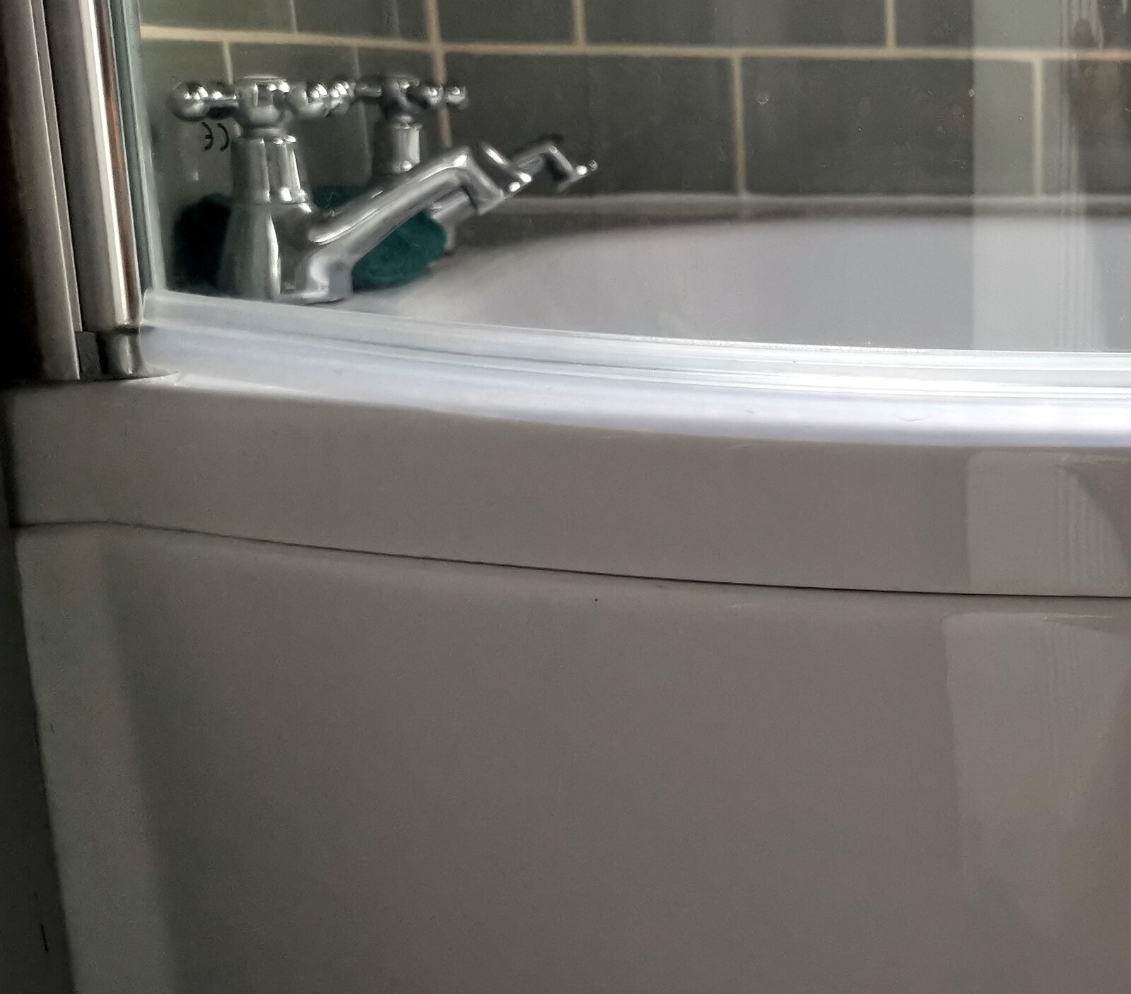

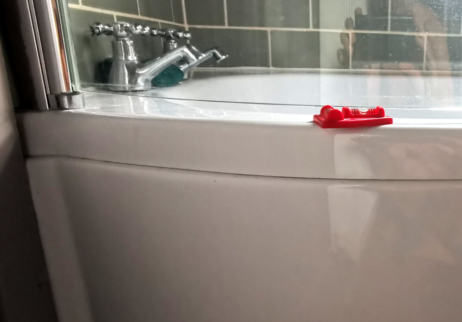

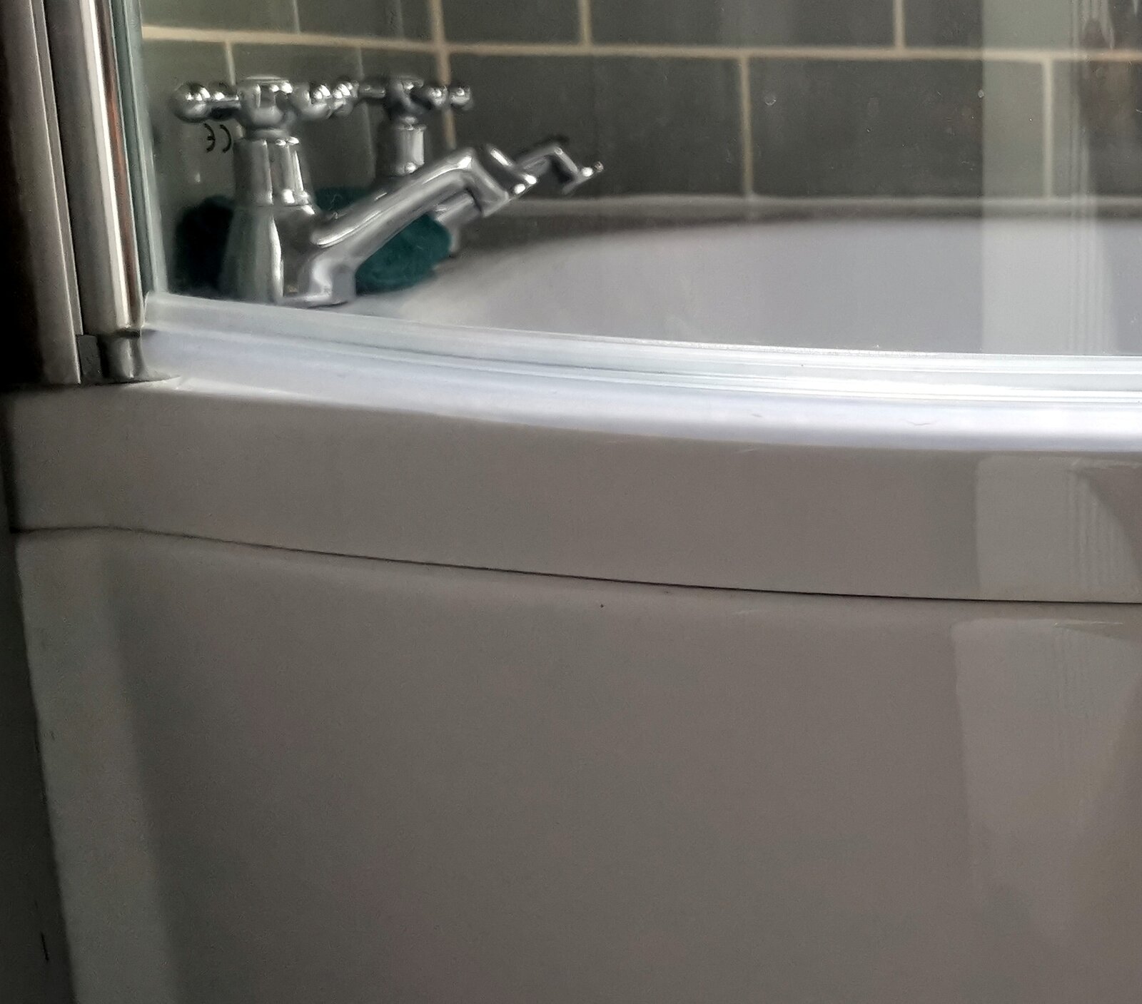

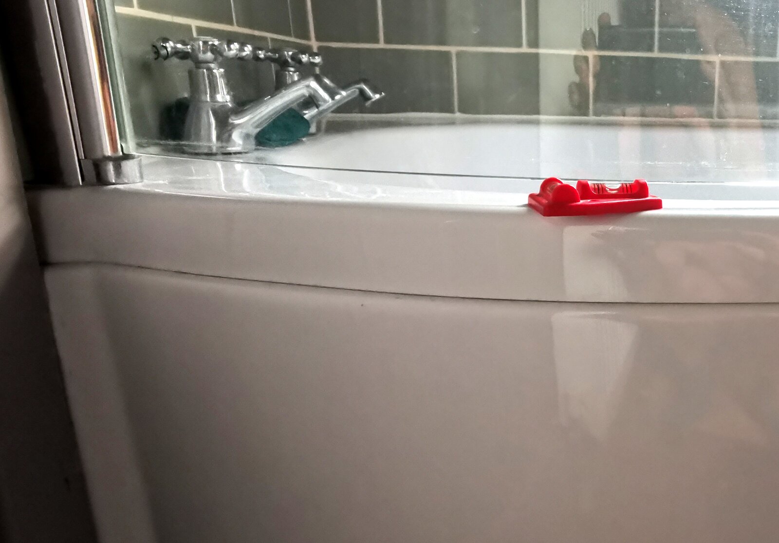

I've taken it off and turned it around but you can see there is more of a gap nearer the hinge side and the spirit level is spot on.

No, its for leveling a camera on a tripod.
Three possibilities - Either the bath edge is not level, the wall to which the screen is fixed is not vertical, or finally, and less likely - the screen itself is not square.
A camera tripod level is not adequate, you need a proper level, at least two feet long.
