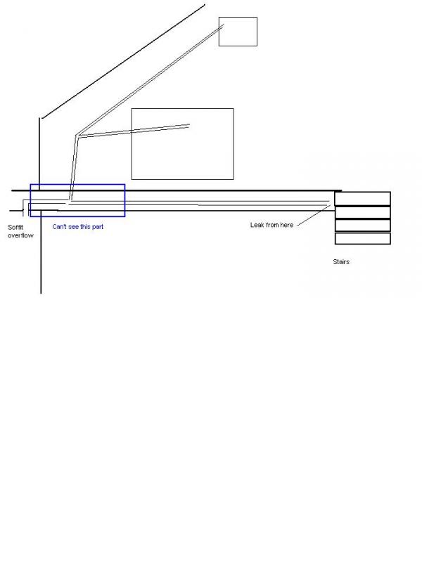

Last week I found water dripping down the wall in my stairwell; turning the heating off stopped it.
Having had a fun weekend ripping up the carpet and floor in my (converted) loft, I can see where the water is coming from but I can't understand how things have been set up.
As far as I can see
- the water is coming out the end of an open plastic pipe that ends just above the stairwell
- the pipe runs back under the water tank and it looks like it connects to the overflow pipes coming from the water tank and central heating overflow tank
- although I can't see it (can't get to it) I think the overflow pipes also connect to the external overflow pipe coming out of the soffits (it's in the right place)
This diagram might make it clearer..(click to enlarge)
So I *think* the overflow pipes must come into a T junction, one branch going outside and the other branch connecting to a pipe that runs 10 feet the other direction and just drips water under the floor into the stairwell..!
The obvious fix is to cap off the interior pipe. But I'm wondering is there any reason why this pipe is needed? Why on earth would would a pipe that could get water in it be left open inside the house?
(Note I'm sure this is where the leak is coming from as it is in the right place and the end is wet; also the overflow tank is full so turning the heating on would probably force water into the overflow system)
Any thoughts gratefully appreciated!
