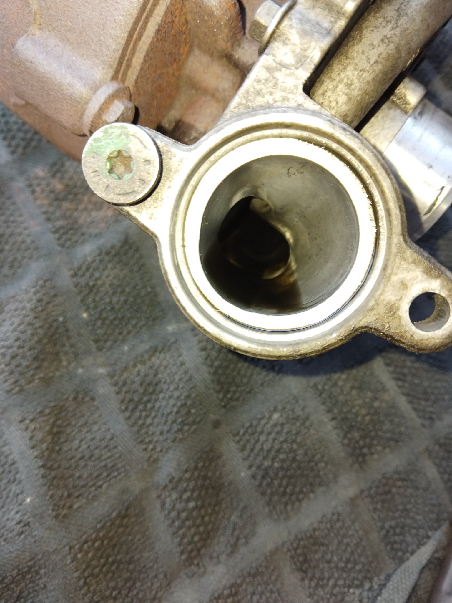

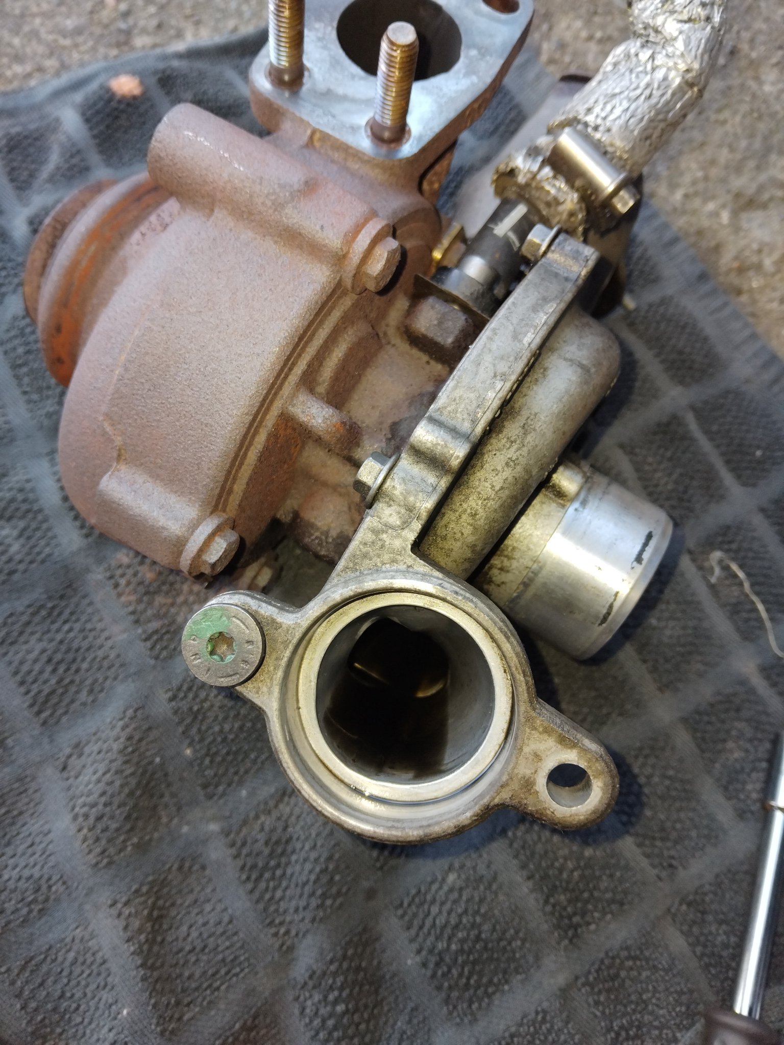

I have a ford focus mk2 1.6tdci, it's failed it's mot on emissions, it's usually .50 on the test but this year it's jumped to around 2.50 which is too high for a car of its age, a euro 5 which had a top limit of 1.50 emissions, there's no lights on dash saying anything is wrong and the car seems to be running sweet, I've cleaned the egr which seemed which wasn't very dirty anyway, I've also taken off the dpf and cleaned that out which didn't seem very dirty, pcv seems intact after I inspected it, the only thing I can find is quite a bit of oil on the intake side of the turbo, it's trickled down into the airbox at some point, the intake turbo fins are covered in oil also, I took the turbo off to inspect and had to pour oil out of it as in attached pictures, I wonder could this be the culprit that's sent the emissions up??? Any advice greatly appreciated.

If there's enough oil in the inlet side of the turbo that you had to pour it out, then oil will be getting into the intake air which will then be burnt in the engine which will affect your emissions.
The question is whether the oil in the turbo is leaking turbo seals or some kind of crankcase ventilation problem.
