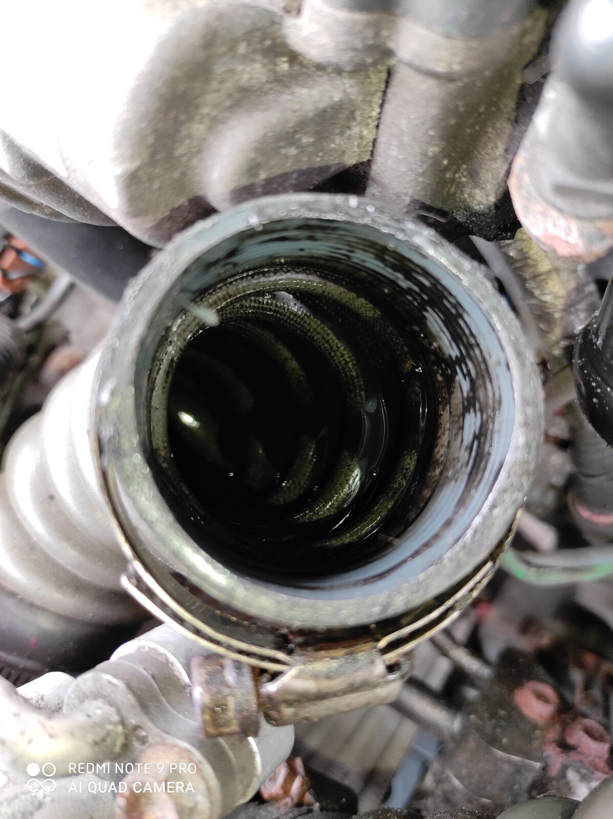

Hi,
I have a 2012 Mazda 3 with the 1.6 PSA diesel engine. The intake and intercooler is caked in dripping oil, I know a bit of oil is normal but this seems excessive. Car produces some blue smoke on startup then goes away, also noticed when I was behind my dad while he was driving it a puff of black smoke came out the back when he floors it.
Is it the turbo seals going bad? There isn't any play in the shaft and has plenty of power but it kinda makes a whining noise when I rev it which is making me believe the turbo is going bad. It has 140k miles on the clock.
I checked the rubber diaphragm for the PCV system and its in good condition. Getting fedup with the car now as I've had injector issues and the clutch just failed as well. The 1.6 really is a horrible engine, won't be buying another haha.
Sadly I think your diagnosis is likely to be correct.....the DV6 does have a weakness regarding the turbo oil supply unless the servicing regime is strictly attended to.
Modifications include removing the oil mesh filter in the turbo oil supply and cleaning the oil strainer gauze in the sump.

Yeah not a very good engine I'm afraid. There's just one thing after another to replace on the car. I've had 2 injectors fail within 5000 miles of eachother, I imagine the other two are gonna fail soon as well.

The turbo also needs proper cool down period by idling for 30 seconds to a minute after driving.
The service interval also needs to be cut in half because the service schedule set out by the dealers is far to long, the sump is to small for the miles they say. They also gave it long service intervals to compete with the competition which was a bad move.
Your diagnosis is correct, the intercooler and the intake manifold will need to be removed and cleaned, you will also need to clean the intake ports of the head as these are likely coked up with carbon also causing a restriction.
If installing a new turbo ensure the upgraded oil feed and drain pipes are also fitted. You will also need to have the engine oil flushed.
If the above is not done then the turbo won't be warranted. But this is for the garage to worry about

I’ve dropped the sump on two of these ( Both Berlingo vans) and the strainers were clear in both cases.

The strainers tend to be clear on these, but the oil feed pipe tends to clog itself with carbon from the oil, they did have f
