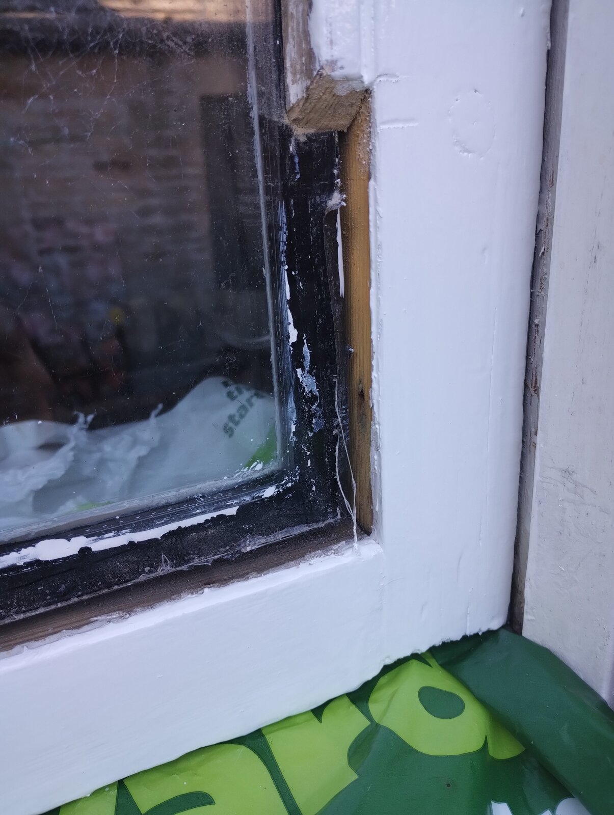

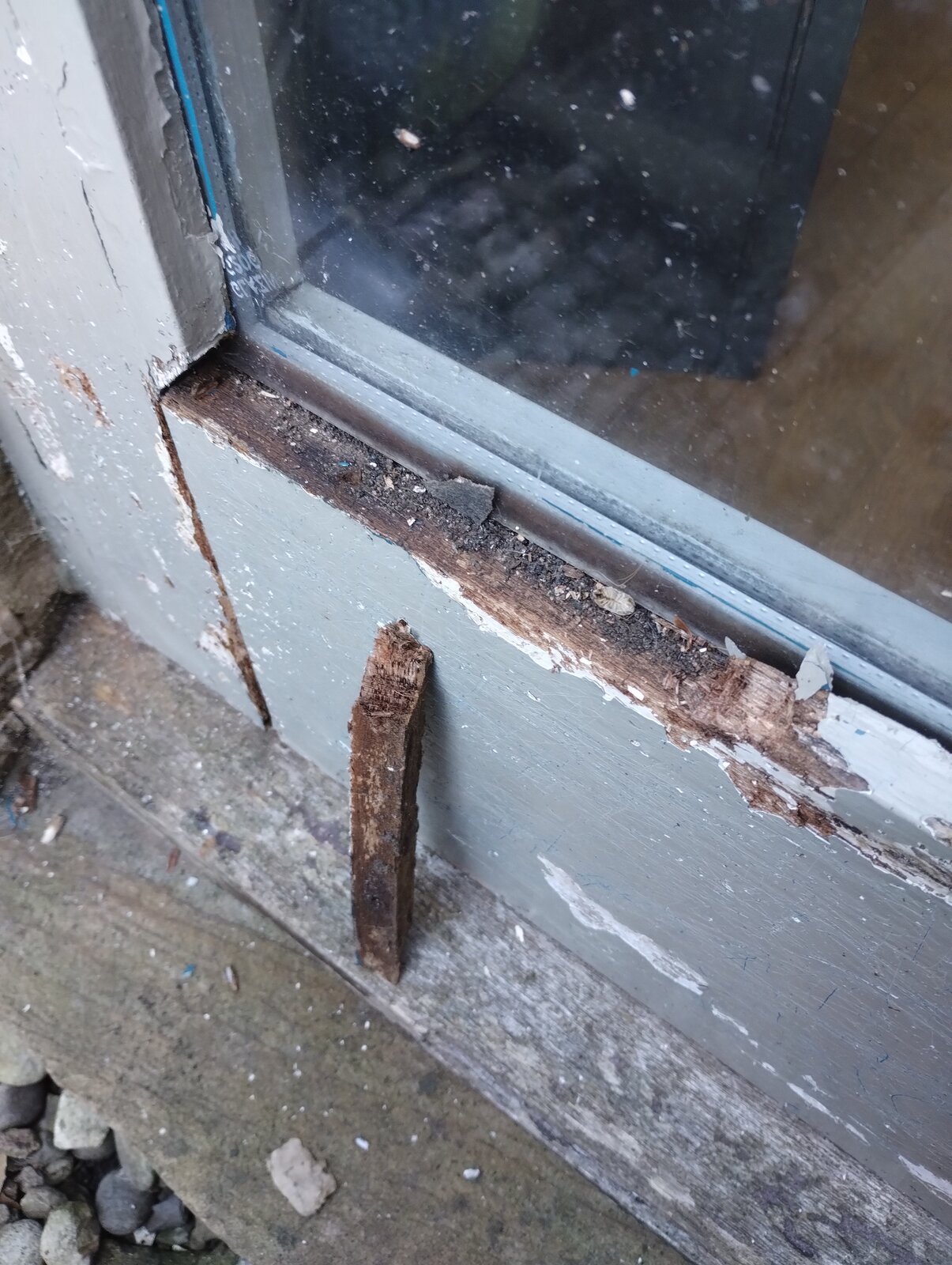

Hi
I've been working at friends house to try and fix up some modern(ish) doors/windows that are double glazed with the glass held in by wooden beads. What seems to have happened is that the beads are just no good (unlike putty windows) at keeping the water out. As a consequence, water seems to have soaked down into the wood below, worst on the door which has totally rotted out and is basically scrap although I will probably bodge it up for now. Have to say unlike traditional putty this system seems useless !
My plan for now is to devise some sort of system to set the bottom bead in some type of mastic to completely seal it, leaving some little drain holes above so water running down can run off doesn't get trapped.
Any thoughts from those who have dealt with similar problems I'm very interested to hear.

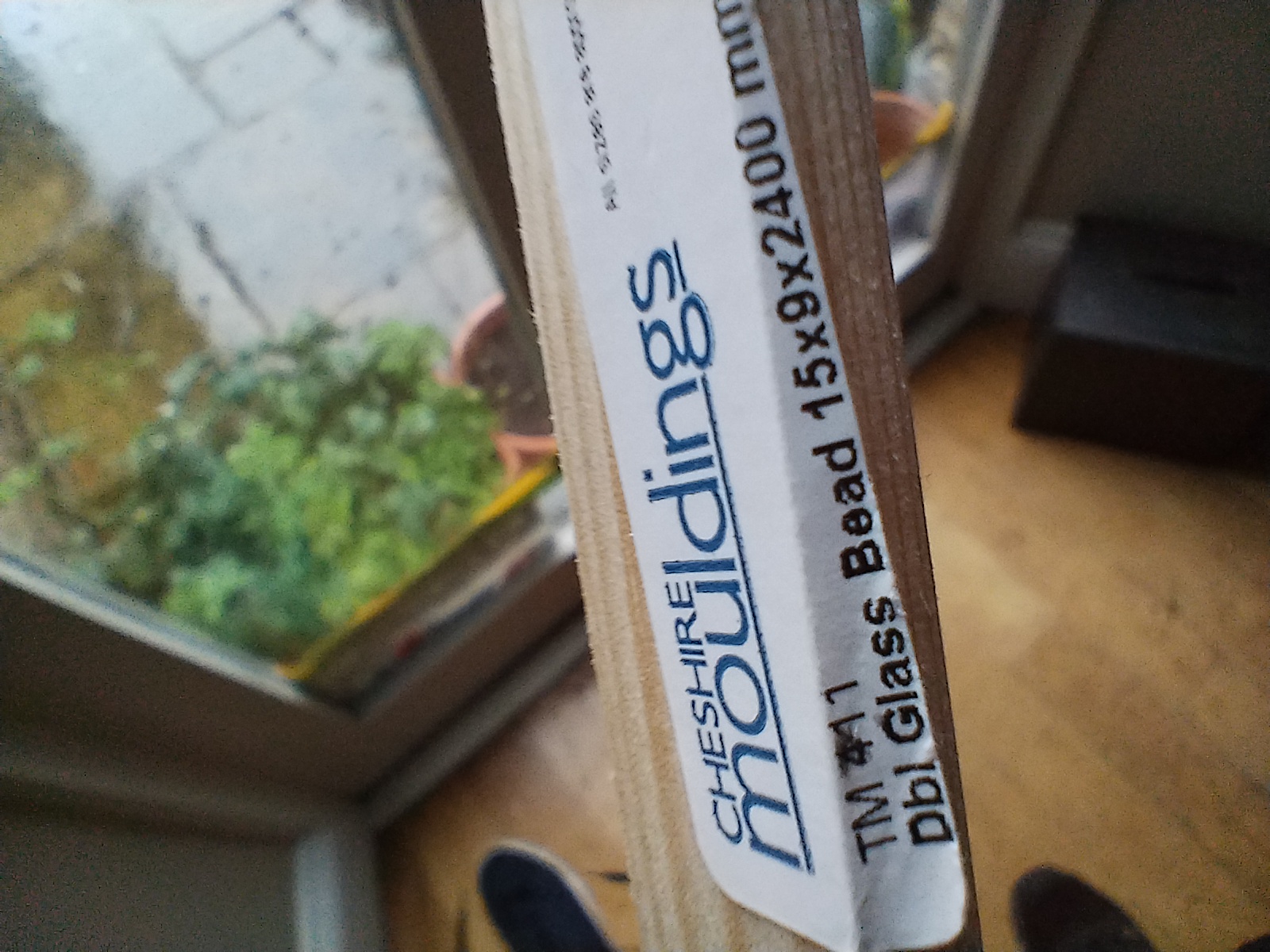

I picked up on the offchance some window bead in Wickes ('Cheshire Mouldings') which is almost correct for the window, it's just too deep. I could (but don't fancy) cutting it down lengthways but if anyone knows a good stockist of these profiles I'd be interested to hear.
Thankyou !

There are several potential causes for this.
someone skimped on the sealant when the windows were glazed
Beads not 'capped 'once glazed
Rebates werent treated before glazing
maintenance ( eg painting and staining )on the windows/doors wasn't kept up
Putty dries out and cracks , letting water in , I'll tell you now NO manufacturer of sealed units will warranty any unit put in with putty in today's market, in fact less and less warranty into wood at all due to the above reasons I mention
Looking at the pics , at least 2 of my reasons above are very valid!

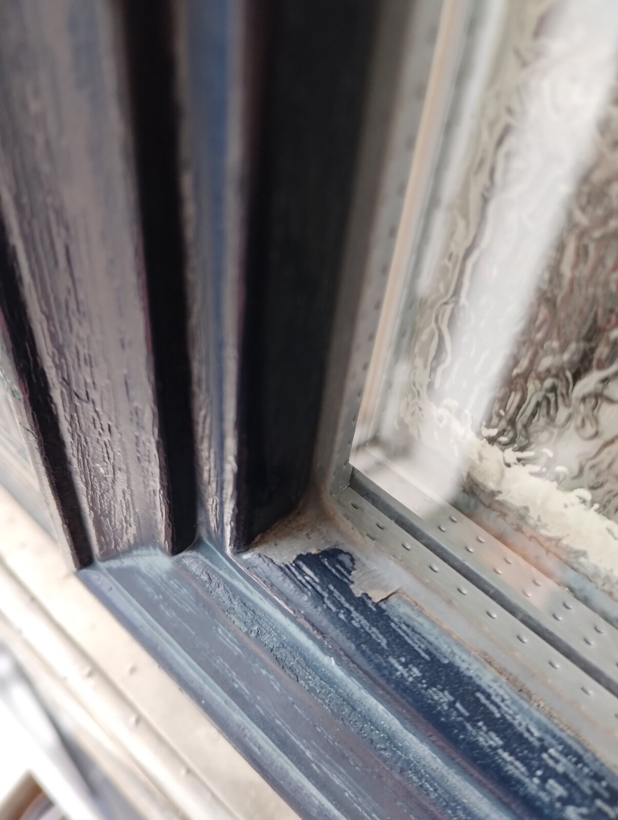

With the sealant, well there isn't any! But then I noticed - my front door, which is a 'composite' type. The trim/beading seems to be actually bedded in sealant (pic attached) - is that more what should have been done? But then I've seen some people say this is counter-productive because it could actually trap the water - I guess it's OK if done all the way round. And all sides are sealed.

Unless the bottom bead has packers and allow drainage then the recognised way of fitting the glass would.have been to fill the void around the sealed unit with a clear Low Modulus Neural cure silicone, thus not allowing any water to get to the seal of the unit, this would protect the sealed unit ( note you do need to use a glazing packer to keep the glass from the wood.
Prior to fitting the rebate and non visible surfaces of the beads should have been either treated ,primed or sealed , paint, varnish, sealer .. whatever your wish to use
There is some debate as to the effectiveness of using a glazing tape tonfix the sealed unit in the rebate and on the beads prior to fitting ( the face of the rebate , not the gap created) . I have seen silicone and tape used , both lasting a long time also both failing quickly.
Do not have sealed units that are taped on their edges , the tape can hold any more moisture.
Once the beads are nailed/pinned in , then I usually run thin bead of silicone around where the external beads touch the glass ... this is 'capping '
The lack of maintenance would have meant the beads/frames were probably letting water in anyway.
Ive not written that in the right order really but think you get the gist of it .
Basically make sure frame /beads are prepared correctly
Fit glass and fill void
Fit beads
Cap beads
Keep on top of restaining/painting , any pins working loose and the silicone capping ( glass and wood contract and expand at different rates so gaps can appear and just need resealing )

We think the windows/doors are most likely late 1990's, possibly early 2000's at latest. With the window (white) its mainly just the bead that has rotted. As you can see, the underlying frame wood is *mostly* OK although it is a bit rough right at the bottom edge but I'll most likely just patch that in with a bit of white hybrid. Don't know if this was caused by water getting under the bottom bead or just running down the outside and under the edge.
With the doors, I need to have a bit of a closer look at some less damaged bits, but it seems all they've done once the DG unit is in is just put wood beading round to finish it. I don't see much evidence of silicone, drainage provision or anything described above. You'll see there's a gap between the DG unit and the vertical bead allowing water in. However it's all a bit of a moot point - the door frames are basically rotten at the bottom and will ultimately have to be replaced but I'll probably end up patching them up in the meantime, so will attempt some basic measures on the principles given to protect any repairs I end up making.
