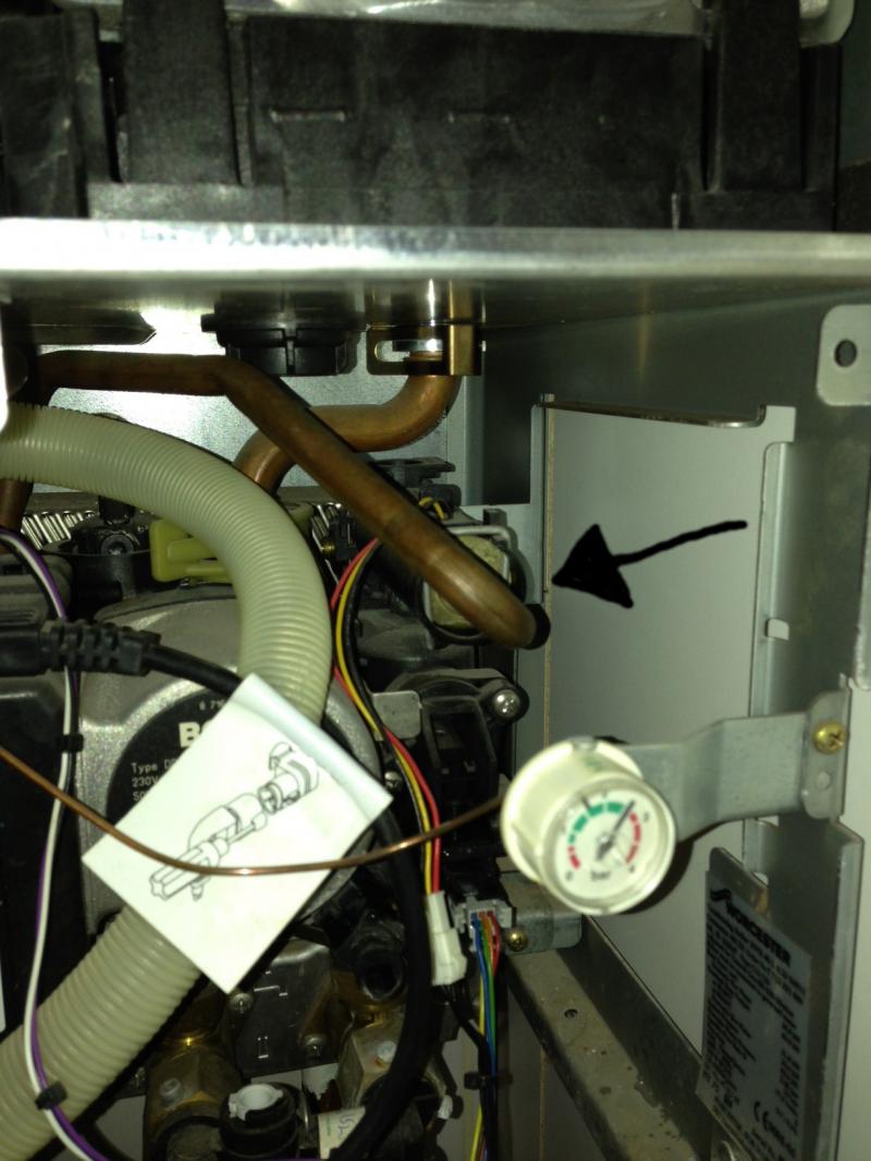

My Worcester 40 cdi boiler has started leaking for the past 2 days, a constant drip drip leak, losing around 2 litres a day, the boiler pressure hasn't changed and the boiler is still functioning ok.
The leak is coming from the part labelled with an arrow on the photo. What is this and how easy is it to repair? Roughly how much should it cost to be repaired by a plumber?
Thanks for any help
A leak on the cold mains coming through the boiler as the pressure isn't changing.
An o-ring needs replacing.
Not a big job most decent engineers carry O ring kits cant really advise you on cost as every area is different but would certainly recommend that anything over £100 would be excessive
Could be any O rings around the flow turbine. You also need to get the vessel/pressure sorted out ASAP. The pressure is too high and you risk the safety valve opening which is £££££ to sort out.
Many thanks for the replies. The plumber who came around initially didn't carry the correct part, he tried some round part but it didn't fit correctly, I assume it was the O-ring, so he said he'd order it and come back. Failing that correcting the problem he said he may need to replace the whole "right hand block" - does that sound right?
See my post...thats what will be needed.
Its 99.9% certain that when he comes back and fits the new o ring it will still be leaking.
The leak is coming from further back.
You need this

The link from your first post didn't work. So I will just need the O-ring and that sensor adaptor as on the ebay link? Is that ebay part correct for my model or do I need to find a specific one?
