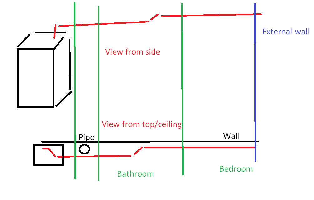

As for the bends, I am not 100% sure how to count it. Overall, the direction of the flue is simple - up from the boiler, to the right all the way to the outside wall. However, within this roughly straight line there are some tiny bends, like zig-zags. It comes up from the boiler, 90deg bend to put it (almost) horizontally (does this 90 count?), then it makes a tiny zig-zag so basically the flue is positioned still in the same direction, just slightly away from the wall, parallel to where it came out of the boiler, then a bit further down it has a triple tiny zig-zag (going back towards the wall and tiny bit up...), and then it continues straight all the way out. I was completely unaware of these zigzags until the second and third engineers who came noted them. I think the reason for the some of them it is that after coming out from the boiler room, before it reaches the bathroom, it goes through a "shaft" with various pipes and there is a massive pipe going from the floors above to floors below right next to wall (global water supply? waste? No idea what runs in it). So to avoid it, he took the flue away from the wall and then back towards the wall... I'm not sure why he did an up-zigzag as well (rather than just running the pipe on an angle). If I count the actual "bend parts" I think it's 3 of them - 1 for the "move away from the wall" next to boiler, and 2 for the zig-zag in the bathroom. I think all of them are 45deg.
I find it quite hard to describe, tried to put up a diagram, not to scale ;), green lines are walls between rooms. Not sure if it helps, I'm not particularly talented in arts.

If you side view is correct then there is sufficient height to obtain the maker's recommended flue slope.
The slope is solely to enable water inside to run back to the boiler. They select a slope which is reasonable for the purpose. That has to be a uniform slope all the way.
