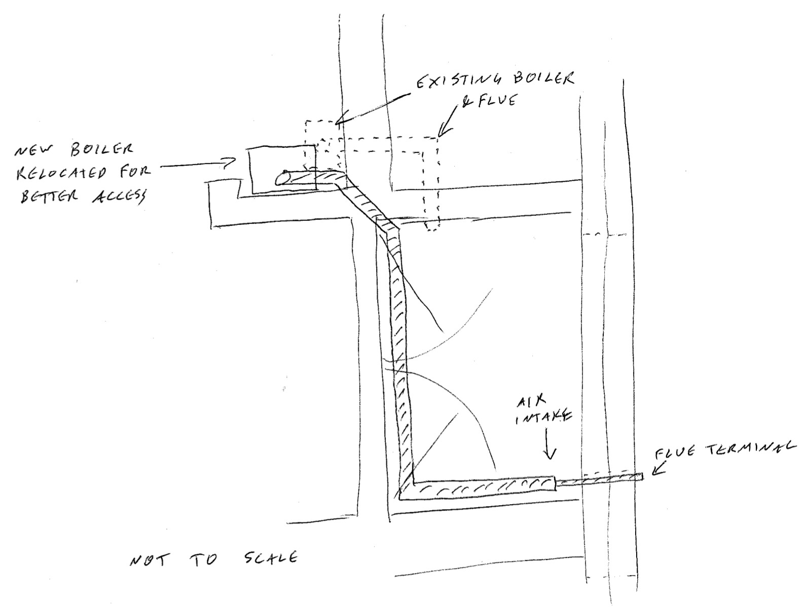

Now, I did come up with a cunning plan.
There is a concrete lintel over the garage door, so can't come through that. But I could core out a hole at 45˚ that would just miss the end of it, and get me between the space in front of the garage door, and inside the garage. I'd also need to consult a structural engineer about the next bit - but the RSJs are "very oversized" (I think the builders simply found them cheap - they were obviously second hand). Since no-one does an intermediate drain point, I can't drop the flue down to come under the beams, so that means cutting a hole through. My plan was to terminate the twin-flue in the recessed area, and just bring the inner pipe through the beams (thus a smaller hole) using plume diversion/balcony kit parts.
But then the engineer throws in a completely unexpected twist. He was reading from the Baxi book, and said that the twin-flue pipes aren't allowed to go outside other than the short section of terminal. And that it has to be seated "square on" to a wall - so the idea of coming out of the garage at 45˚ is scuppered. He then added that (IIRC) Vaillant do allow their flues to go outside - but don't have balcony kits (presumably because they aren't needed.

I'm pretty certain it could be done (possibly without cutting the steel, I reckon I could get a 50mm pipe over the top) with a Keston and 50mm uPVC piping, but their smallest model is "a bit big" and the price tag reassuringly expensive.

Any thoughts on the limitations my engineers have given, I did a bit of a sketch which might help :
They've told me it can't be done as drawn as the twin-wall is "inside only" apart from the end of the terminal pipe. Can't end the air intake where the second 45˚ bend is as they say the terminal has to come straight through the wall so the seal can sit flat on the wall. And they said a different manufacturer allows the twin-wall to be outside, but doesn't have a balcony kit as presumably for a balcony it wouldn't be needed.
Would be so much easier if we could step the pipe down to go under the beams - but of course no-one has an intermediate drain point option that would be needed.
