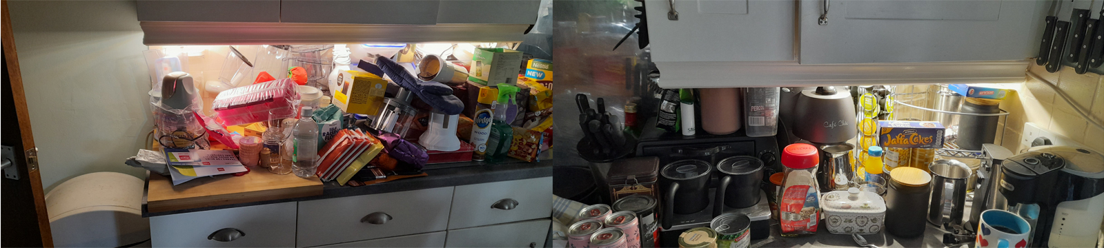

My kitchen counters extend either side of the cooker, the light to the right under the cupboards failed first, and a LED lamp was used to replace it, the light to left failed latter and a lighting strip was used.
With an empty work top you can hardly see the difference, but once you get all my wife's clutter, (hope she never sees this) the spread with the strip lights is clearly better to left than the concentrated single lamp to the right, however since my wife only uses it as a storage area, both lamps are wasted. It seems it is on her to do list.
But distance to object to be illuminated and spread of light is important, as is if the light itself causes a distraction, or causes the eye to reduce light input, if I had switched on the cooker hood lights then the dark area would have been as bright as the rest, however now I have seen the Jaffa Cakes I need to return and remove/digest them!
