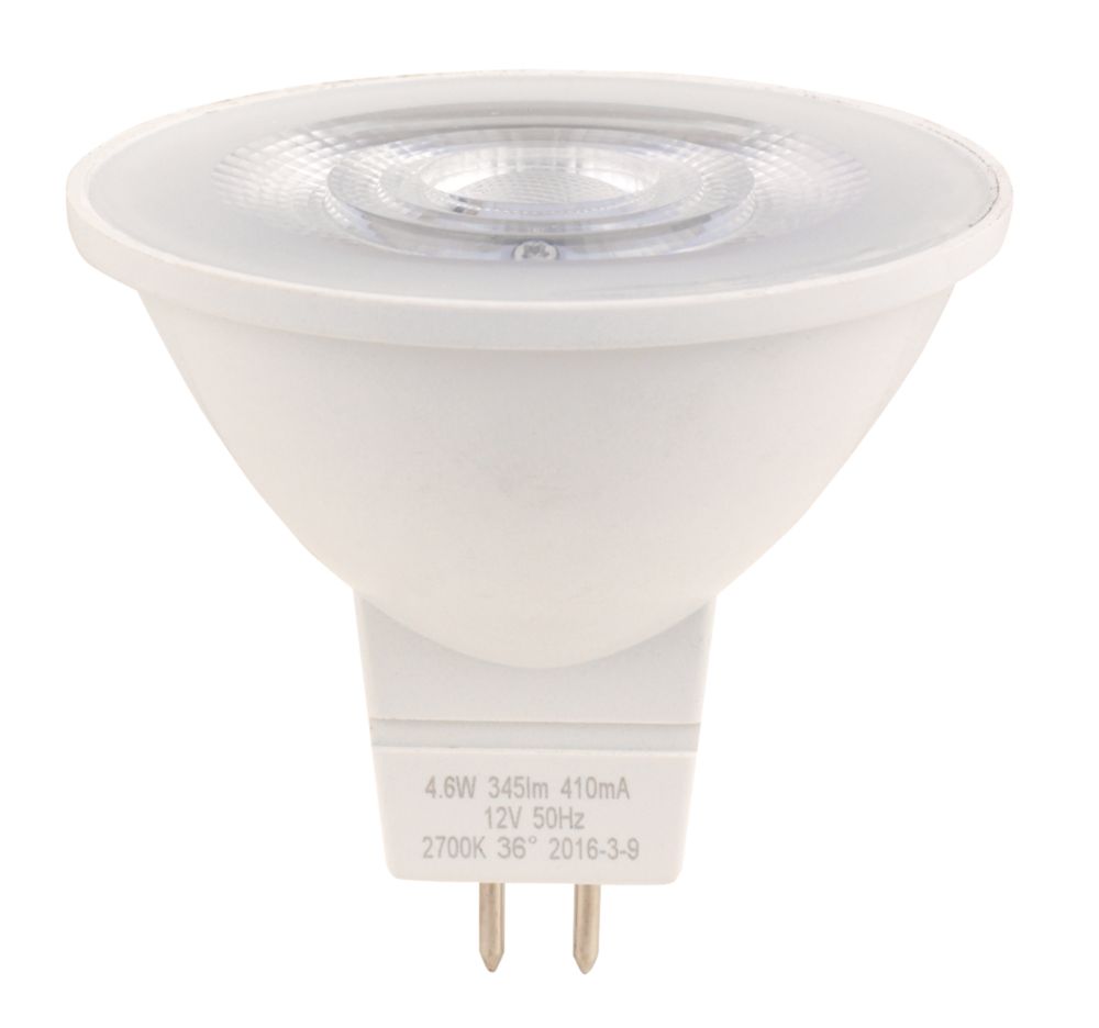

This type of transformer does not care if one lamp or 10 lamps, it does not matter if the extra low voltage cables are 2 meters long or 20 meters long, you can replace the quartz for LED without changing anything else,
ae235
the bulb show is clearly marked 12 volt 50 Hz and will work with the transformer shown without a problem.
There are other combinations that will work, it is simply a case of reading what is marked on them. However this is the advert for the bulb shown and the point is reading the advert no where does it say AC or 50 Hz only looking at the picture can you see it is clearly marked 50 Hz. This is the problem with G5.3 MR16 bulbs it does not say in the advert AC.
It is the same with power supplies often you have to find and down load the spec sheet before you find 2 meter limit on extra low voltage cable length and 43 kHz output frequency.
The power supply linked to clearly states DC so you also need a bulb designed for DC to work with it, not one marked 50 Hz.

My problem with 12 volt MR16 lamps is we are only guessing about what is inside the lamp. This advert for a 3 watt lamp states:-
  • MR16 (GU5.3) Halogen replacement LED bulb
  • 3 x 1W High Brightness LEDs
  • Lumens: 160L (Warm White) or 180L (Cool White)
  • Colour Temperature: 3000K WW or 6000K CW
  • Wattage: 3W
  • Voltage: 10v – 30v DC
  • Current draw (at 12.7v): 250ma (0.25A)
  • Approximate Equivalent to 25W Halogen bulb
It says without any problem it is DC and the voltage 10 - 30 so very likely a pulse width modulated unit built in to drive the LEDs, however this is unusual most seem to have a very vague description with 50 Hz printed on the side clearly are AC but we as the user have no idea if that marking is so we will not use it on 47 kHz supplies because it may cause interference, is it so we will not use it on supplies with a minimum output, or is it because it uses a capacitor as a current limiting device and will only work correctly with 50 Hz?

There to me is the problem, there is no one GU5.3 MR16 lamp or power supply. They need to match each other and all we can really do is read the spec, the whole idea of dismantling a lamp to see how it's made I see as flawed, if it says 50 Hz we need to give it 50 Hz we can't assume it will also work with DC or 47 kHz.
