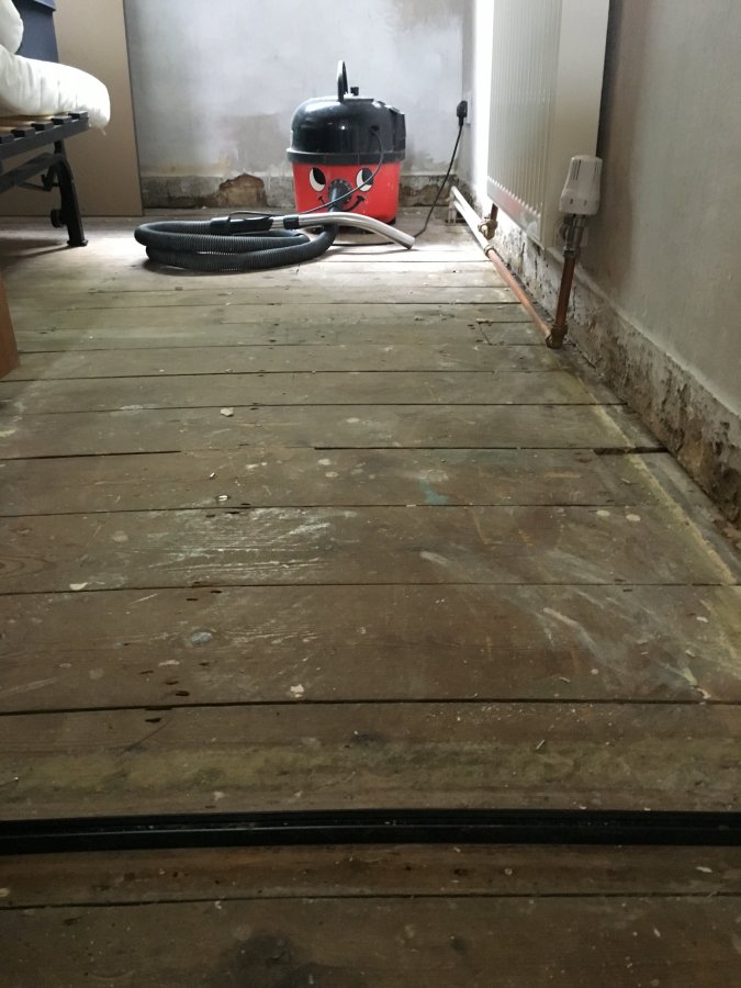

The floor in one of my bedrooms has a significant hump to it. It can be seen in the centre of this photo.
I considered cutting the floorboards along the wall but I suspect that the internal block wall to the right is actually just resting on them. Not quite sure how to proceed.
You can see where the josts run, the cuts and the nails will show you, cut out a section or lift any which are already cut and see what's making the boards do that.
