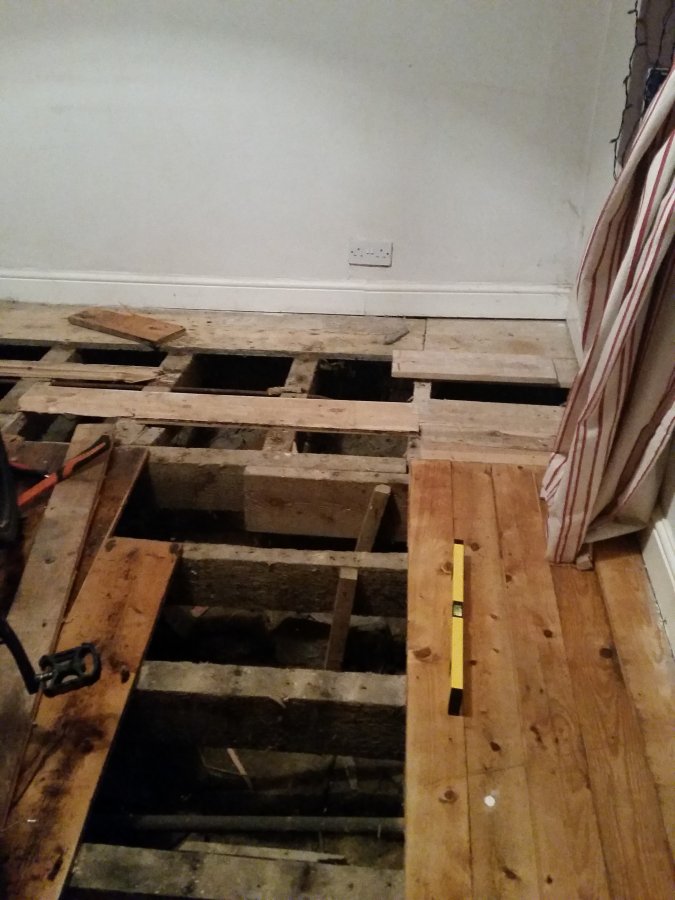

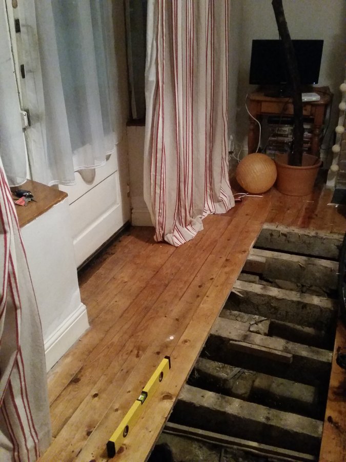

Pics attached - thanks for your help, out my depth somewhat with this one!!

Ok, its a case of the floor has been repaired before.
Or attempts have been made to, perhaps, do remedial repairs due, I suspect, to rotting joist tails in the wall pockets.
I also suspect that joists tails have been cut off and incorrectly mended instead of having bolt-on's.
Previous "repairs" have seriously weakened the floor.
The floor in pic 1. is it sloping to the monitor wall in the photo?
Is that wall an outside wall? Is there (or was there) a chimney breast on that wall?
Do the floor boards (in pic 1.) run to that wall without changing direction.
If you drop between the joists into the joist bay you could get closer to the joist pockets in the doorway wall and take photos of the pockets and the 2" x 4" repair lengths.
Is the dark stain at the door threshold water penetration?
In pic 2. the floor obviously changes direction - note the gap under the wonky skirting, and the supporting "posts" attempting to support the cut joist(s?).
Go under and photo the pockets as best you can.
The single joist supporting the short joists should be a doubled joist to take the weight.
All wood debris should be removed from the oversite.

Pic 1 shows floor sloping towards TV. This is an internal wall that contains chimney breast (to right of pic).
Floorboards run in same direction apart from the other side of the room in pic 2.
The different directions are because there used to be a corridor wall which was removed - the floor drops after the remains of this wall as shown in pic 2.
Dark under door is shadow not water.
I'll try and get some more pics
