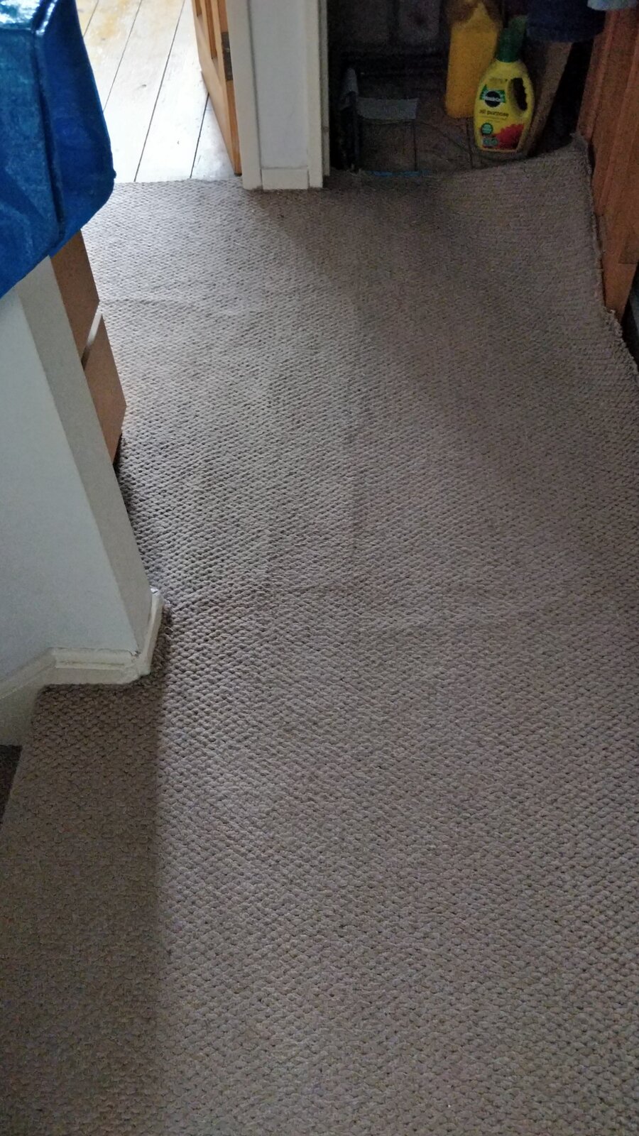

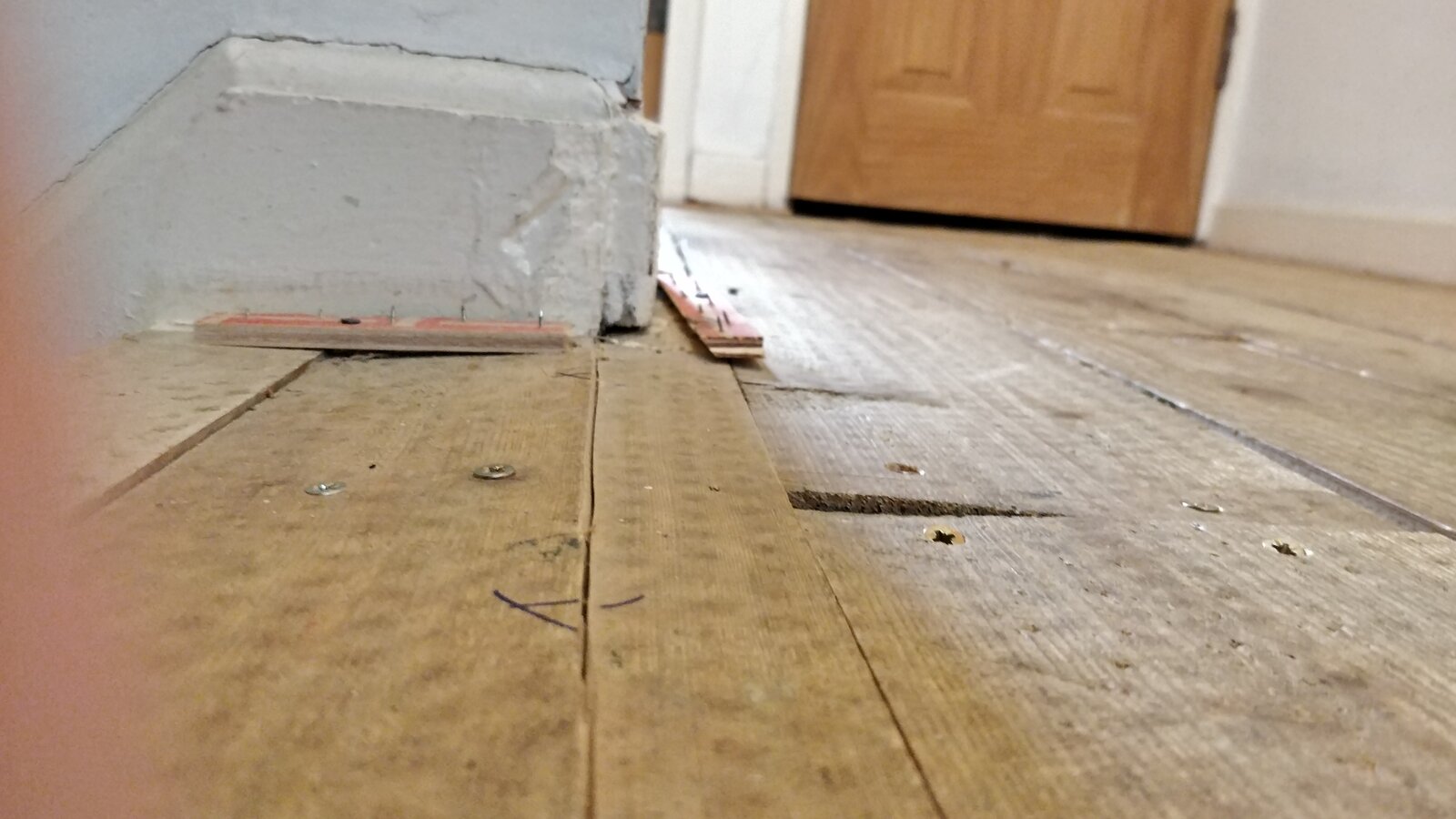

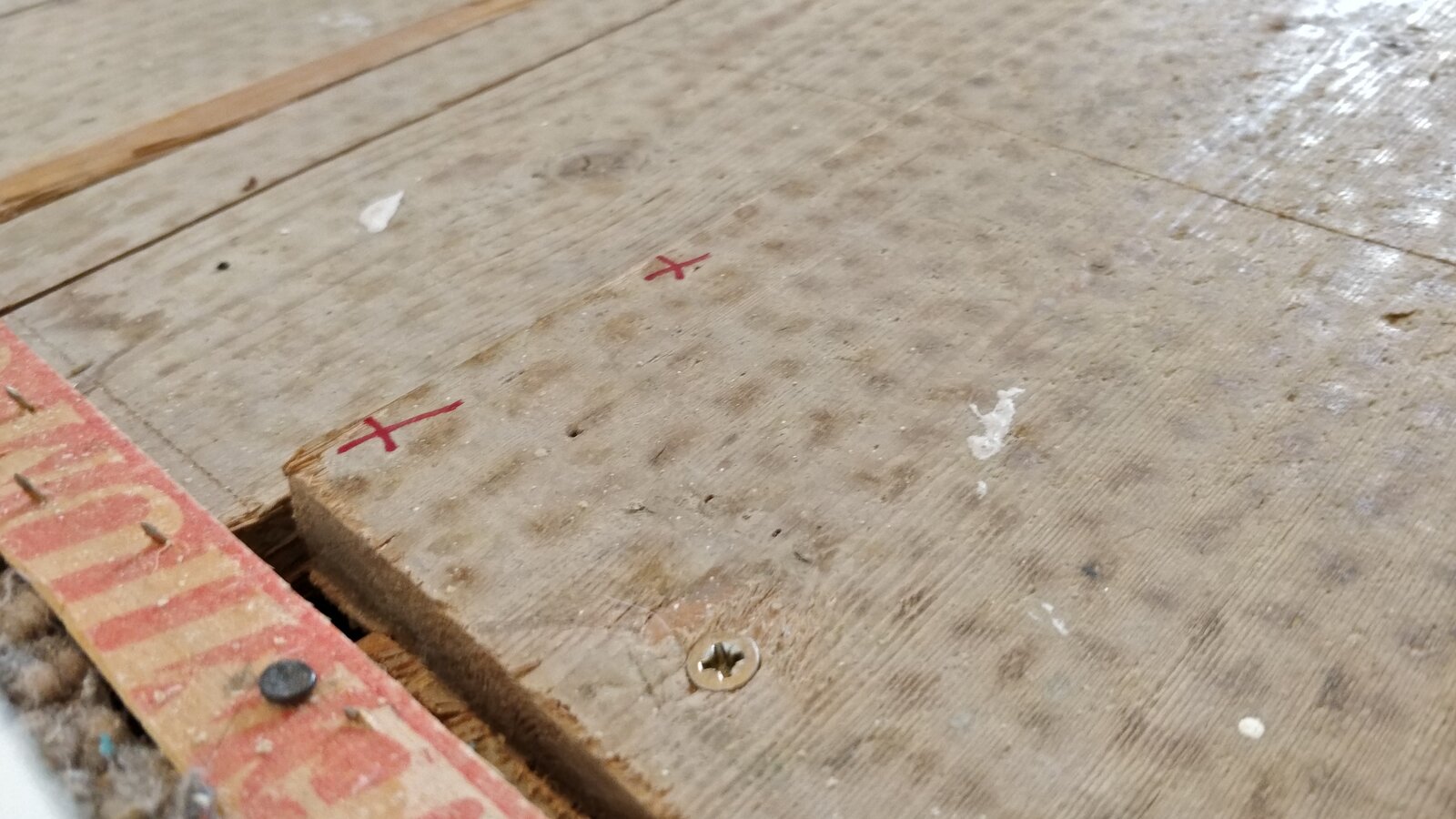

We took the carpet up as the floorboards underneath were squeaky and have screwed them in. and cut out some new underlay as the last one was flat as hell.

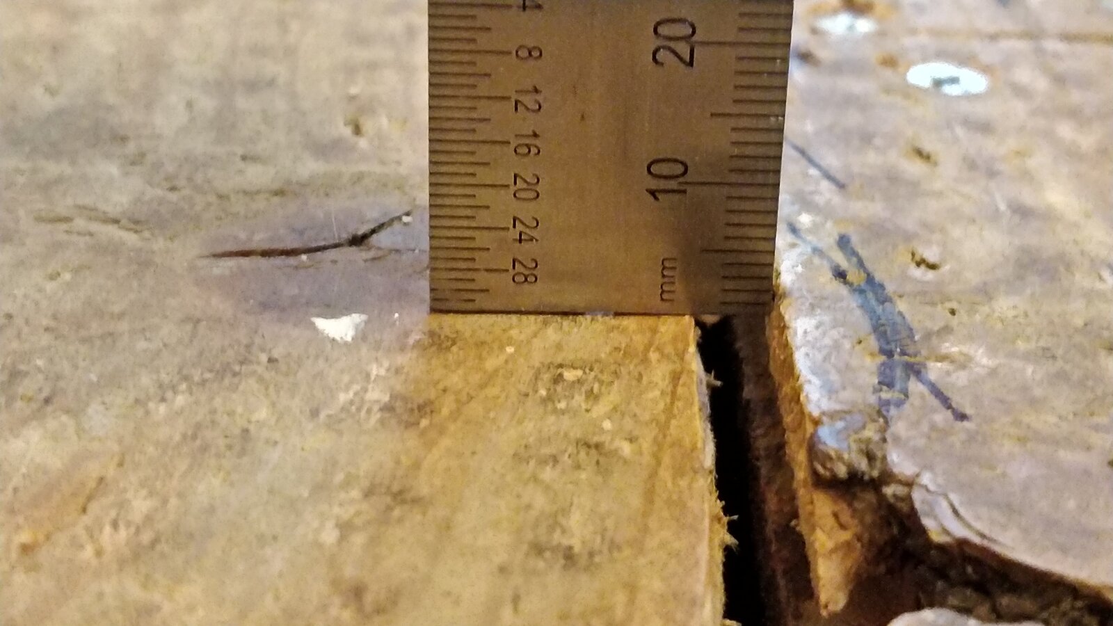

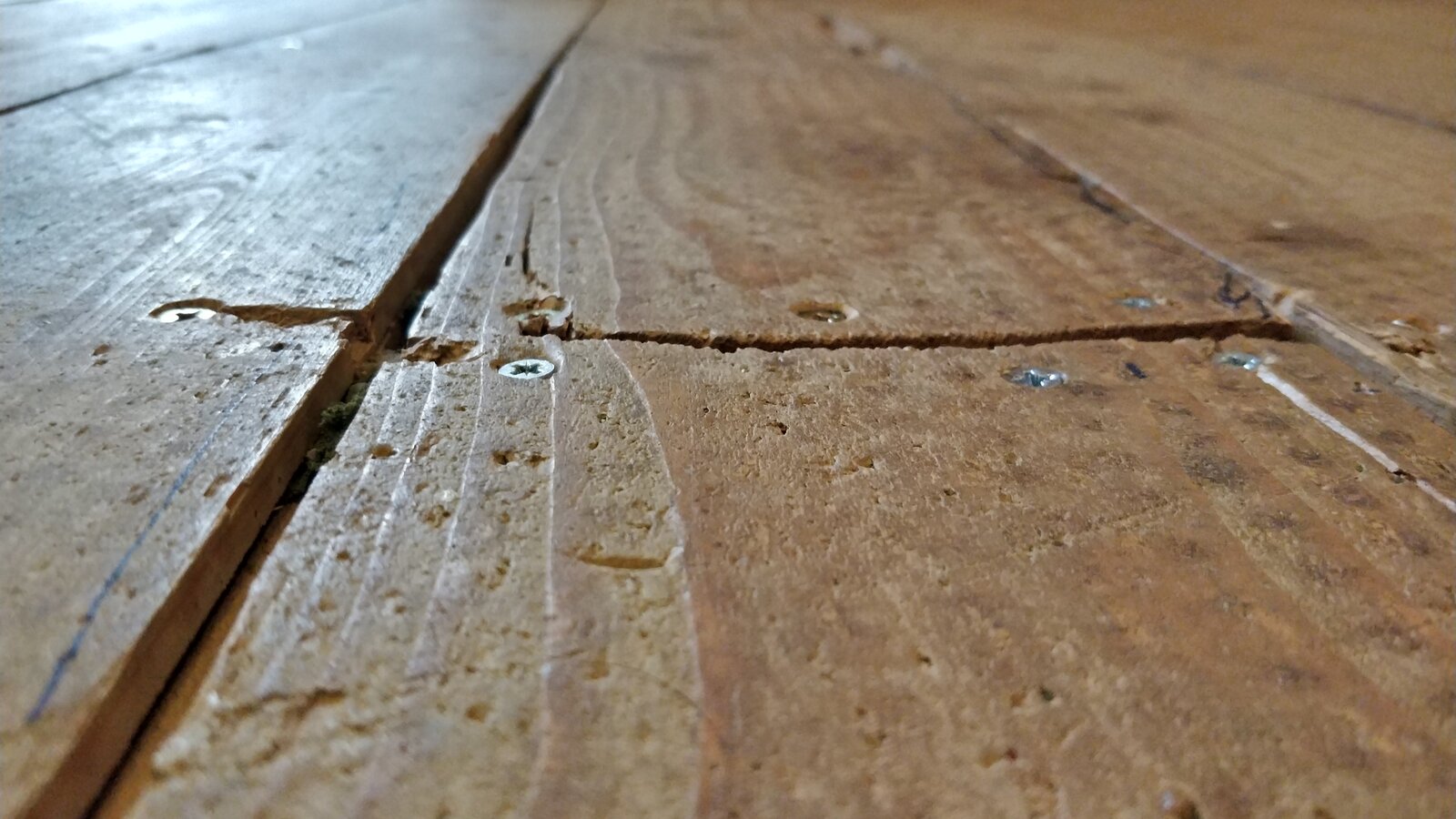

It is also noticeable that the boards are quite uneven in places.
Any easy suggestions on how to make it more even?
My partner suggested we use an electric planner on the most noticeable edges (with screws removed)
But can these types of planers be used on floor boards in situ? I've only ever used the planner on edges that are less than the planer width.
or is there a gap filler, and then cover with some sort of levelling compound/latex?
Any suggestions massively appreciated! Thanks

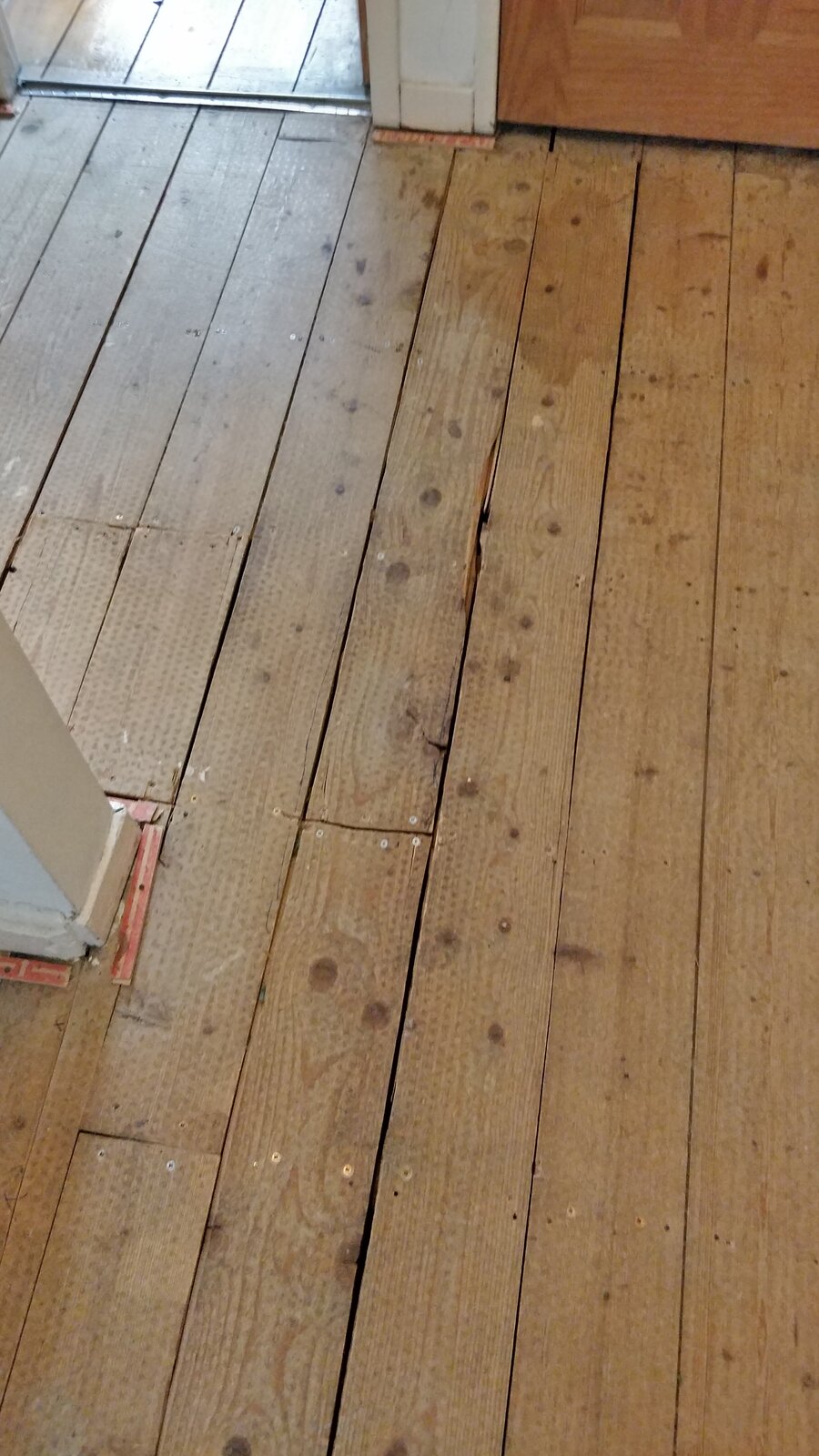

Unless floorboards need to be visible 12mm ply over the top, screwed at 100 to 150mm centres then self levelling compound as required

Lift the boards that are sitting low, pack underneath or repair the joists where they’ve no doubt been hacked to bits, and resecure.
i am with "JobAndKnock" Plywood !!

Pack underneath, rather than plane.
Then if you really do need to reduce the height of any sections of board, take it out of the back where it sits on the joist, rather than the face.

The boards have warped u shaped/ and diagonally etc in places so raising one bit to make that level, makes the other side even higher. I've looked underneath at some joists and there's metal in places so cant dig out but I think I can make some bits a tad better, but will still have to think about sanding/planning the extra high bits (if i go down that route)
Well, believe it or not, laying plywood is generally a lot cleaner and less work than sanding and planing, not to mention faster.
Plywood is the way ahead
Some of the areas of floor in the original images posted appear to be a "hallway?" subjected to high foot fall and as such no matter how much "fiddling" you do it will not match an overboard with ply

I'm suggesting to take material out of the back of the floorboard. Don't take anything off the joists.
