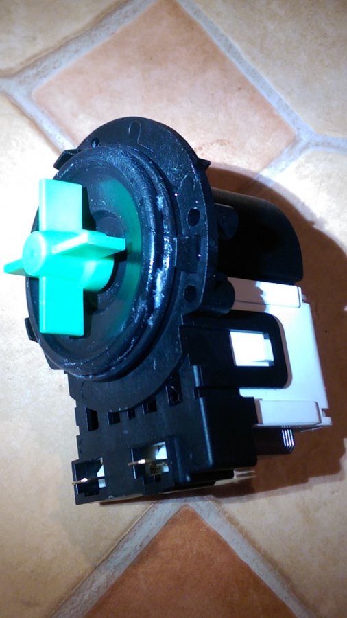

hi everyone
I have a noisy recirculating pump on my above washing machine (3yrs old), but I'm having trouble trying to find a replacement!
Anyone have an ideas where I could source one from?
Many thanks in advance
Gary.

I'm going to drag out the machine again to check that it's the right pump before I order. Getting a dab hand at this now as I've just replaced the door seal on it last week! Maybe it was the leaking door seal that has affected the re circulation pump? Who knows.
These machines have 2 pumps, one for the drain and one for the recirculating water. These are interchangeable I believe. I'm tempted to swop them around and see if the noise swops with it!
Thanks again, and I'll let you know how I get on.

Hi again Crystalclear
Quick update from tonight. Took out both motors and swopped them around as they were identical, and guess what? No noise from either motor! Going to see how it goes, the link you posted to eBay seems to be the same motor, albeit a different colour.
Photo of the "noisy" motor enclosed.
