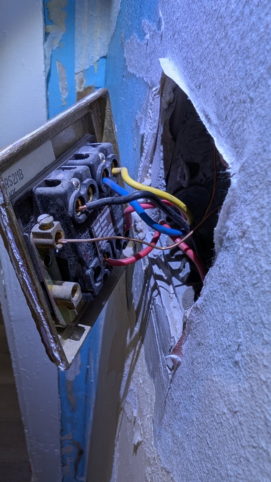

My hallway has 2 light switches. They are both 2 gang. One gang powers a wall light, the other gang should power a ceiling light. At the other end of the hall the other switch should power the ceiling light and the other gang an outside light.
Since I've moved into the house the ceiling light has never worked and there doesn't seem to be any power going too it. This is a couple of pictures of the wiring in the switches so hopefully someone could say if they see a problem. Can switches develop faults? If there was a problem with the ceiling fitting then would power still get to it. I think I'm going to have to get an electrician in but having a general idea about the problem would be good to know.

So left switch is on/off, and right switch two-way, but after that you need to test, since I see no neutral wire, it would seem the house is wired ceiling rose to ceiling rose, with droppers to the switch, and since only one wire in the S1 and S2 of the two-way switch the one shown is the slave.
So power goes to the light, then from light to switch one, then switch one to switch two, and you are showing switch two.
But you need some sort of meter or tester to go any further.

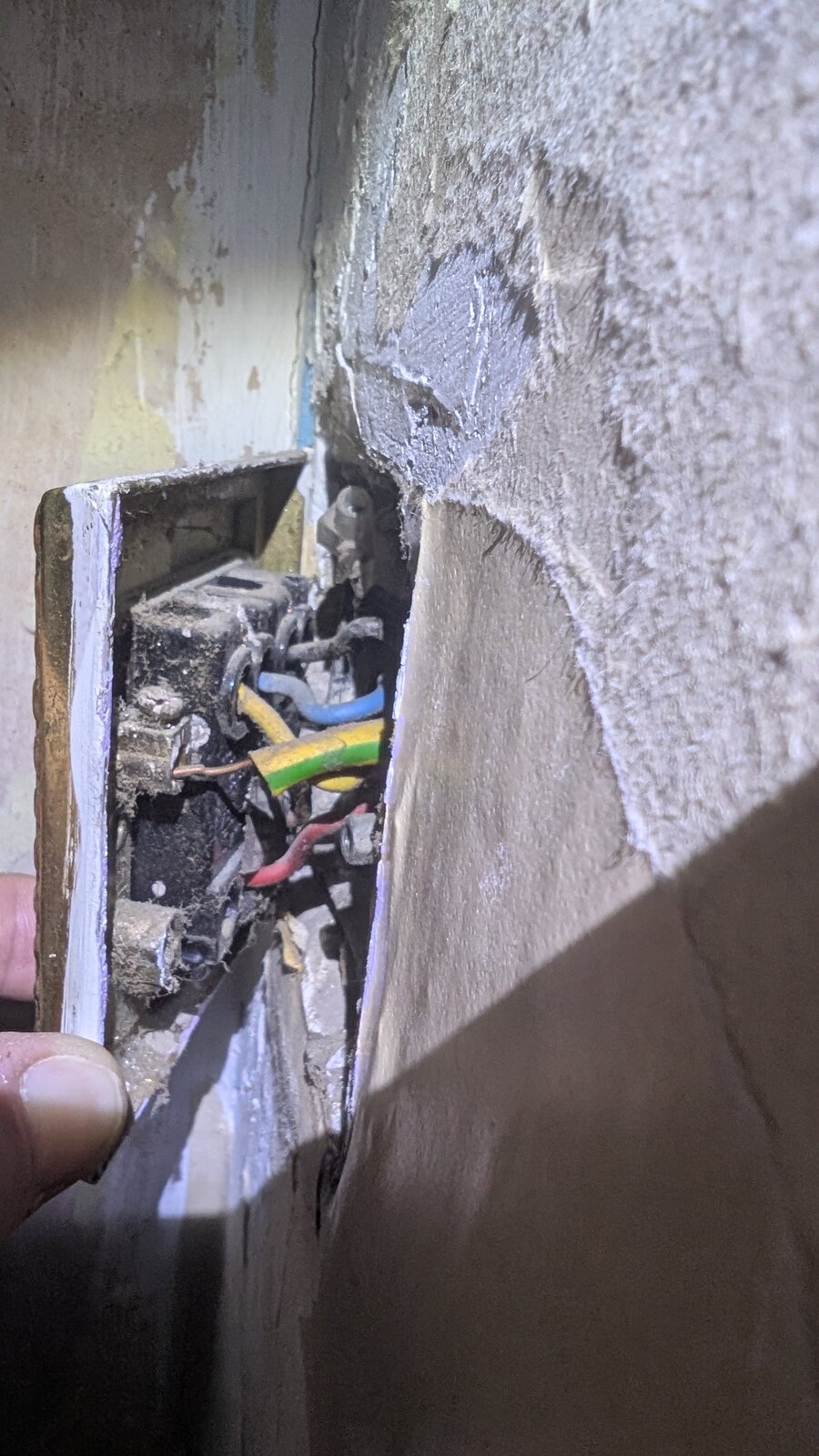

is this 2 photos of the same switch ?

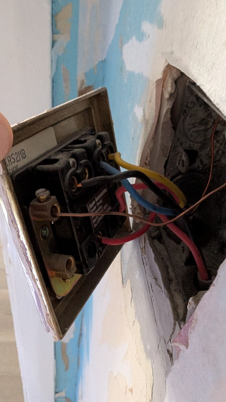

No, the first picture is the switch that does wall light + ceiling light. 2nd picture is the switch for exterior light + ceiling light.
Apologies, just noticed that too . This is the second switch but I can't pull it out as much as the other one.

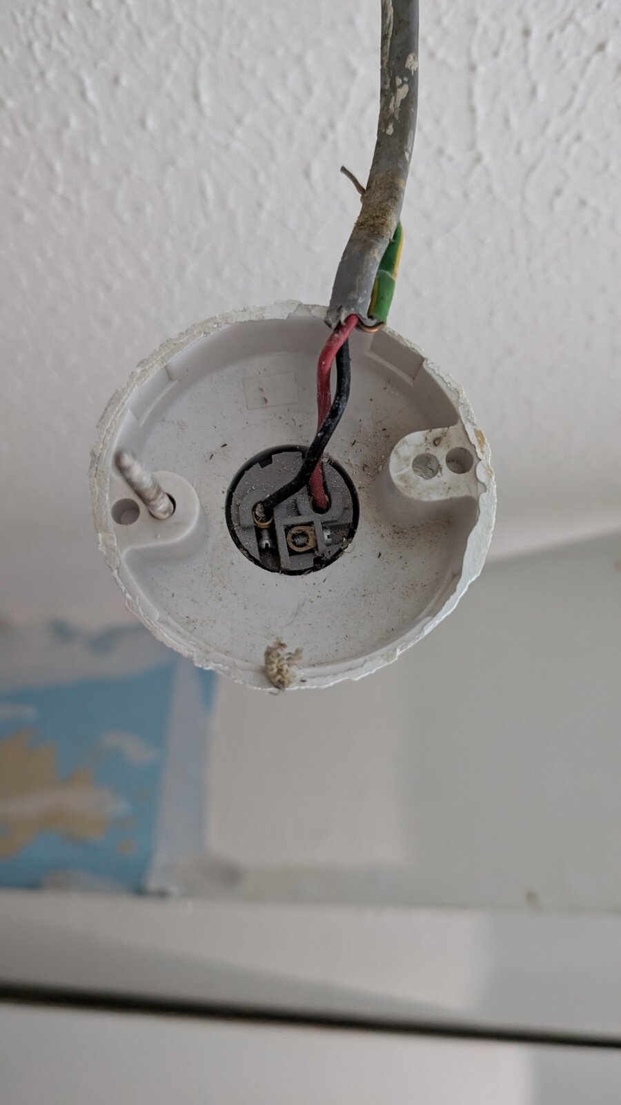

You say that there doesnt seem to be any power getting to it, but have you been able to test that?
Could you post a picture of the wiring going to the ceiling light?
Here is the ceiling light. I've only tested it using a light up voltage detector.

There appears to be a cable with red, blue and yellow wires into each ceiling light switch.
In a typical two way lighting circuit, this cable would link together the two switches; there would then be an additional cable running from one switch to the ceiling rose and loop wiring.
This extra cable isn't visible.
Alternatively, the cables could link into a junction box somewhere, and given the photo of your ceiling light, an additional junction box seems likely.

You do have a junction box based on the amount of wires in the ceiling light.
Doesn't prove if the voltage isn't present.
Have you tried another light?
