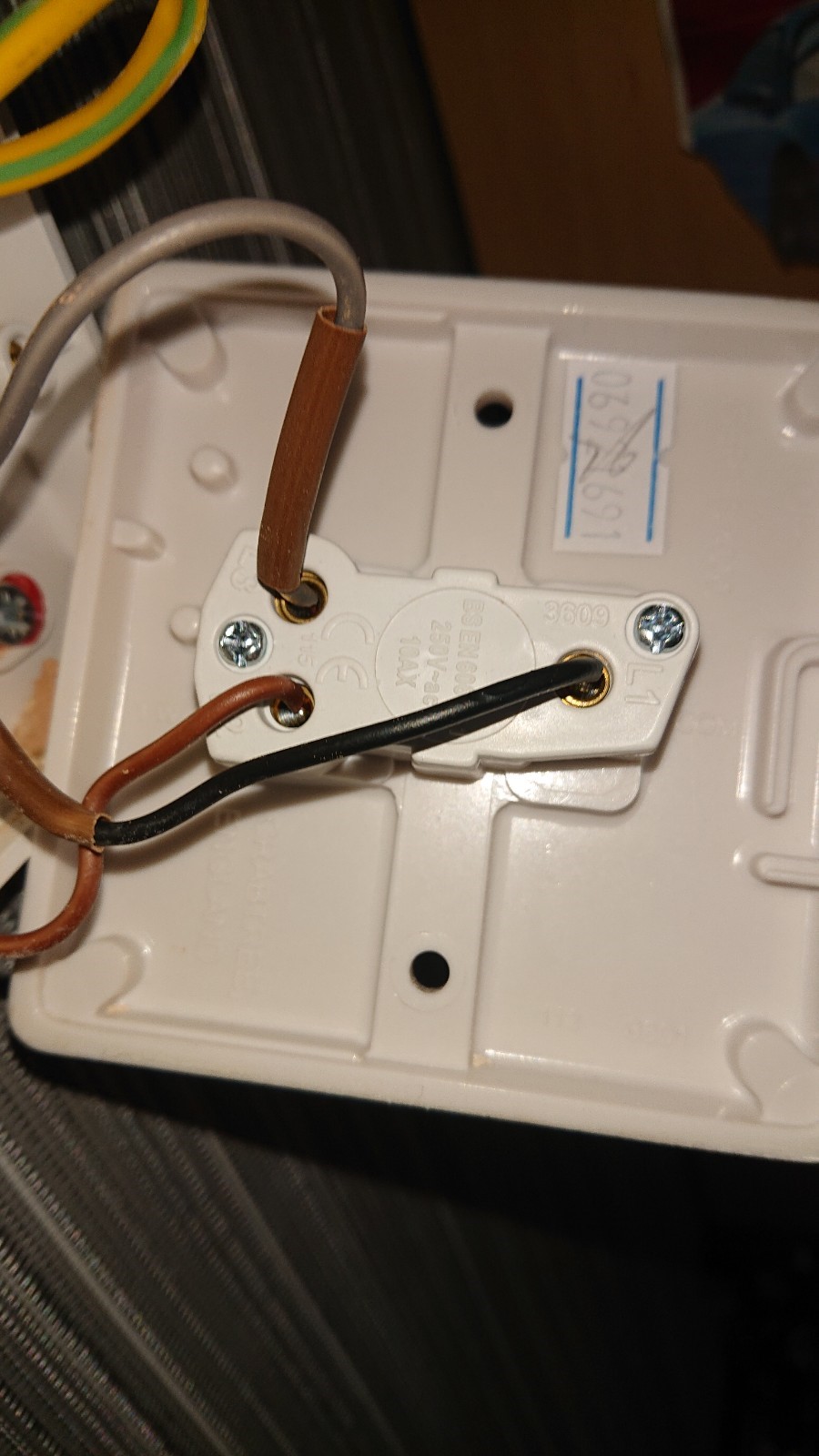

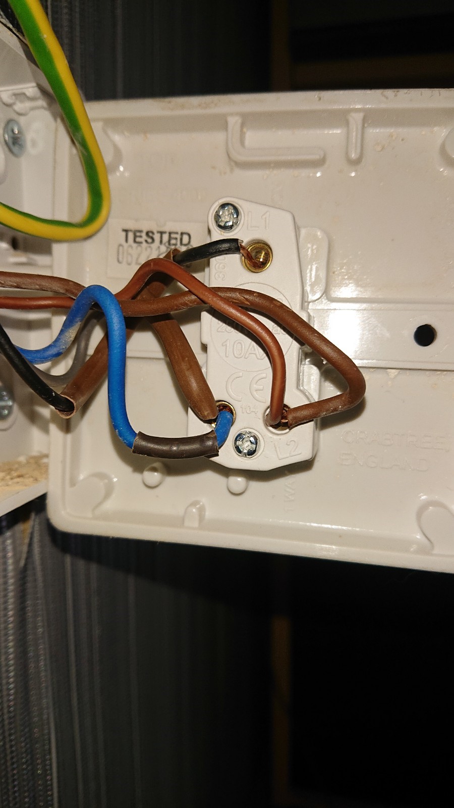

i have a two way switch 3 cable - grey, black and brown
connected to a switch which has L1, L2, L3

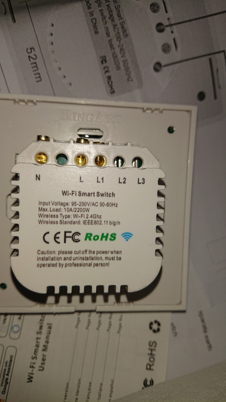

I'm trying to fit a Wi-Fi switch which has L,N, AND L1....
i need some help as i have never come across a switch with L,N AND L1 only
i dont want to wire up anything wrong...i don't think god wants me any time soon
i have added some pictures.
any help would be grateful

I don’t think you have neutral wires in light switch wiring. Well, I’ve never seen one, just live, switched live and earth. I’m not an electrician though!
I would have thought that a switch marked with negative would also be showing positive too. It’s gotta be neutral - I’m sure I’ve read elsewhere about people being unable to fit a WiFi light switch because there was no neutral present.
I have a two way switch 3 cable - grey, black and brown
One cable, three wires.
You cannot. You do not have a Neutral wire.
So, in effect, you only have L and L1 on the switch.
It needs a Neutral to make the wi-fi work. You do not have one.
