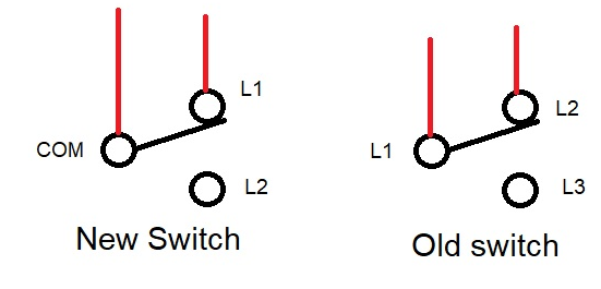

Attempting to replace an old light switch I was surprised to find it's wired up with just two red wires. For what it's worth I've labelled the wires as they were positioned in the old switch (L1 and L2).
I've no idea how to proceed with this. The switch I'd intended to put in has a L1 and a COM.
I have sealed the ends with choc blocks and sealed over the hole so no-one can come into contact with it. In the meantime I've no lighting in the kitchen. I can't put the old switch back on because it's shot at.
Would really appreciate help with how to resolve this.
All a switch does is to join two wires together. If there are two contacts labeled L1 and COM then just connect one wire to L1 and the other to COM.
There are two ways the terminals can be labelled

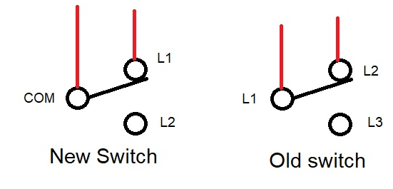

Thank you all very much. Job done. I'm grateful you gave me the confidence to tackle this.
