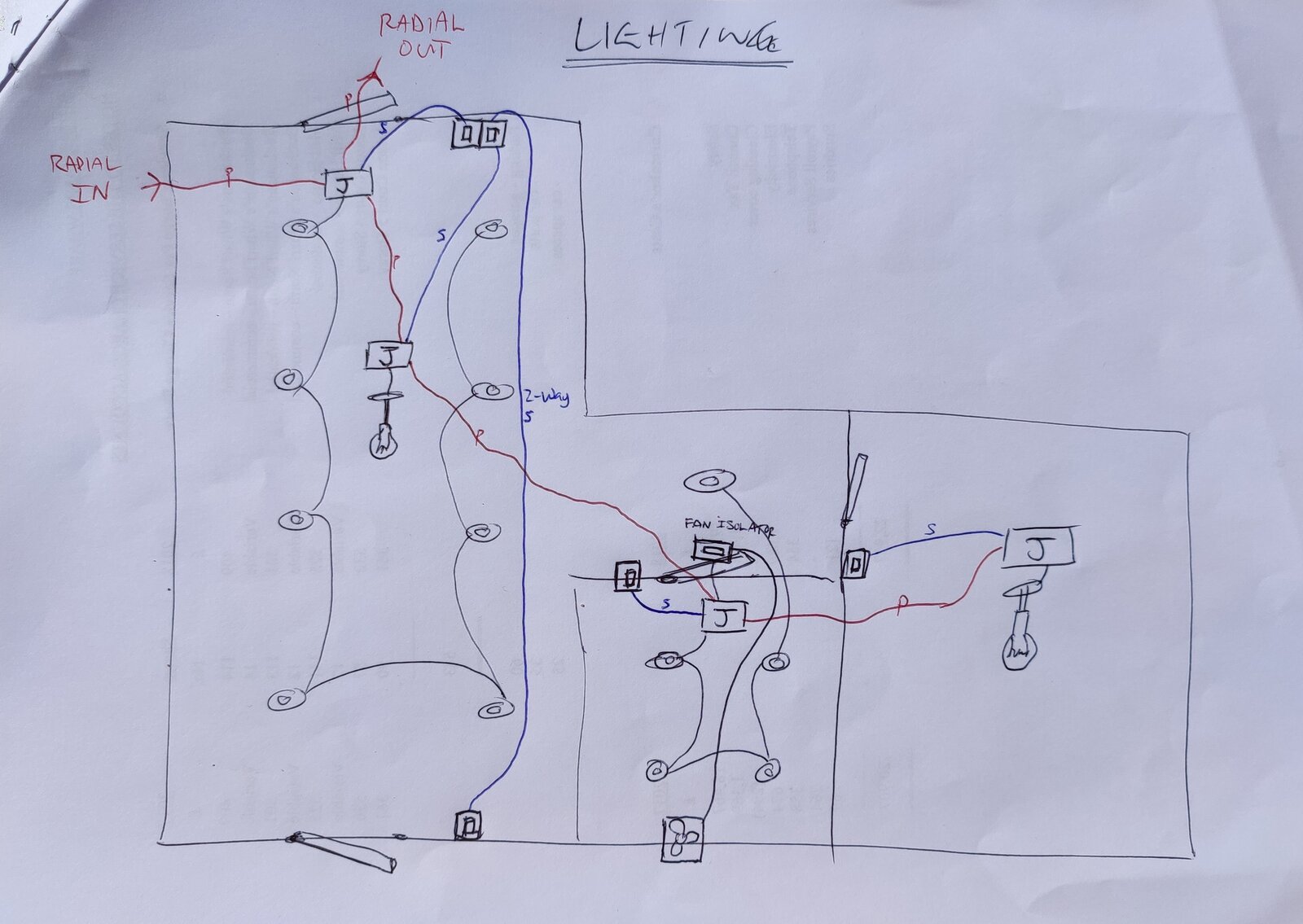

Hi folks,
I have a medium size split level 3 bedroom home and have just finished an extension which has increased the kitchen, added an extra study room and bathroom.
Question is, do I need to find the end of the 6A lighting radial circuit and extend from there, or can I spur off of the existing kitchen pendant? Does it make a difference? I know I should keep the wattage of the entire circuit below 1380W, but does it change if I spur off instead of extend the radial?
At the moment, I'm planning on running a spur from the existing kitchen pendant (closest power feed) to power 8 LED downlights in the kitchen, 4 LED downlights in the bathroom, 1 extractor fan, and 1 pendant light in the bedroom. Outline is attached, what are your thoughts? Thanks.

A spur applies to a ring final circuit only.
There is no concept of a spur on any other circuit, as the cables have a higher rating than the protective device.
The lighting circuit can be extended from any point, provided the same size cable is used and the total load doesn't exceed 6A.
Either; it doesn't matter.
Spurred would mean the lengths to the end of each branch would be less but not that important for lighting.
No, all the same.
It's a bit confusing but doesn't really matter as long as all done properly.
Try and avoid junction boxes if you can by spurring from the lights instead.

Thanks for the info!

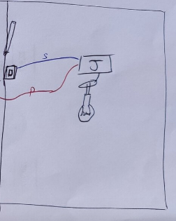

What do you mean by try to avoid using junction boxes by spurring from the lights? Where it says "J" in my diagram I plan to use Wago connectors in a Wago box, mount it and zip tie to to make a maintenance free "junction box". Is that not the correct way of doing it?
Connect your new cable in the light rose.
Why have you a junction box here?
It is the same in the big room and possibly in the other room.
It is correct for fitting junction boxes but if they are not necessary then do not use them.
For some reason DIYers love junction boxes.
Oh I see, so for the two light pendants just use a 4 terminal ceiling rose instead of a junction box, while for the other two downlight connections using a Wago box is fine?
To be honest I guess I just thought using a proper junction box was better practice but just using loop in ceiling rose for the pendants makes more sense
