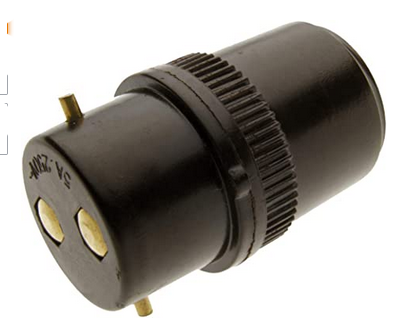

As said a BA22d lamp holder unless ceramic is only rated at 2 amp. But should be fuse built into bulb. And although you can still get these 1660410217236.pngwhich were common in the 50's to do the ironing with, one would hope you would not use one. So only with multi-lamps can 6 amp be exceeded.
