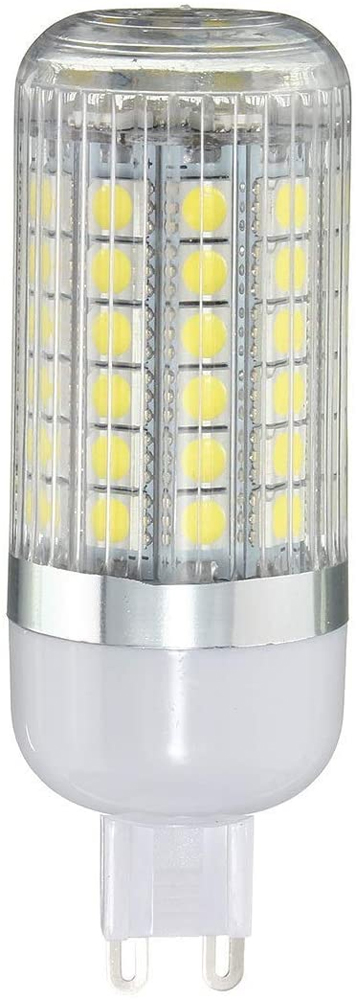

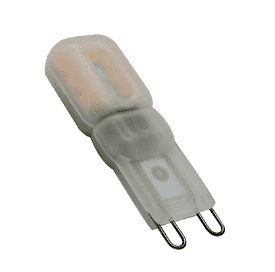

Both the smaller of these bulbs says suitable for dimmer switch G9-small.jpg G9-big.jpg the larger does not even give wattage or lumen output so breaks the EU rules, however the small bulb flashes when off with electronic switches and requires an external load capacitor and flickers when on, the large bulb works A1, the problem is with G9 lamps the old quartz required glass covers to catch the red hot bits should the bulb blow, and these covers will not fit on large bulb, so it changes the whole look of the chandelier they are fitted into.

That would be good, new lamp example 22019274 G9-69SMD-5730 AC:220-240V White written on the box, nothing written on the bulb, Other bulbs do have MiniSun M30 90G 240 V 50 Hz 3 W 300 lm 3000K and sign for dimmable. And yes hunt for MiniSun on internet does find adverts for nearly same bulb, however advert says not dimmable but bulb shows sign to say dim-able.
This is the whole problem with LED lamps, go to for example Screwfix website, look as GU10 bulbs, there is nothing to say leading, lagging, smoothed, with or without leak resistor all you get is Dimmable or non Dimmable.
You can work a little out from 22019274 G9-69SMD-5730 AC:220-240V it has 69 surface mounted 5730 diodes which are 150 mA @ 2.8-3.4 Volts so between 30 and 35 watt, well that's not right, some where between 4 and 12 watt is more like it. At 45 to 50 lumen so 3100 to 3450 lumen one starts to wonder if some one got the decimal point wrong? 3.5 watt at 310 lumen seems about right for a G9 bulb.
