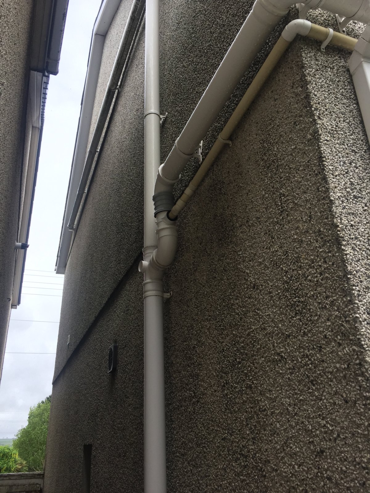

gasplumber, both properties in the picture belong to me. I dash rendered them both about 22 years ago.
the points I was trying to make earlier are in both houses.... the one on the left is all brick , I cement rendered it . theres no cracks and no internal damp.
the wall of the house on the right is circa 1895 and largely stone but every room on that wall has a fireplace. theres probably a 60/40 brick to stone ratio in that wall so i cement rendered that too. there’s no cracking , nothing has blown and there’s no damp internally. if the wall had been more stone i’d have lime rendered it.
just one more point, someone mentioned that mortar joins allow moisture out and allow walls to breathe ,that’s not wholly correct , given the right circumstances mortar joins will allow more in than it'll let out.
and the majority of ‘solid stone’ walls are not solid at all. they're made up of an inner and outer , and rubble filled , which allows passage of air just like a modern cavity.
