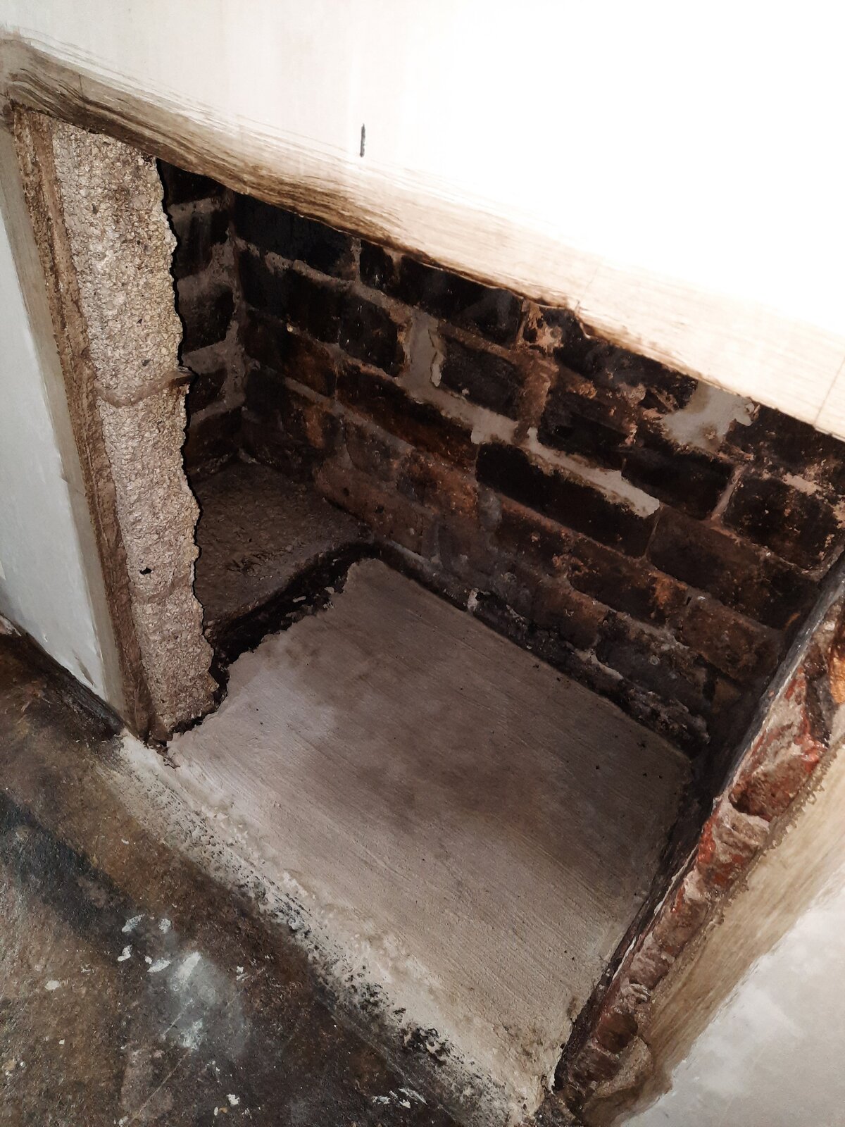

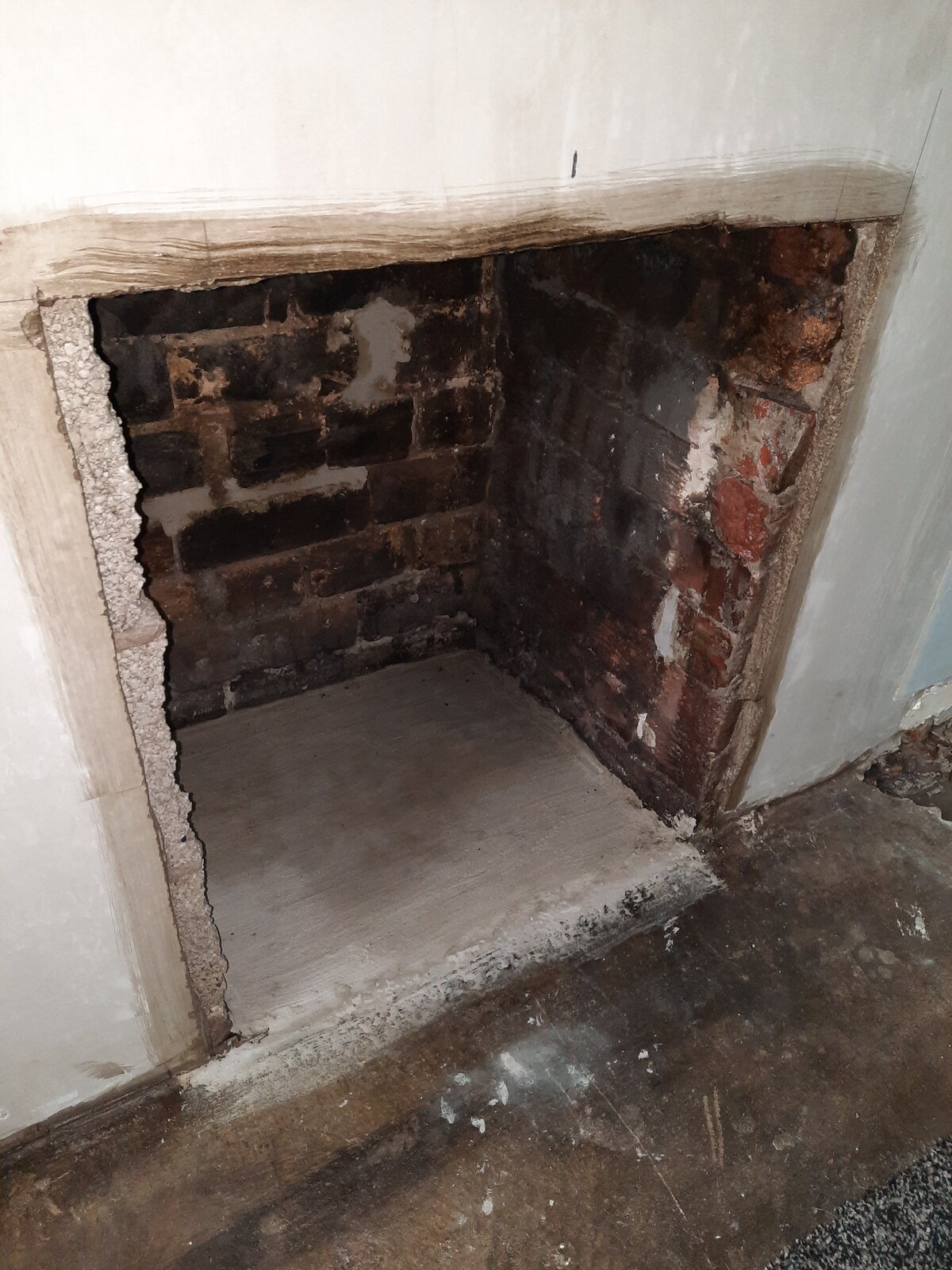

Hi all, old Gas Fire removed, isolated etc.
How to I go about lining the opening to take a small free standing electric stove.
To the right of the opening is the brick, to the left there is a recess.
I'd need it covered from above also to stop any existing soot falling.
Was thinking of a vent on the left hand side to maintain the air flow.
Thanks in advance.

Whatever you do, don't line it with something fixed with a water based adhesive - you'll get salts transfer from all the salts in the bricks. Either use board fixed with foam adhesive, or get some top-hat metal channel, fix that to the brick, and fix boards to that. If it's only going to have an electric fire, plasterboard will be fine
Is the chimney capped? If not get it capped with a vented cowl. Vent at the bottom? why? you'll just get nice warm room air going up the chimney and potentially condensing inside the coldest bit at the top. Just leave the top open, and block off the bottom - it'll be fine. Some people insist the bottom should be vented, but it's unnecessary. Even back in the day, when bedrooms had fireplaces, these usually had blanking plates to shut off the chimney completely when not in use - ours still do...

You need to sweep the flue & have a redundant flue cowl sitting in a chimney pot at the top of the flue.
Box off the fireplace surrounds for the electric stove with backer board on three walls & a top.
And install a 9"x3" Hit&Miss vent on the outside of the chimney breast Left Hand brickwork.
The Hit&Miss will vent the flue.
To experienced workers, Its common knowledge that redundant flues need vents at bottom & top.
Its foolish to suggest otherwise, & such a suggestion will cause future grief & expense.
There's a big difference between flue throat dampers (wrongly called "blanking plates") & H&M vents.
Differences in where they are installed & how they are used.
You do not need any such "blanking plates". FWIW: dampers were used to control heat from solid fuel fires.
