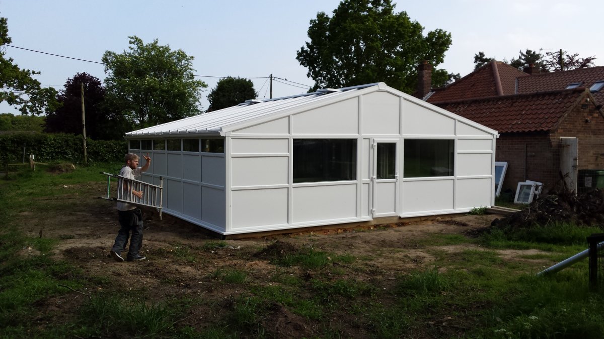

I build massive buildings using Liniar with no problems what so ever.
Sorry it's 1500, just had a look.
The building above is 8 m x 8 m and we doubled the size of it this year. Definitely not flimsy :LOL:
