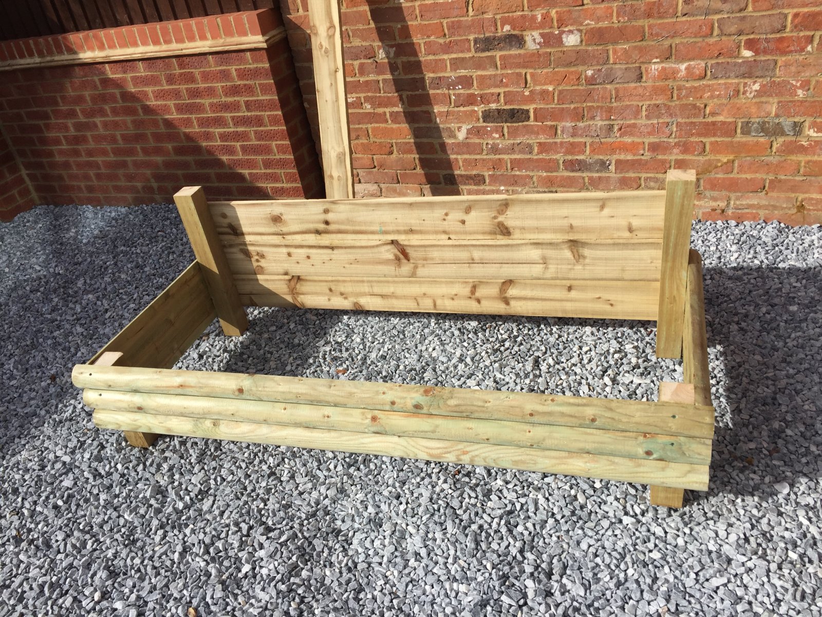

Hi All,
I am building a two tier planter. Work in progress picture attached. The base will be constructed of gravel boards.
What should I line this with so that the soil doesn't seep through the joins and allows for appropriate drainage too. I can drill some holes at the bottom of the planter to aid with this too.
Would appreciate some advise on this topic please. Thanks in advance.

A plastic or metal bucket, tray or similar container so that the wood is not in contact with the soil or the ground. Otherwise it will rot.
It will be easier to buy your container first and then build the ornamental wooden cladding to fit.

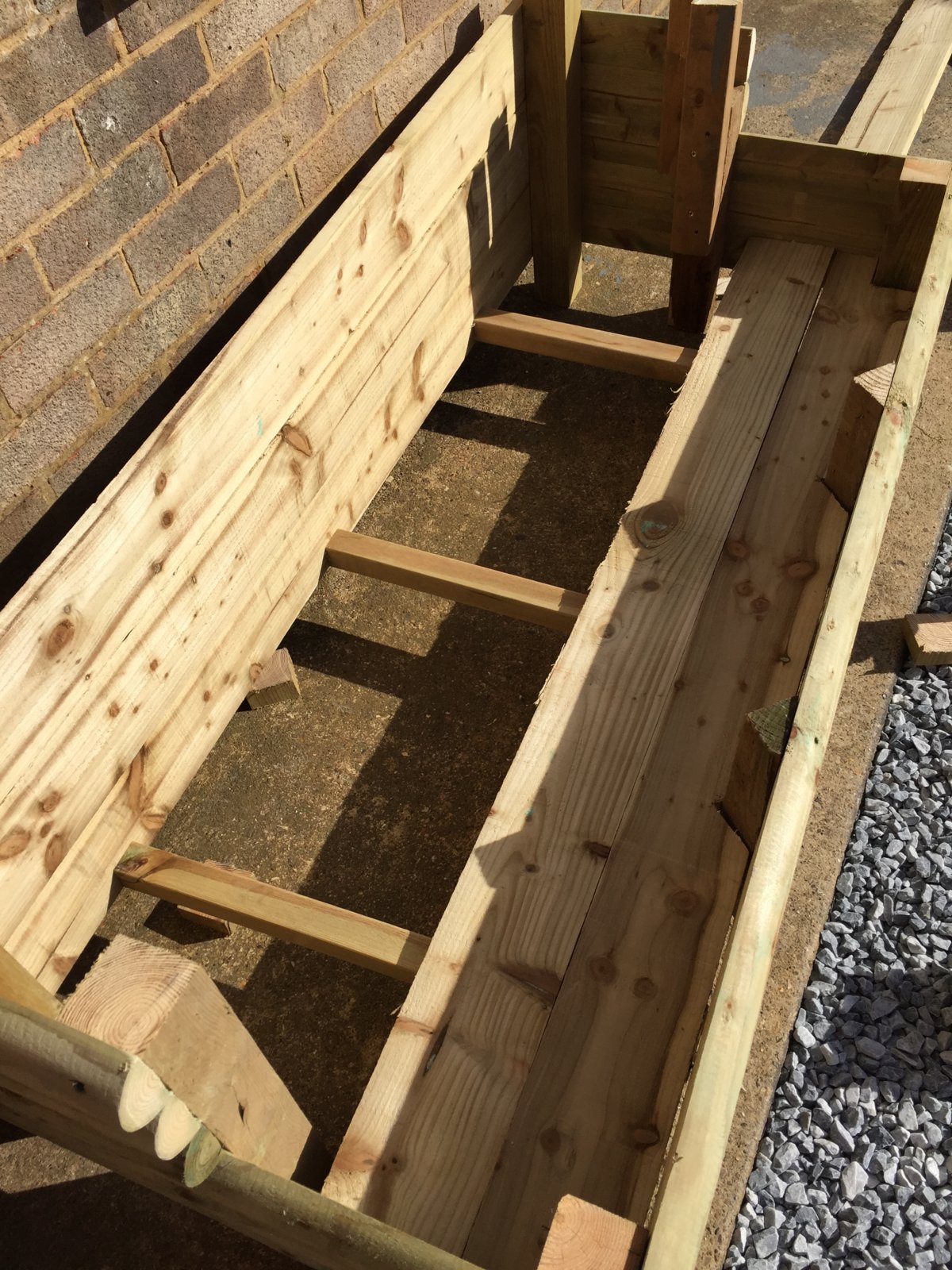

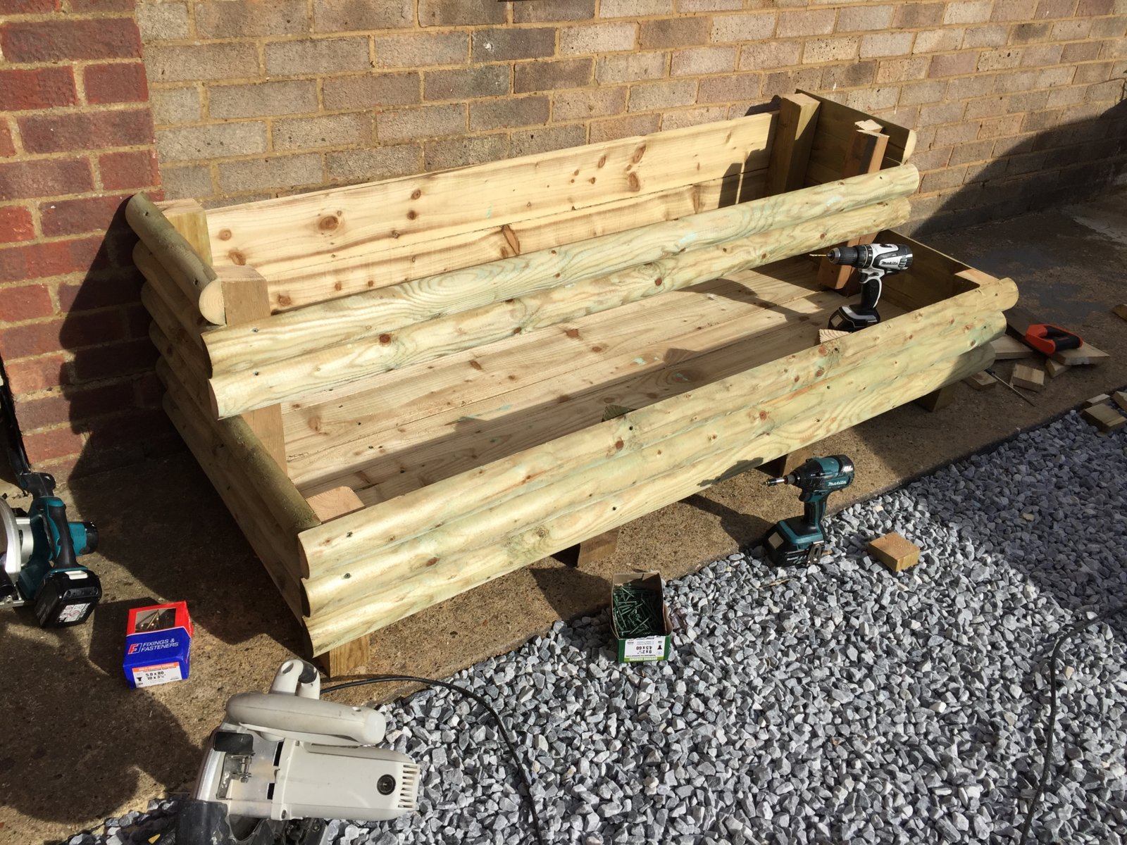

I think there are a few practical options being proposed by way of lining:
1. Do nothing
2. Use memberane for sides and nothing on the base
3. Use weed control fabric on base
Any validations on the above or any other suggestions?
Pictures attached
