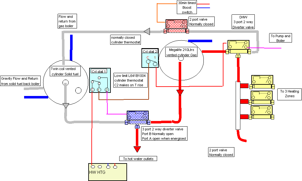

New year project is to install new Central heating system.
Current configuration.
Solid fuel open fire with back boiler heating twin coil hot water cylinder upstairs via 28mm gravity with take off to pump feeding 2 rads, 2nd coil in cylinder not used.
Proposed Config.
Keston c170 boiler feeding Heatrae sadia megalife 210 ltr vented cylinder and 3 heating zones controlled wirelessly on a sealed circuit.
I want to keep the existing system but would like to link the DHW circuit using two 2 port zone valves (normally open on the megalife hot water outlet) and ( normally closed on the existing cylinder hot water output) or one 3 port diverter valve. This would have to be fitted so ports A and B would be inlets and port AB the outlet is this possible as HONEYWELL website says the opposite, why does flow direction have to go AB to A or B
If fire is lit pipe thermostat sense temp rise and opens NC valve and closes NO valve and at the same time de energising power to Megalife stat.
I'm not sure if I ve explained this well enough, I have done some drawings but don't know how to load them on this site.
Any thoughts would be greatly appreciated.

They don't seal the ports that way round. Could use 2 x NO 2 ports, but I don't exactly follow - need that drawing!

I don't understand how you're going to predict and control boiler flow if you link the two primary circuits. Are you really going to be running two boilers, or am I misinterpreting your description?

WHat are the bricked-in valves for? Two x two ports in place of the one 3 port I've left in, would be enough??
I'd be with him above who said use a header, though.
The blue brick 3 port valve feeds hot water from either the megalife gas heated cylinder or if solid fuel alight the twin coil cylinder. The red brick 2 port valve was a bit of an after thought to utilise the second coil in the solid fuel cylinder by wiring to a switch allowing a boost function in summer months.
The durnsley system only seems appropriate for twin boiler heating circuits, as I'm only using the solid fuel boiler for DHW I was hoping to get away with just the valve setup.
