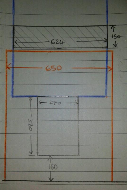

Hi. The other half has had an idea, now I'm left sorting it.
Making space for a new fireplace.
The attached drawing shows the existing opening and lintel in grey, the chimney flu space in blue, and the new opening that is needed in orange.
From looking around the internet I've seen that I'd need a new lintel that's at least 100mm longer at each end than the new opening (850mm).
The old lintel is 2 courses high but the lintel I've seen at wickes is 60mm.
I'm thinking take out the old lintel, remove bricks on either side and fit the new one.

No, it can kill you if he chimney collapses. The advice is not good, but it does say if no lintel is existing. Your project is different as you are intending removing a supporting lintel.
NB: I would advise the lintel sits/overlaps by 150mm each side of opening.

My first thought was to put the new lintel along the top of the existing one and leaving them both in place.
It would mean removing a single course above the lintel.
Is this doable? If temporary support is needed could I support it brick by brick as they are removed?

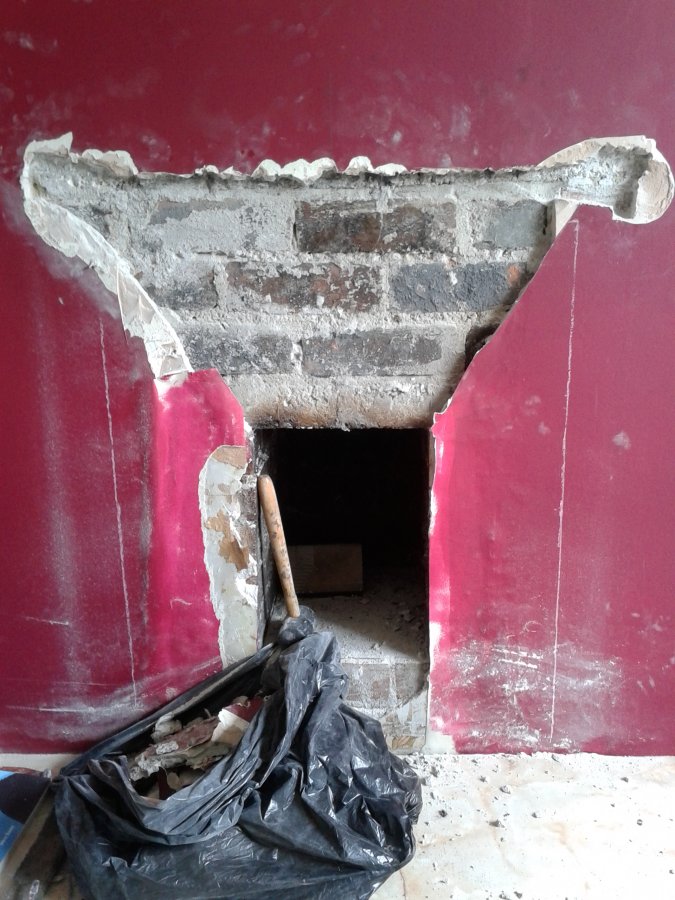

I was ready to acrow prop and put a new lintel in when I found that I'd just missed the original lintel when I'd first looked for it. It's 15mm high, 30mm above the height of the new opening and is long enough for the opening that I need. Very lucky!
Any tips on how best to proceed? Start by removing the bricks directly below the lintel?
