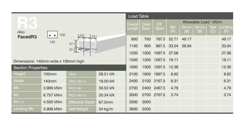

I'm planning on installing some lintels in a single skin (6in block) garage wall and after looking around at the various places with span tables and specifications im a bit confussed as to what value i should be paying attention to to get the correct load?
I'd like to use R15 lintles as they can be used on their side and will fit the block nicely but want to be sure that it will be upto the job on the biggest opening (1.5m).
My engineers report says the lintel in question will be under the following load:

I run into trouble when looking at what a R15 is capable of one source says load baering capacity of 18.45 kN/m another says a UDL of 9.5 kN/m a thrid source says though a slightly differnt product (Naylor R3) specifies an Unfactored Load of 12.38 kN/m
Which of these values do i need to pay attention to when taking my engineers calculations into consideration?

You can't use a Naylor lintel on its side - they're designed to be used in one specified orientation.
A Naylor R3 lintel will do 12.38 kN/m at 1500mm clear span, which is fine based on your engineer's loads above.

sorry by on it's side I meant the widest section like shown above.. What I'm really wondering is if a R15 placed in the same way would be strong enough?
Edit: He did specify R3 but i'm struggling to find them locally or for a reasonable price.
Presumably use the figure of 9.5kN/m, BUT, that is for the lintel upright - you are proposing (?) to use it flat, so its' load-bearing capacity will be less.

This is the Value for flat the upright value is 11.1

Woody: Thanks for your input.. The engineers report was more to do with a bigger project for the main house (and a proper builder) and the garage conversion was tacked on as a freebie by an architect friend of mine. It just seemed every place has a different unit/messurement when trying to compare lintles and their properties, the image above threw a new one into the mix Mr(A) which was the same value as Naylors Unfactored Load.
