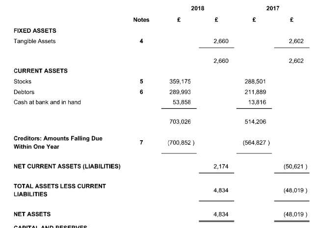

The problem with MCBs (and RCBOs) is that properly testing them is easier said than done. To properly test a MCB requires the ability to put kiloamps through it in a controlled and repeatable manner. Few of us have the ability to do that so we have to rely on secondary evidence as to whether the products we are buying are any good.
In the EU/UK importers are responsible for the products they sell. So the question is are the importer willing and able to do their duty and ensure that the products they are importing are up to standard? and to recall products if evidence later arises that substandard product slipped though? or are they are a small bushiness who are in over their head? or are they just a front for a company in china with no significant assets in reach of western courts and that will disappear if/when the **** hits the fan?
I have to say when I look at live electrical's website, the alarm bells are ringing.
* They have a list of local representatives, but they only have mobile numbers for them.
* They have a list of distributors which includes a bunch of websites I have never heard of and one major wholesaler. When I follow the link to said major wholesaler and look through their catalogue I see no mention of live electrical.
* Their home page shows a bunch of unreadable pictures of certificates, but when I go to the individual product pages there is no information given about what standards they comply to or who has certified them as complying to said standards.
That doesn't necessarily mean the products are bad of course, just that their website isn't filling me with confidence that they are good.

LIVE ELECTRICAL DISTRIBUTION (UK) LIMITED
DIRECTORS
CHEN, Xiaohua Nationality: Chinese Country of residence: China
HAN, Wenzhong Nationality: Chinese Country of residence: England
XU, Youbing Nationality: Chinese Country of residence: China
... with no significant assets in reach of western courts and that will disappear if/when the **** hits the fan?

Buying cheap-o-matic consumer units is a one time deal - if in 3 or 5 years time you need another MCB, RCBO or whatever, what are the chances of them actually being available?
If you can't get one, it's time for another new board.
Buying cheap-o-matic consumer units is a one time deal - if in 3 or 5 years time you need another MCB, RCBO or whatever, what are the chances of them actually being available? If you can't get one, it's time for another new board.
There is that aspect, although its not always guarenteed that it'll be better with a different brand, five years ago you could have fitted MK and be in the same boat, or as I did at home havells (part of the sylvania lamps company) although I have got spare devices put away. Or fitted a commercial square D board with QOE breakers roughly 20 years ago, for a laugh ask your wholesaler for a price for a QOVS RCBO (the current line of devices that are intended to fit these older boards), need to fit more than a few and its cheaper to replace the board!
Not trying to diminish the point, just making the point that you could easy spend more on a big brand and have the same situation, less likely, of course, but still possible
