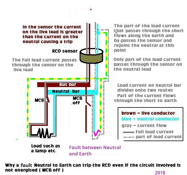

live to earth short circuit tripped mcb but not rcd?
Hello again, having done further inspection, it turns out if I touch the neutral and earth together the rcd does not trip at all, I tell a lie it does trip but only when heavy loads are switched on such as the kettle, ...
That is probably 'as expected' - touching neutral and earth will usually not make an RCD trip if there are no loads 'on' at all.
Kind Regards, John
Do I have an earthing or insulation problem?
When there is a Neutral to Earth fault some of the Neutral current from a load will flow through the fault and bypass the RCD.
The thing is tho all circuits were on at the time, only small loads were being used however, just your usual fridge/freezer tv and a few lights ect, it used to trip when touching the neutral and earth when the central heating was running, it does not do this anymore which concerns me.

Fair enough - if there has been a change, then that warrants investigation.
I appreciate how a rcd works but it is almost doing the complete opposite, Its almost my rcd now needs a very high imbalance well in excess of 30ma to trip out, that also concerns me,...
Possibly - but, depending upon how the circuyits are arranged, only a tiny proportion of the load current might go through your N-E connection - so it could still be 30mA or less even with fairly large loads...

So you have demonstrated the RCD works on the neutral (the description you have given is a common occurrence) so the Live side needs testing, this can be done by placing a small load between L & E. A crude way of doing this is to rewire a 13A plug for a small load, such as a table lamp.
AND THEN RESTORE THE PLUG IMMEDIATELY AFTER COMPLETING YOUR TEST.
Never thought about that, sounds like a handy trick and very simple, I will give that a go,its certainly sounds much safer than grabbing hold of a live wire me thinks:LOL:
So you have demonstrated the RCD works on the neutral (the description you have given is a common occurrence) so the Live side needs testing, this can be done by ....
Since an RCD detects the L-N current difference, it's hard to see how it could behave differently with L-E and N-E 'faults'.
However, I suppose what you suggest could be done to roughly quantify the RCD's trip threshold - assuming that the OP's supply voltage is around 240V (which is what most of us get), 30mA would correspond to roughly a 7.2W (resistive) load - so an RCD ought to trip with a (restive) L-E load of about 7.2W or more, and should not trip with an L-E load less than about 3.6W. Assuming he hasn't got a box of low-value wirewound resistors, he might struggle to find resistive loads that small - unless he has a stockpile of very low wattage incandescent bulbs.
Kind Regards, John
I have just tried that trick on my polaroid 32 led tv, I connected the neutral wire in plug to the earth terminal then switched on and to my surprise the rcd did trip, the tv draws about 60w max when running in use, it was on standby so I am not sure how many watts it drew, its just after midnight, so hardly anything is being used at the moment, but somehow this experiment managed to trip the rcd, so maybe it does work after all and would save my life:). Thank god i can get some sleep now.
