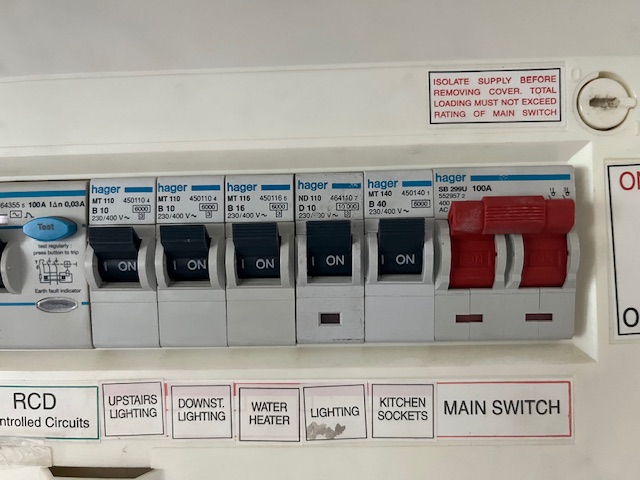

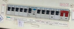

consumer unit, can't read MCB or RCD size, and note window with third from right unit is this a RCBO. But 5 single module width trips to right are likely not RCD protected, and the 5 single module width trips to left are RCD protected, so those to the left have both over load and leakage, and to the right 4 maybe 5 are not RCD protected, but there should be no circuits not MCB protected, so how did you manage to find.

I assume this View attachment 379428 consumer unit, can't read MCB or RCD size, and note window with third from right unit is this a RCBO. But 5 single module width trips to right are likely not RCD protected, and the 5 single module width trips to left are RCD protected, so those to the left have both over load and leakage, and to the right 4 maybe 5 are not RCD protected, but there should be no circuits not MCB protected, so how did you manage to find.

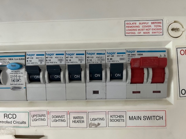

You're right third is different. Pic below.

Interesting 10 amp for lighting! In the main, we have ceiling roses rated at 5/6 amp, so normally we would use 6 amps, and a type D so that is 20 times for the magnet part of the trip. So 200 amp to trip it, or an earth loop impedance of 1.035 Ω so it would seem you're limited to around 20 meters of cable, which it not that much.
It seems it is just an MCB not anything special, but type D.
But if there are type C on the non RCD protected, what is on the other side.
