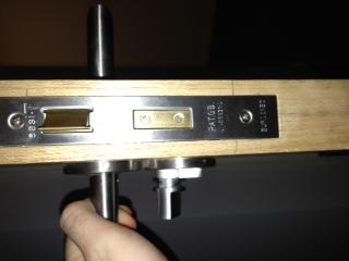

Hi everyone, i'm an amatuer DIY man and need help with with my door locks.
Basicly my jacket was stolen in a club and my house keys were in it so as a result I need to change my locks, fortunantly its a flat so it's only the 1 door, i'm planning on doing it myself to keep the cost down so any advice you can give me would be fantastic, including cheapest places to get parts.
Here's the lock, hopefully the pic will show
If you live with someone and door can be left unlocked for awhile, remove lock and take to nearest locksmith/ironmongers and match up size like for like.
To remove you will need to undue roses on handle and lock catch, then unscrew the internal fixings, take out bars then remove the mechanism by unscrewing top and bottom and sliding lock out.
It looks to me like an escape lock with an internal thumbturn. Often used in flats where there is no other means of escape in a fire to prevent you locking yourself in.
Quite new so it probably has a Eurocylinder with thumbturn. which is all you need to change - the lock can stay. The new cylinder must be the same length.
If however it is a Wellington or something you will need a new lock, and may have to order it through a proper merchant or online
Show us the inside and outside views, and tell us the names and numbers on the fore-end, and the key
