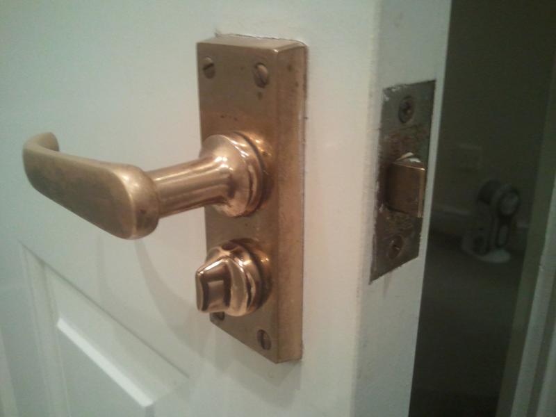

Hi,

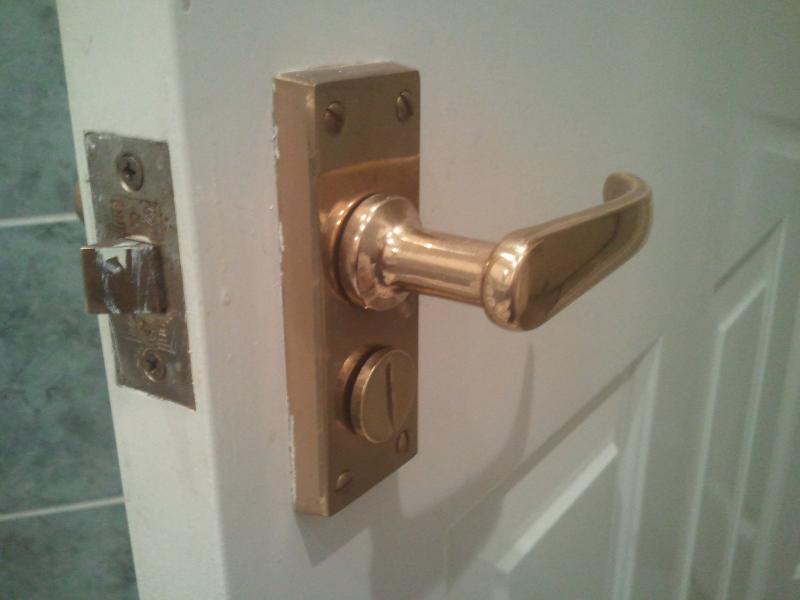

My house (10 years old) has bathroom locks as shown in my pics below. The door handle is at the top, and the turn know for the lock below simply locks the single latch in position. The lock has an E *star* S logo on it.
The door locks are all failing and I'm wanting to do a straight replacement of the door + handles if possible. However, all the bathroom handles / locks I've seen on the DIY store website have mortice type locks rather than the type I have and I'm now at a bit of a loss as to what I'm looking for.
What would be a suitable replacement lock / handle and where would I find this?
Are there standard sizes of handles / locks? Do manufacturers have inter-compatible products?
Many thanks,
Tim
Just make sure the handles are for use with a normal latch, not a bathroom lock.
