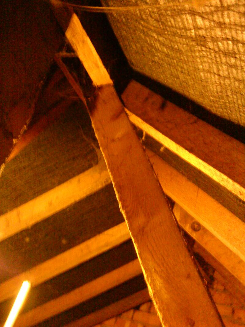

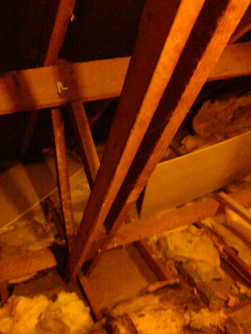

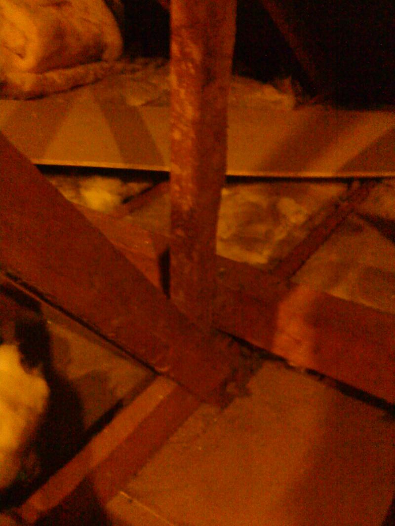

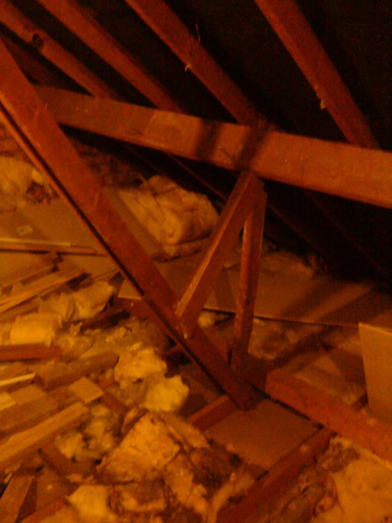

im not looking to convert my whole loft into a room, but my sons bedroom is the smallest in the house, and he has worked so hard for upcoming exams that i thought id treat him to a re-jigged funky bedroom, the idea i have is for his bedroom just to contain his bed, a small drawer unit and a wall-wide new york at night wallpaper mural.. with a storage area in the loft for a clothing rail... a few old games and keepsakes and a couple of bookshelves for his (hopefully impending) uni courses
i was thinking that i could box/partition a section of the loft area, with ladder access from his room.. i know about insulation and vapour barriers etc but in order for me to make it accessible and not to have a ladder crossing the window, with little headroom above for access, i would need to remove what i think are called purlin braces, if i could remove part of the purlin too that would be fantastic and double the access space to make it feel more open as it would be visible from his room and allow me to possibly install a roof window at some point, but if needs be i could live with the purlin staying in situ if neccesary.
i know i would need to brace and support the rafters if i removed a purlin, but are these bracey things just there to stop the purlin bowing or sagging or do they perform some other task too.. what are the ramifications of removal and if i did decide to remove the support, what would i need to put in its place to counteract its removal

You need to speak to locall council regarding your 'plans' they will stop your head exploding and your house falling down. :roll:
Loft conversions are not cheap, especially ones that require structural engineering input (e.g. purlins out, beams in, etc...). I would also speak to a structural engineer as they would be the ones required to provide details/calculations if you did carry out the conversion under Building Regulations, which you should be doing.

... basically i want to create a new loft opening and put a small box over it, maybe im thinking of it too simply.. i dont know, but the problem remains that the strut beams that you see in my pic will be in the way of any access by ladder, if i were to build say for example another 2 identical struts to these and install them either side of the opening i want to create, wouldnt that be stronger than it is even now and allow me the space to make a small plasterboard wall partition and hang a clothes rail and a couple of shelves beneath it ? .. if i put extra beams into the floor to strengthen it, to cope with the weight of clothes and shelving, and dont make it big enough for him to even place a foot on the floor up there, isnt it just classed as a loft opening ? rather than a conversion ?

Even if you weren't going down the full loft conversion route, but using the area for storage... as soon as you carry out any structural changes, a Building Regulation application would be required and an engineer engaged.
