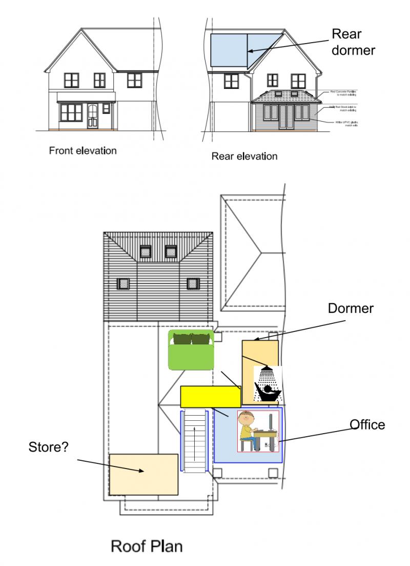

Are there any free online sketchup tools available? I tried a couple of downloads but too steep a learning curve.
I was the plan the design myself to start with, to save time with the architect. Trying to work out where the stairs will go. If we extend the current ones they are right in the middle of the loft space which will be a bit annoying.
Got an annoying shaped roof. Hang on, I could probably show you ...
Ok, that took a while. Just "designed" my loft, version 1.
