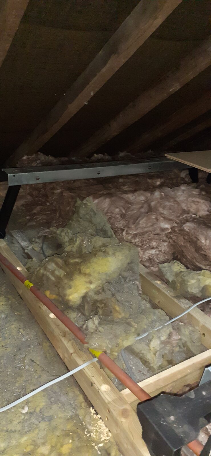

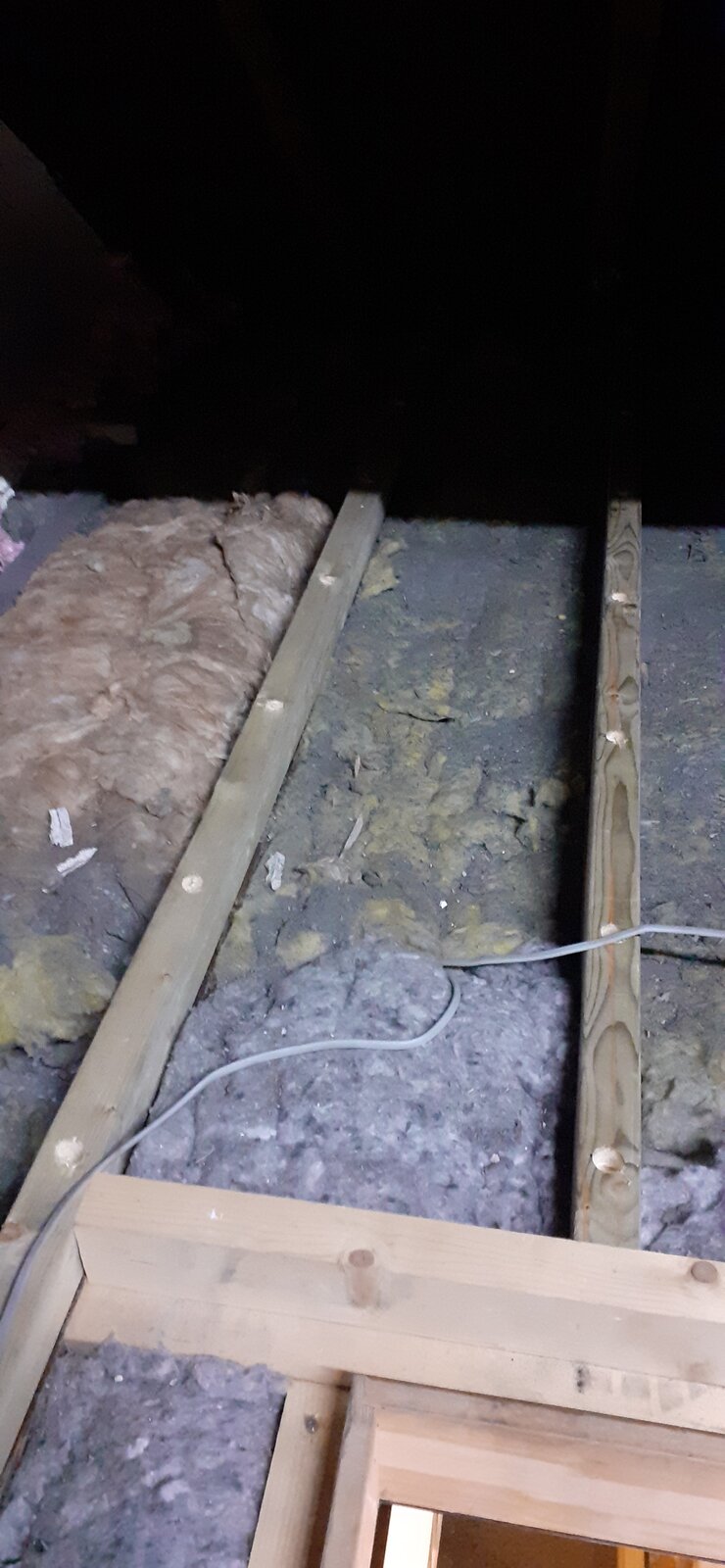

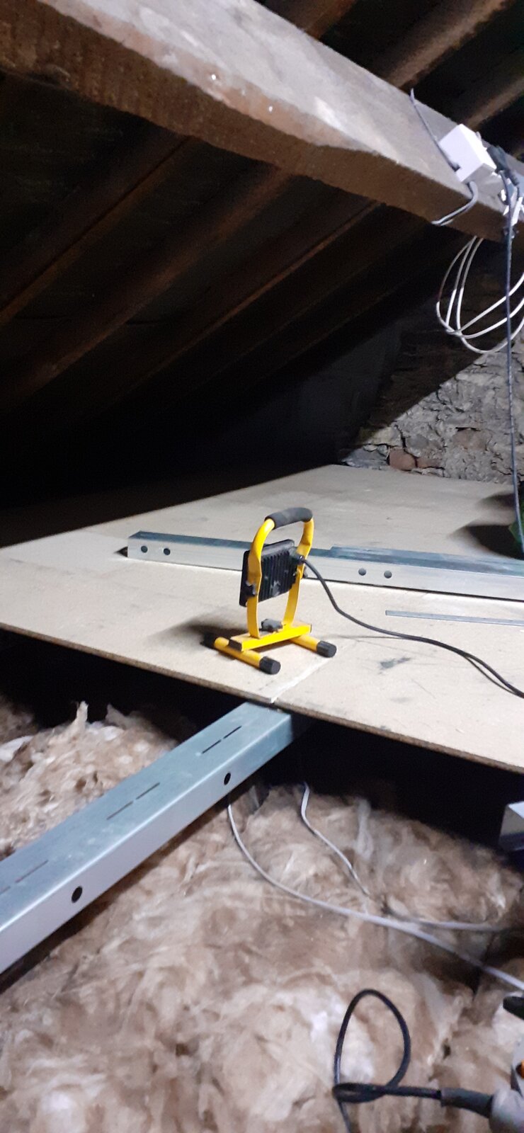

In my case I wanted extra strength for the loft storage, given that my joists had 130 years of bow and some other damage. I also wanted more insulation.
I don't know if these work-in-progress pictures show much:
So following Tony1851, I screwed and glued 2x3 CLS on top of the existing 2x3 joists.
I added 100mm of insulation between the joists and 170mm perpendicularly over the top - disposing of all the existing insulation and vacuuming up the detritus.
And Loftzone Storefloor went over that.
The floor is now solid and a very usable space.
