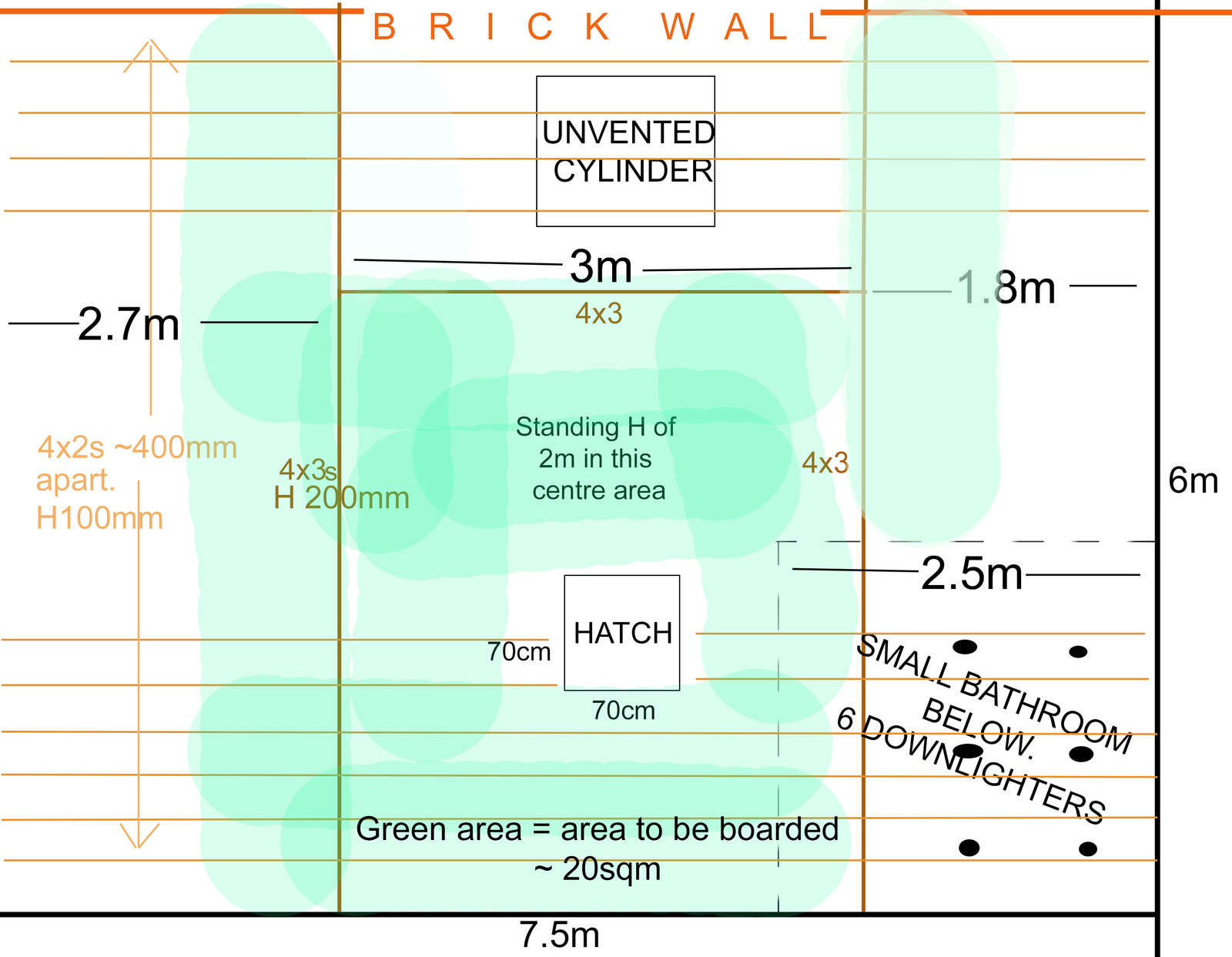

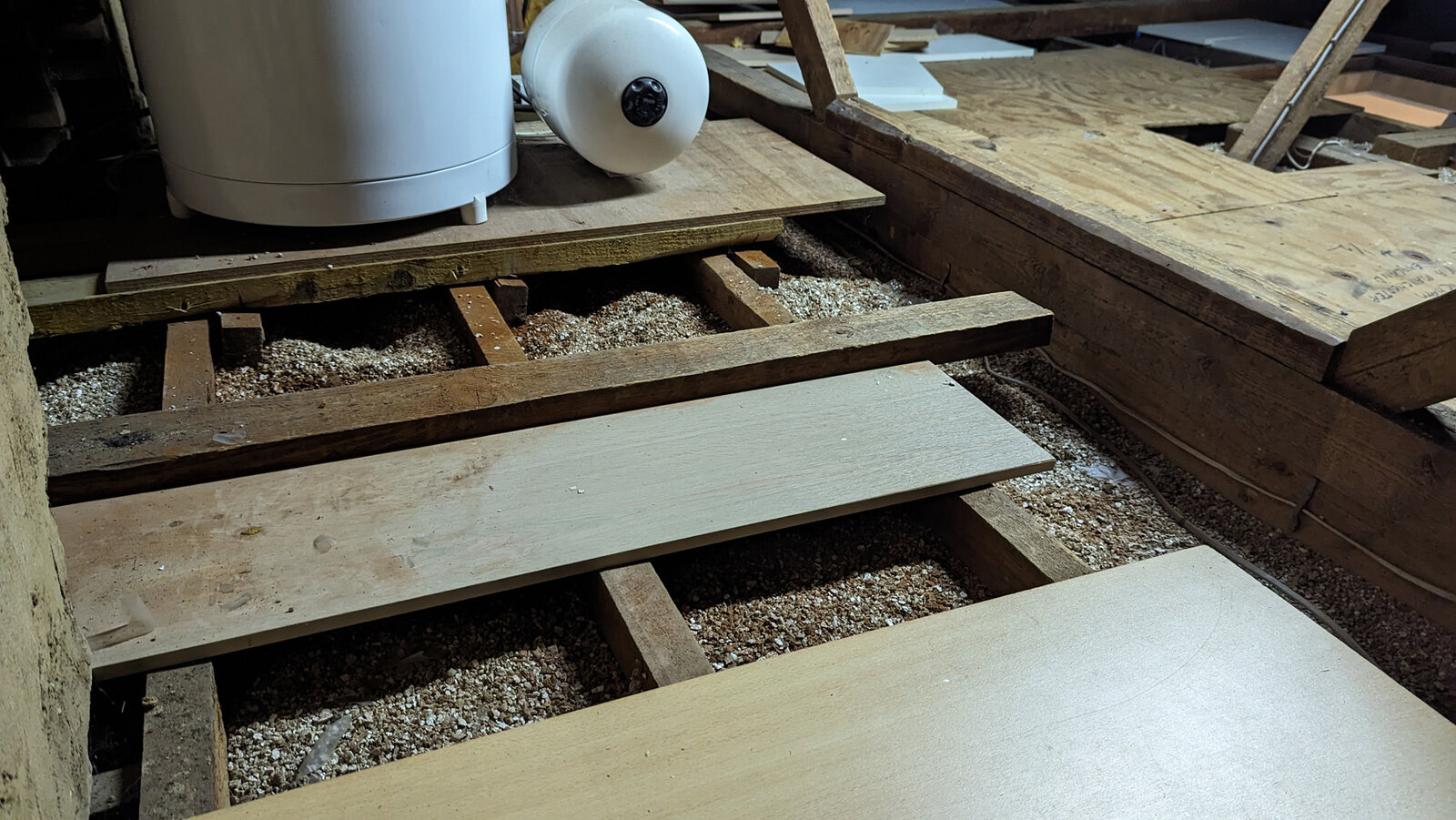

I have 1 more job that will be too much for me alone and involves raising the floor joists in the loft of our 3.5 bedroom semi-detached ~1950s property in order to get insulation in, then boarding over for storage. There has been zero loft insulation for 20+ years. I have emptied the loft - about 400-500kg of stuff up there. I have reduced this down to about 250kg of storage to go back up.
The current joists are 4x2s. Please see diagram and images: https://flic.kr/s/aHBqjBgbmN

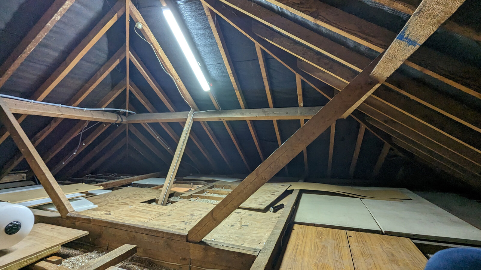

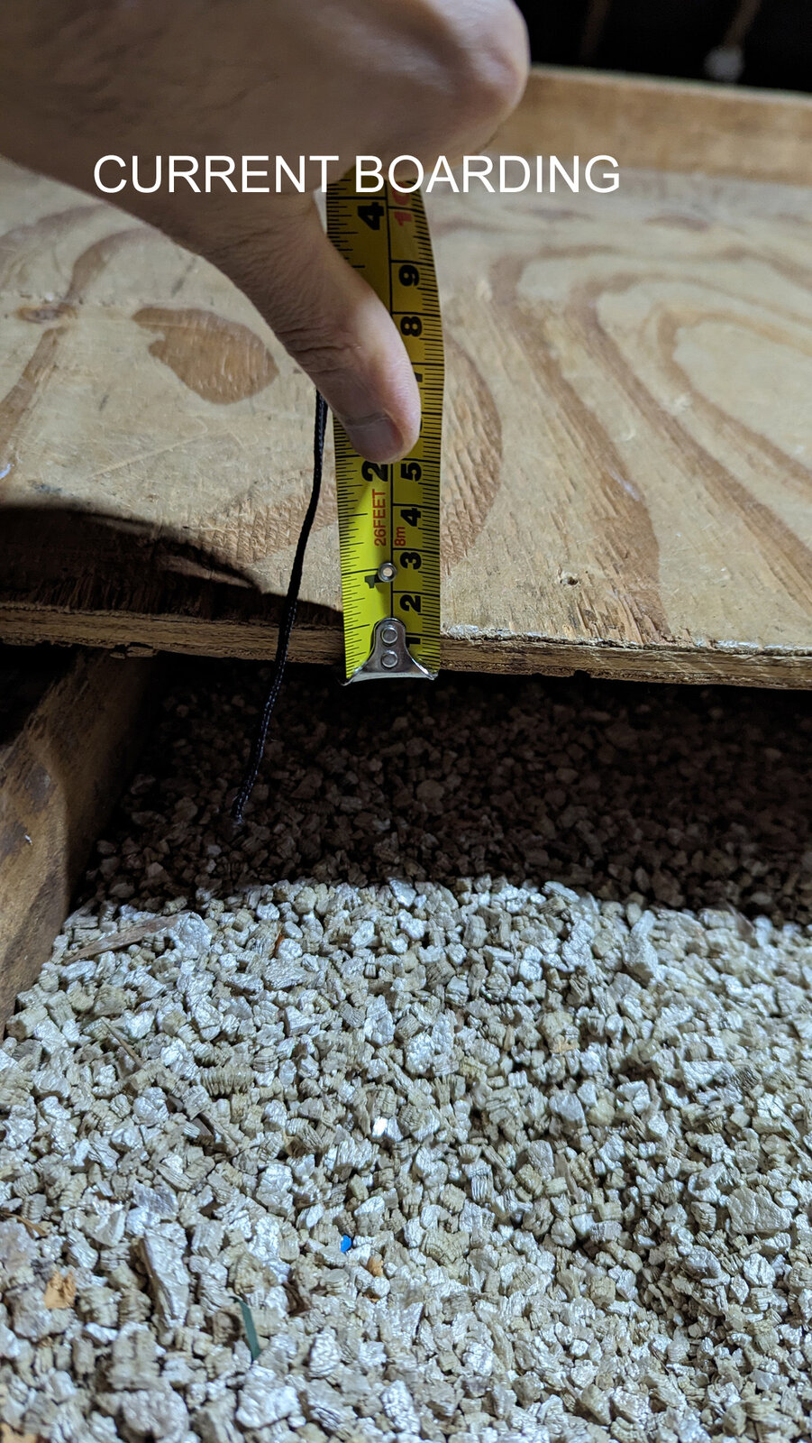

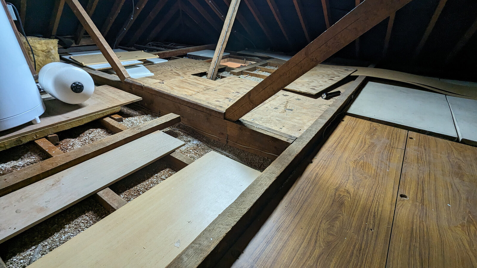

The current ‘boarding’ in the centre area looks like 10mm ply nailed down. And the rest is old scrap wood (offcuts etc.) which is thicker, but never screwed down – all been walked on (carefully!) for over 20+ years without issue.

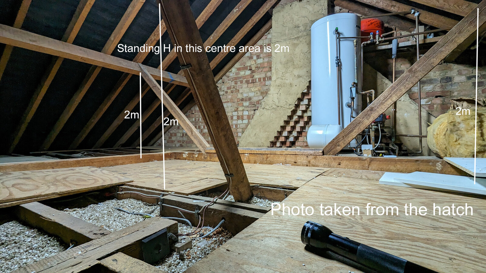

I am looking for the easiest method (but no small plastic loft legs) which won’t cause issues down the line…and not after anything ‘pretty’ as the loft is only visited 10 x a year for a few mins at a time. The lathe & plaster ceilings in the rooms below the loft have feint lines due to, presumably, the weight of the excess storage over the years. These lines have not worsened and have been there for years. No loft conversion is planned for the future and we hope to be in the house for at least another 10 years. The access to the hatch from below is quite good – it’s on a landing and some stuff I removed from the storage included a 2.6m length copper pipe.
PLEASE kindly see what you think of the following options
Option 1: New 6x2s *parallel* directly on top of existing 4x2s @ 400mm centres > takes total height to ~ 250mm. Screwed in diagonally with plenty of (PVA?) glue in between the wood. Finish with plywood or OSB3 T&G screwed on top. This means 1 single layer of 200mm insulation + a ~ 50mm air gap. No joining with the brick wall.
Option 2: New 6x2s on top *perpendicular* to existing 4x2s @ 400mm centres > takes total height to 250mm. Screwed in diagonally with plenty of (PVA?) glue in between the wood. Finish with plywood or OSB3 T&G screwed on top. This means 1 single layer of 100mm insulation between the original (4x2) joists and another 100mm going across + a ~ 50mm air gap. No joining with the brick wall.

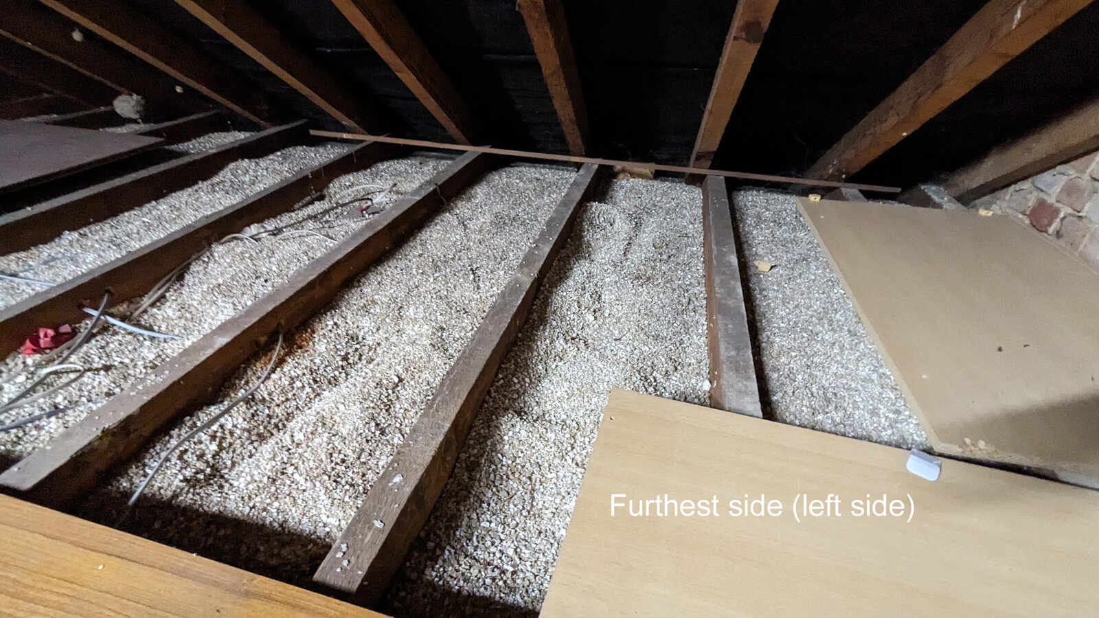

Both of the above options mean sweeping up to remove all the current vermiculite which is as low as a 1” and high as 3” in places. Find a local joiner to build sub-frame + board-over after I have rolled out the Knauf 44 insulation (leaving a ~ 5cm gap at edges). Remove the old boards + disposal myself (unless local joiner can use them). I have contacted a joiner who has advertised for years in the local church newsletter and when I described the job, he said he is happy to take a look in a couple of days.
Option 3: Go with a loft insulation company (with v. good online reviews). I got a response from two companies out of eight. 1 quote comes to £2100 for option 1 above using 18mm T&G. This includes disposing of current boarding and re-aligning the current 3 tier ALU loft ladder to work with the new floor height. They will use Knauf 44 and board ~ 20sqm. They measured the area insulated to be ~38sqm. They said they would lay the first 100mm over the current vermiculite, but ideally the vermiculite is removed (by me). They will need 1.5 days. They said 200mm insulation is enough and they gave the price instantly.
I am waiting for 1 more quote from another company. This 2nd company needs ~ 2 days to do the job and said he wants to put in 300mm, so I assume he is using 8x2s (8”+4” = ~300mm). This means no air gap if I have understood correctly. The loft is fairly well ventilated, however he also said he will put in several roof vents (the cheapo type that lift the felt a bit). Each of the guys from these companies took about 5mins to have a look at the job and said they cannot re-use current boarding. But, overall the job appears to be quite ‘normal’ for them rather than anything too complicated. The bathroom (no electrical shower) area has a bit of messy wiring above but neither company mentioned it. The other rooms have a single ceiling rose light.
Time is against me as I only have 13 days to get this done, so unfortunately, it is not something I will attempt as I don’t have any experience in wood work. I feel like shoving all the storage back up there and giving up, but the Mrs said to put some forum posts up online to get advice.

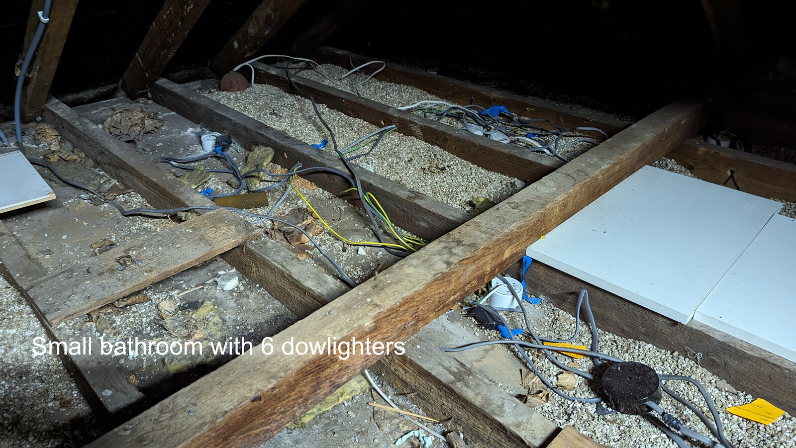

Leaving me to roll out the insulation, install 20-30 lap vents, pop 6 plant pots on the downlighters - a newbie like me can hopefully at least do this much.

I didn't really read all of that it really is too long/rambling but is the gist you want add 300mm of insulation and board on top? Look up LoftZone StoreFloor, https://www.loftzone.co.uk/product/storefloor/ that's very DIY friendly, their website has plenty of links to video tutorials and which screws to use etc.
Sorry mate, I will reduce length of the original post if the site lets me later. I have an exam on Monday so I'm just a bit occupied. Looking to have a timber subframe rather than any kind of plastic leg (long story which I will not bore you with).
Just lay down the biggest pieces of 100mm celotex you can get up there (on the joists) , then repeat with a staggered bond then repeat with those boards that are there with additional 9mm osb or similar if a bit extra needed.
6x2's weigh a lot and 8x2's even more. By the time you add the 18mm chipboard on top you won't have a lot left for storage. I completed a very similar job last year and decided against the 8x2's due to massive extra weight and went for the Loftzone system. Its a great system, light weight, very sturdy, easy and quick to install and I highly recommend it.

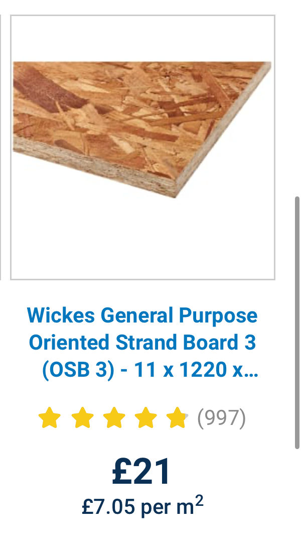

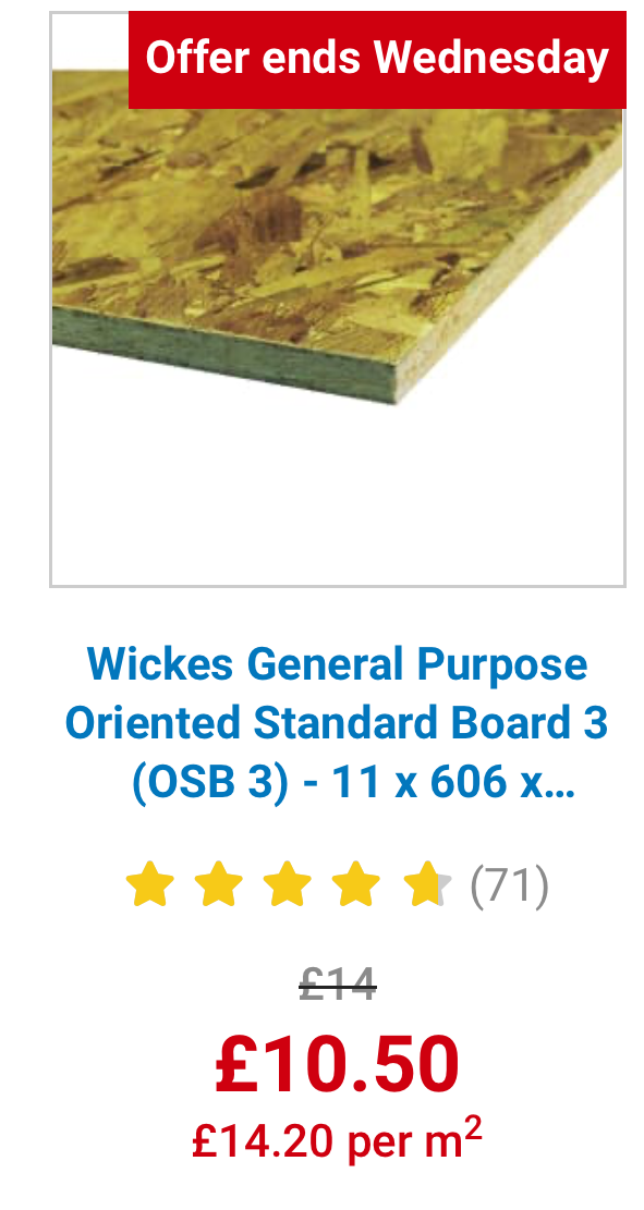

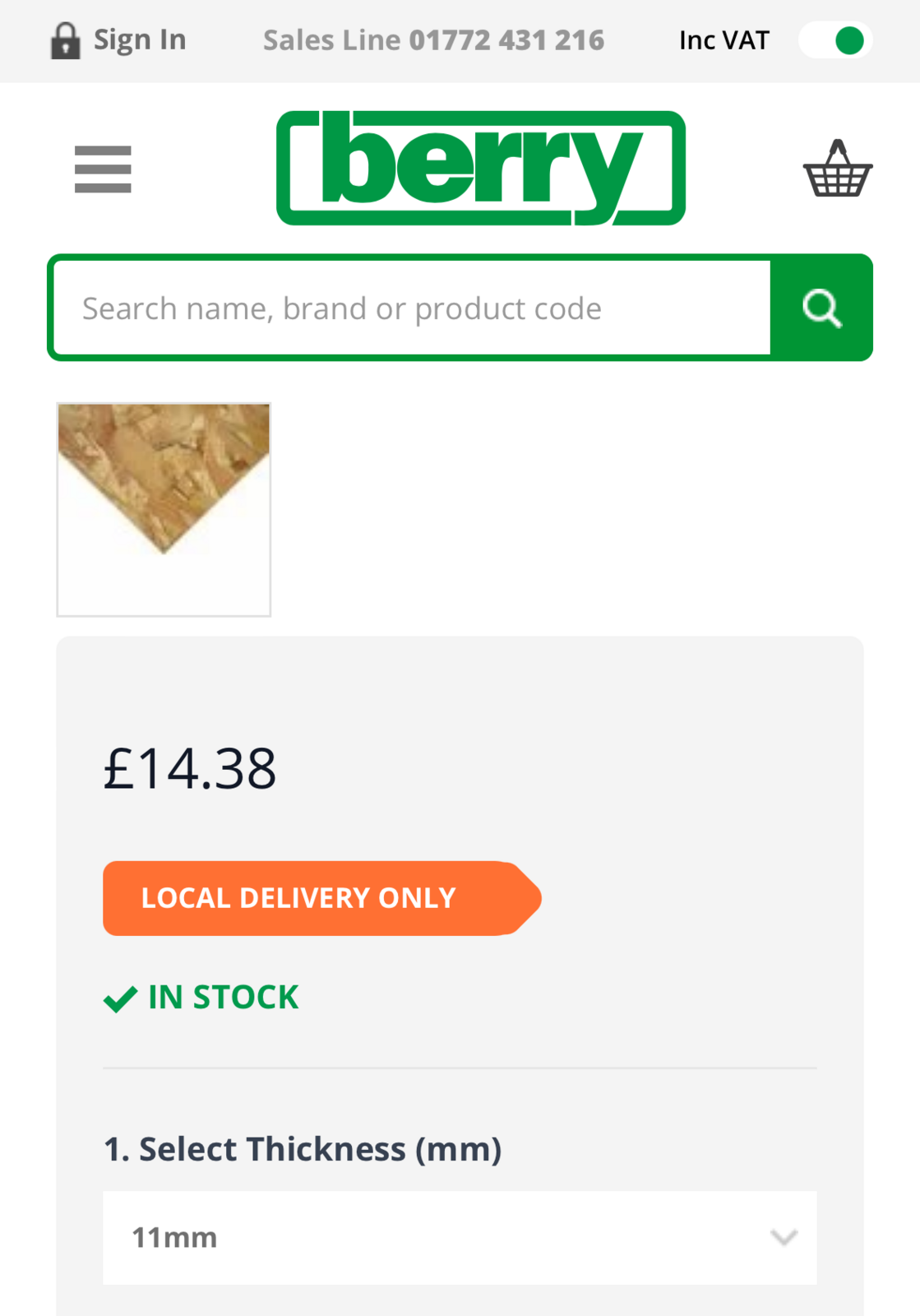

Don't get suckered by Wickes' "special offer" on OSB;
Their offer boards:
are still twice the price, per sqm, than their non-offer boards:
Which themselves are still 50% dearer than a decent builders merchant (and your local friendly BM may deliver for free):

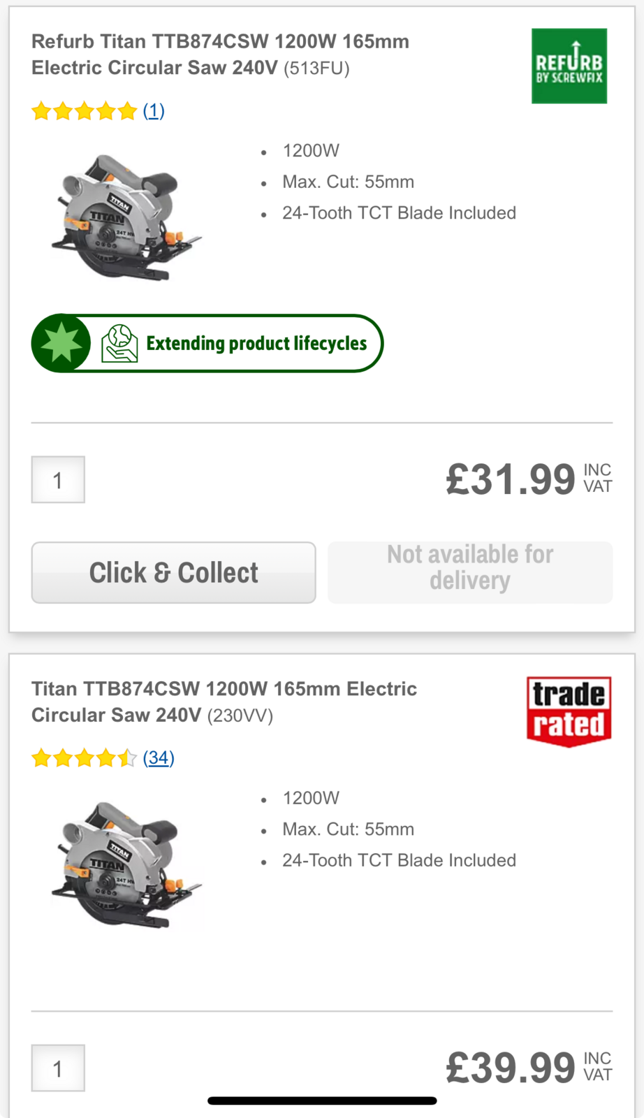

If the complaint is that you can't fit 1200 sheets through a loft hatch, a circ saw is about the price of 1.5 Wickes boards/about half the price of their big n bulky delivery :D
Thanks v much! That gives me a lot of confidence. If the circular saw is not difficult to use then I will do just that.
