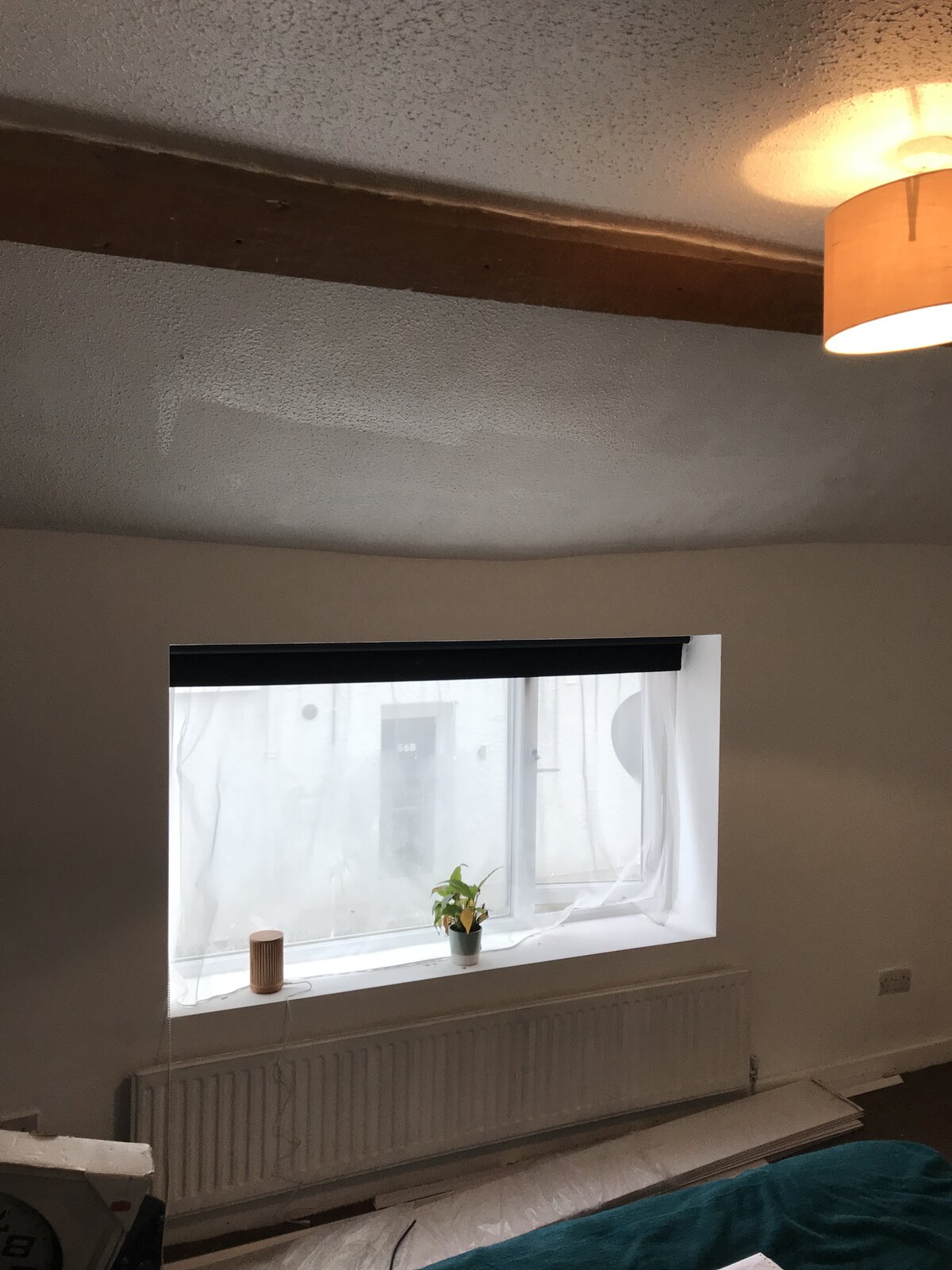

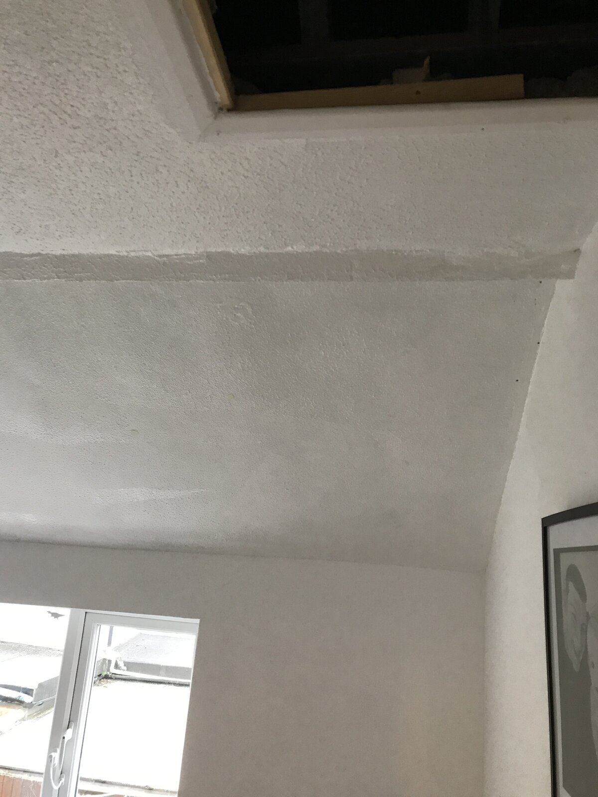

Hi all
move got an insulation guy coming to do 270mm in the loft. But he says he won’t do the slanted void.
but the EPC website says the slanted void is very poor insulation and flat but is average.
Can anyone advise me wether they should or shouldn’t be doing the slanted void please?
I would not have thought you would have wanted that part of the ceiling ripping down in order to insulate it would you? That's they only way they will get to it to install insulation.
