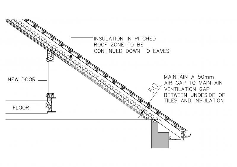

I am doing some work in my loft rooms. Improving the insulation and creating more eaves storage spaces. I want to have lots of storage, but don't want to compromise the insulation in the rooms. I'm insulating the ceilings and dwarf walls, but will loads of doors create breaks in the insulation? I've considered insulating within the eaves spaces, but presumably I need to leave air flow at the eaves. Does anyone have any ideas how to deal with this problem? Thanks.
