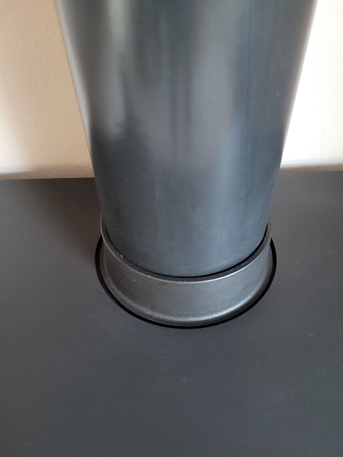

A Hetas fitter has installed a logburner in my home, but not sealed the join at the collar to stove pipe. I didn't see him seal anything at the join between the stove pipe and flue adaptor either. He didn't use anything when joining the flue liner to the adaptor, as he said its not needed.
He claims that the stove pipe joins are "self sealing these days", which contradicts everything I've read or been told prior.
I realised after he left that he also failed to install a Carbon monitor.
I have contacted him, but he has not been gracious enough to respond as yet.
Cn anyone confirm that these two metal items are somehow self sealing?
This is the logburner to stove pipe. The upper end is covered by a debris collar, so not visible, but it's the same steel stove pipe just slid over the spigot of the flue adaptor.
On my stove that spigot to flue joint is filled with fire cement. That said my old stove didn't have a spigot, just a seal of stove rope.
The pipe to liner joint is not filled as the flue pipe sits inside the flue liner.
You can buy fire sealant, but not something I've used.

The fitter said the liner to adaptor didn't need sealing, but the way he cut the liner was not straight, so some was pushed into the adaptor a lot, some less so, before he bolted it up.
I know I can seal the spigot myself and fit the CO monitor, but isn't that what I paid a lot of money to a HETAS installer to do and isn't he breaking the law leaving the install in an unsafe condition?

What is the model of the log burner, do you have the MI?
Not sure why there's any ambiguity, most if not all solid fuel stoves/fires must be installed "in accordance with the manufacturers instructions" or in the absence of them, the regs that cover the appliance and that will cover how the flue will need to be installed. If the MI hasn't been followed and states that sealant/cement should be used and it hasn't, then it hasn't been installed properly.
You need to be sure that it hasn't been installed properly before any complaint is progressed.
I do have the MI in an envelope, I will check them. I have spoken to the manufacturer and they have no knowledge of 'self sealing' pipes, so I doubt the MI will say different.
The fact he failed to install a CO monitor is enough to report him I would imagine.
If the manufacturer asks for the flue to be sealed at the stove>flue connection point then there's you answer. As far as further up is concerned then again I would expect the MI to specify what flue is required. If that hasn't been followed then that needs to be pointed out to him and give him the opportunity to correct it, or prove to you in writing that it isn't required, if there is still no answer then it would further.
I don't believe there is any 'legal' requirement for him to install a CO detector. As a professional fitter though, he should either fit one and add that to the invoice or recommend to you that one is installed before the appliance is used, as I am sure that will also be in the MI given it's 'open flued'
The regulations state that a CO monitor must be fitted in the same room as the solid fuel burner. HETAS installers are supposed to fit one before sign off.
