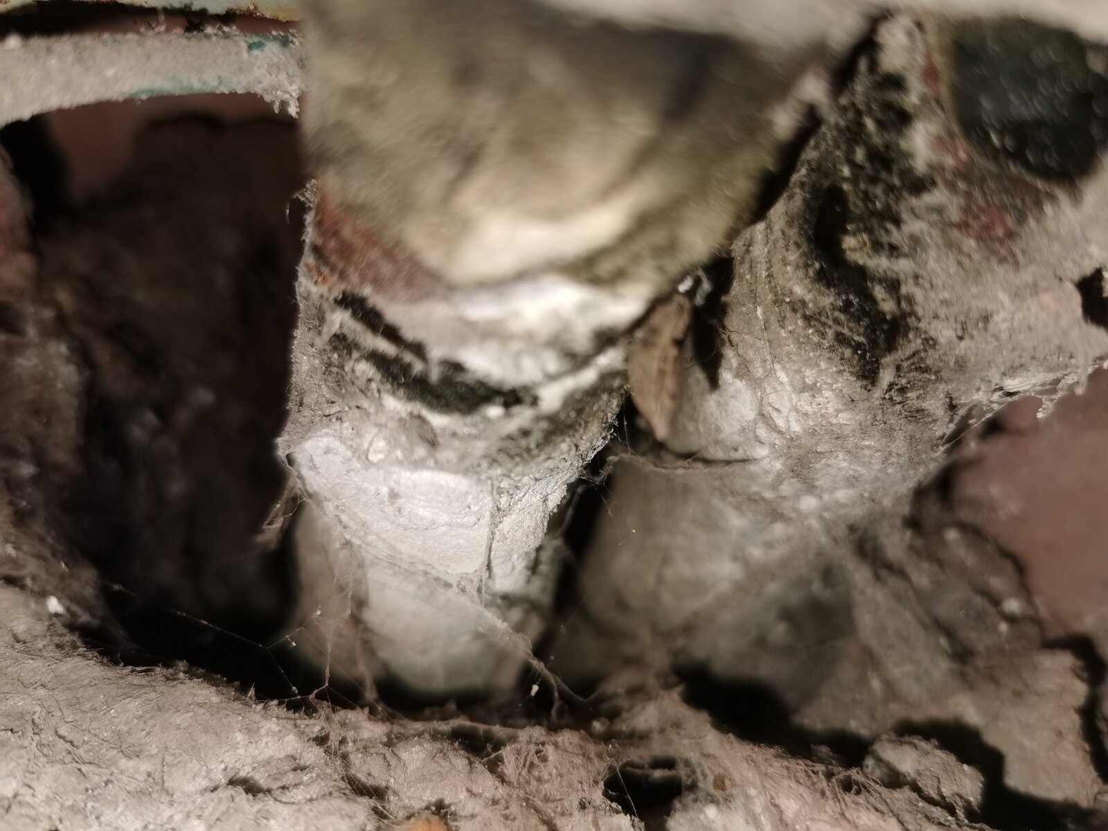

Hi, Looking for some advice !
I have been informed (by national grid callout, main fuse blown) that I have a looped services on the cut-out.
But what's confusing me is that the neighbours already have an overhead line attached to their property, in fact every house on the street does.
I'm curious because they say I can have my meter moved for free if I do indeed have a looped service :unsure:
Cheers for any help
I have been informed (by national grid callout, main fuse blown) that I have a looped services on the cut-out. ... But what's confusing me is that the neighbours already have an overhead line attached to their property, in fact every house on the street does.
That cutout in your photo does appear to have two cables entering its bottom (which is would if the supply were looped), but if neighbouring households were each getting their supplies from their own overhead cables, there should be no need for anything to be looped.
The most likely explanation would seem to be that something has 'changed' at some point in time, making something else redundant - i.e. either one of your neighbour's overhead cables is not connected to anything, and they are getting their supply looped from yours (which seems like a very improbable 'direction of change') OR ELSE all of your neighbours are now getting there supplies from an overhead cable and a previous looped supply from yours is no longer connected to anything (i.e. no longer being used).
Unfortunately, from where we are we could not determine which of those (or some other explanation) is the more/most likely!
Kind Regards, John

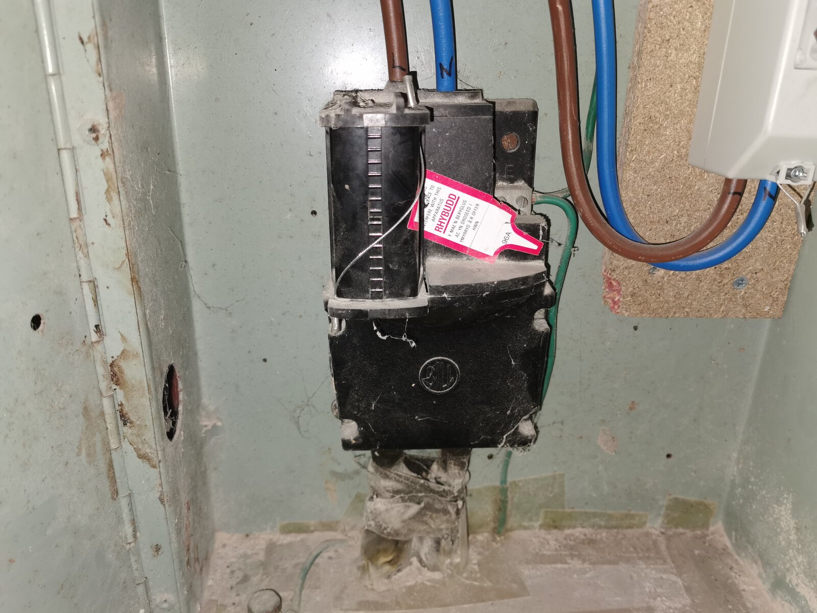

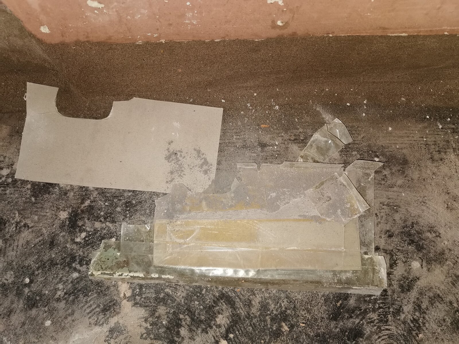

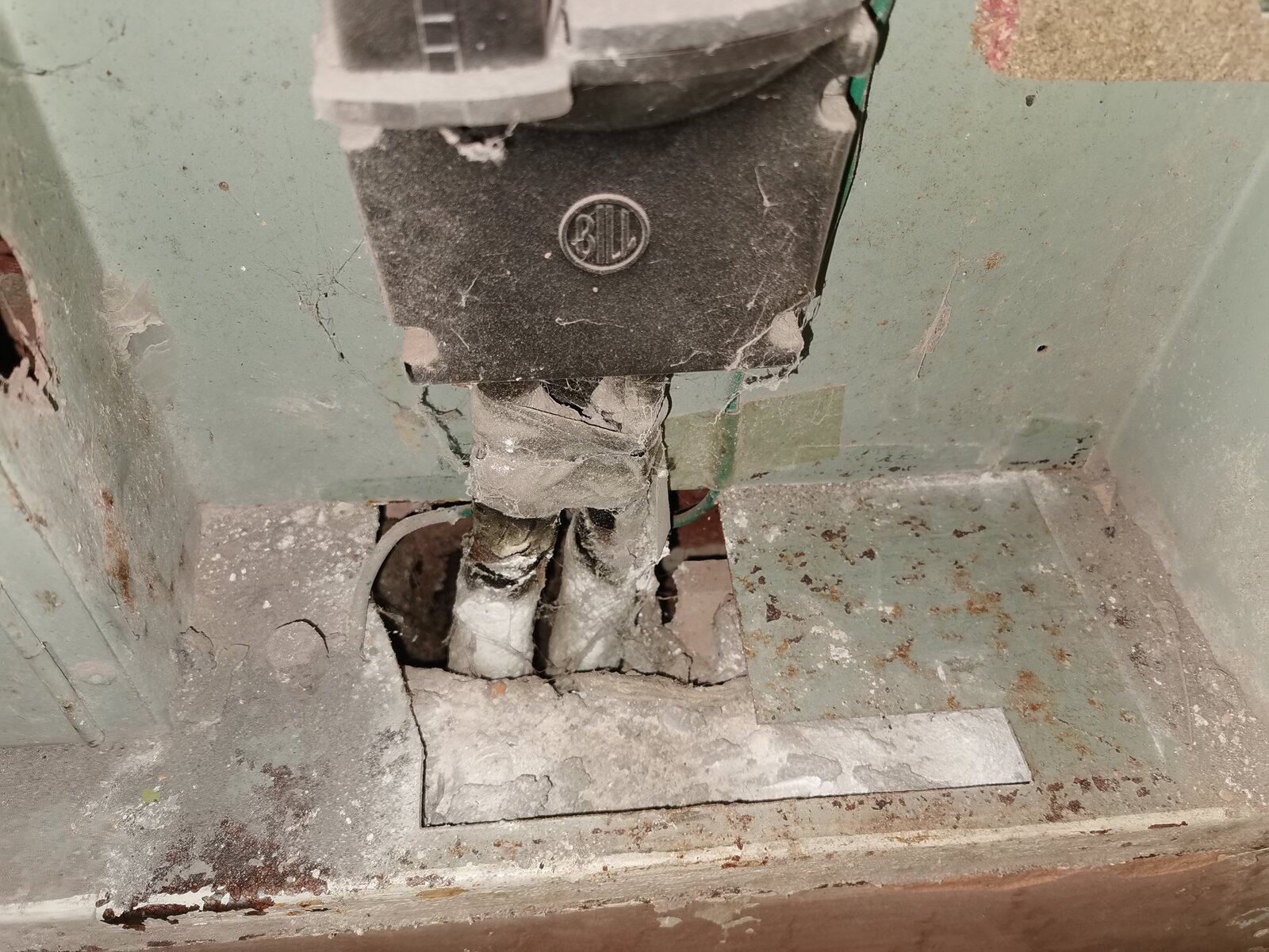

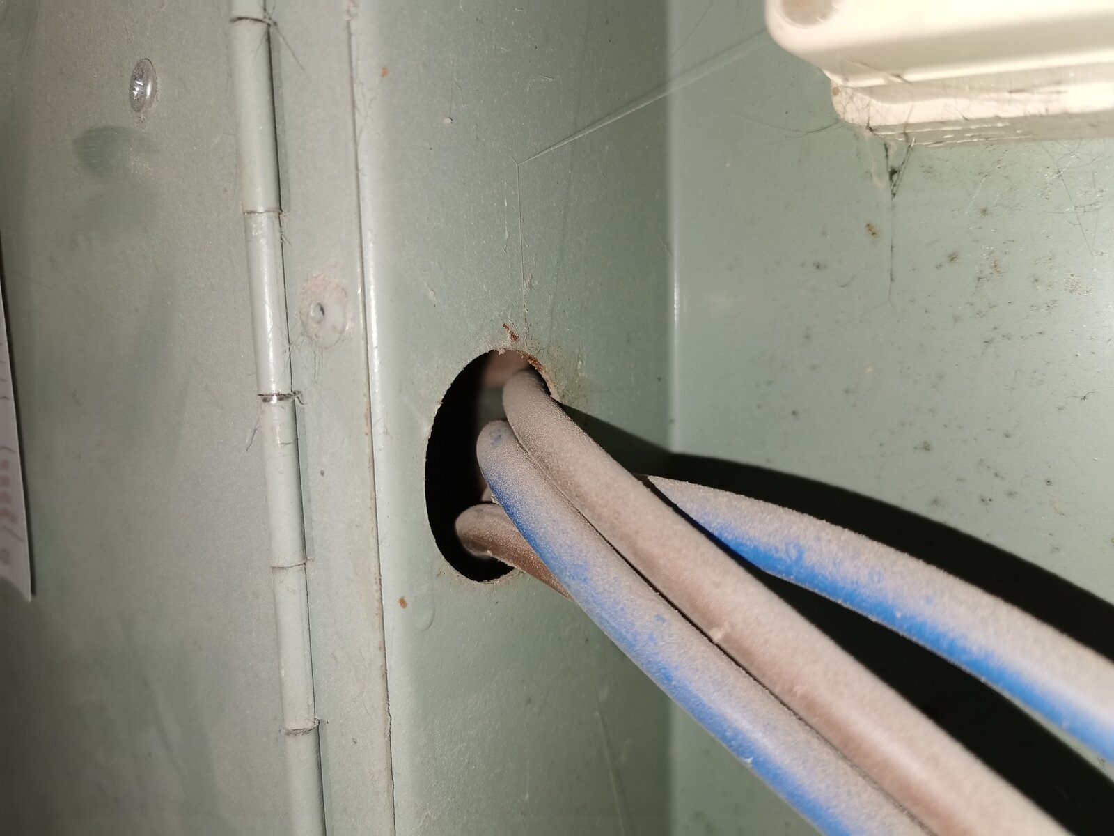

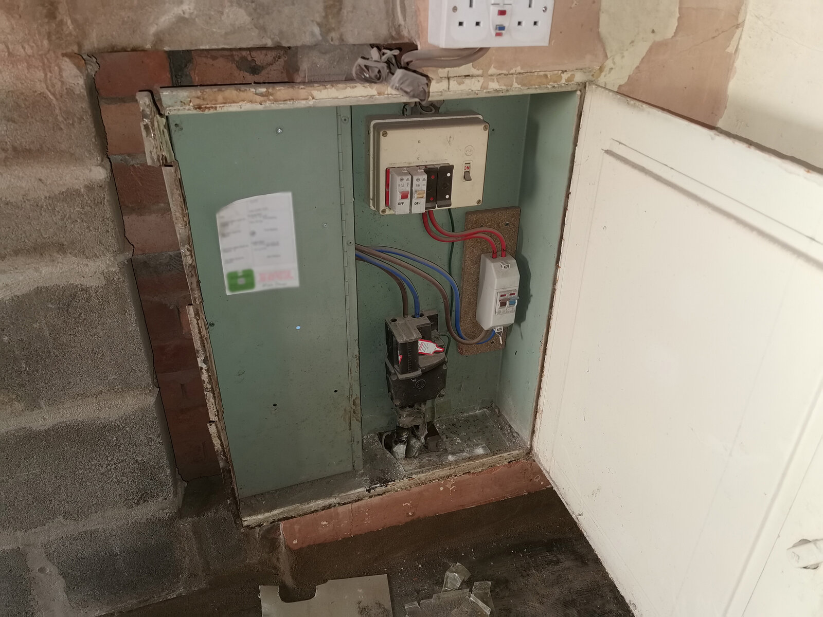

Hi, I could do with some guidance please...
It turns out I had it wrong with the overhead cable, our overhead cables are telecoms. I think what confused me was that the opposite (older) properties do have overhead power cables.
Anyways, our electric service cable are underground and is indeed feeding our neighbour (looped supply).
I have asked them to remove the looped supply and move the meter box outside - They have quoted £1000, on the condition that I provide excavation works to expose the existing cable on our pathway. I think they said they would join/extend my existing cable underground, but completely replace the neighbours cable from the public footpath to their property.
I assume they would remove the loop free of charge, but obviously means keeping the meter/cut-out box where it is.
Current meter box is really ugly and draughty needs sorting (hole was sealed up with cardboard/sellotape by previous owner)
So I think my best option is to request they remove the looped supply (hopefully for free) and keep the existing meter inside (build door/cupboard over meter)
This would then allow me to request to disconnect the electric for a few hours or few days not a big deal as house unoccupied, while I rebuild internal wall and replace meter box with i.e. ABS enclosure.
Can everything be placed in one big ABS box? (cutout, smart meter, isolator, consumer unit) ?
Thanks for any help
