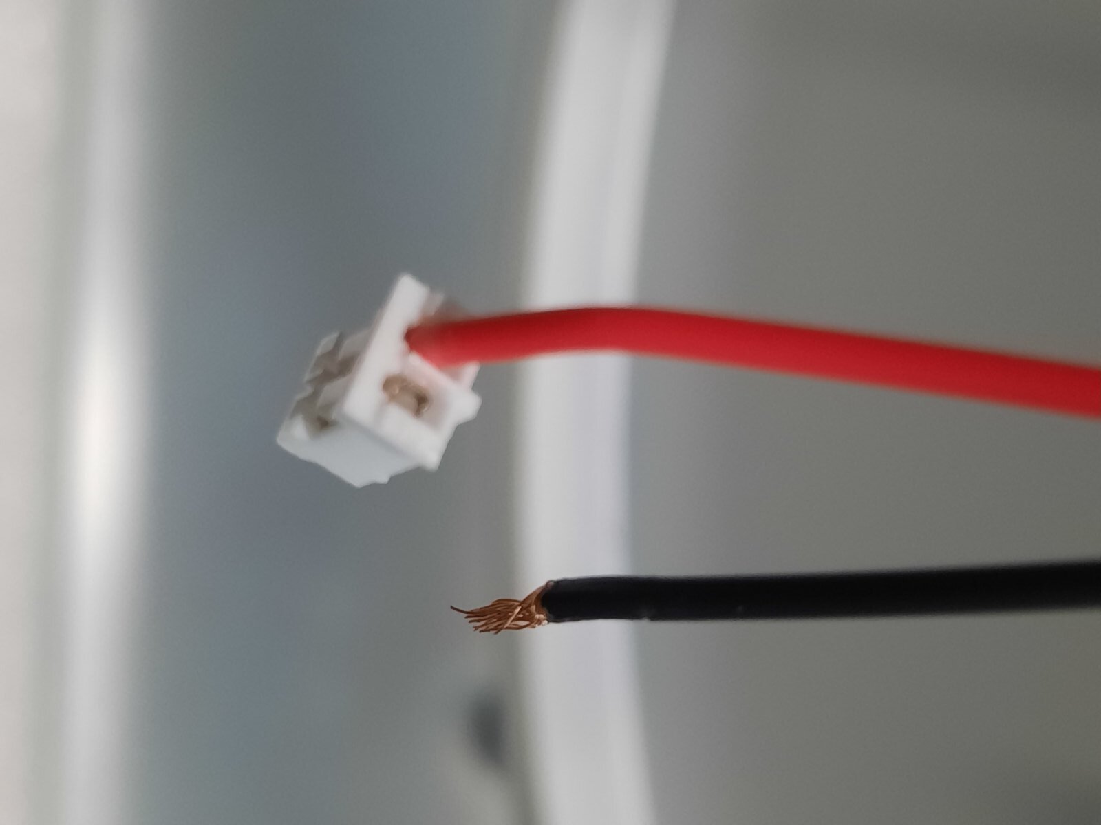

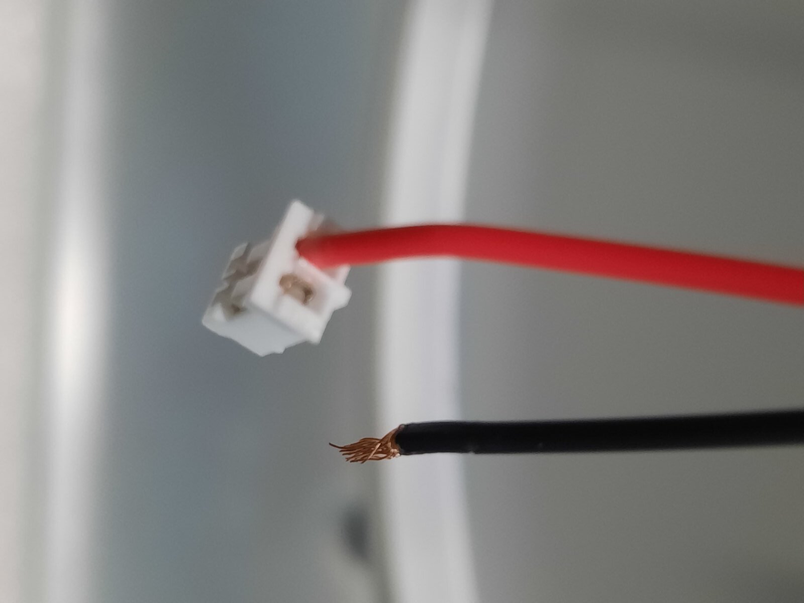

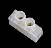

Hi, anyone offer any me advice on how to connect the Black wire back to this connection, or replace the connection.
It's on an illuminated LED Mirror, it must have been crimped, as I push it back into place it just keeps coming out.
Many Thanks.

The crimp should be possible to take out by pushing down a tab on the side with a sharp point and then sliding it towards where the wire was. Then you could either squash the wire in place wire pliers or solder. I would probably solder.
Thanks for that, re-use the existing crimp you mean?
What do they call those connections in case I have to replace?
Many Thanks.

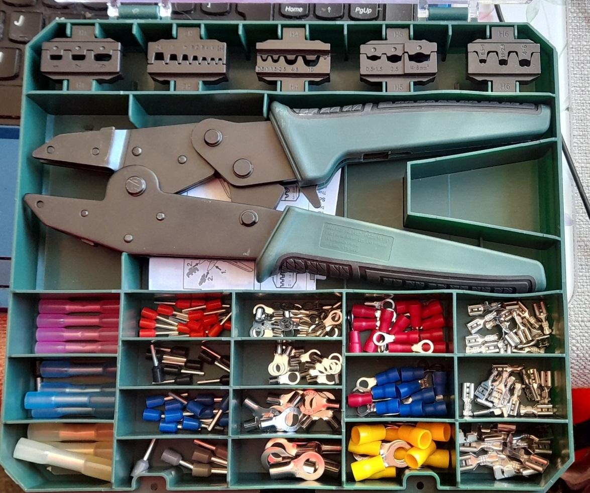

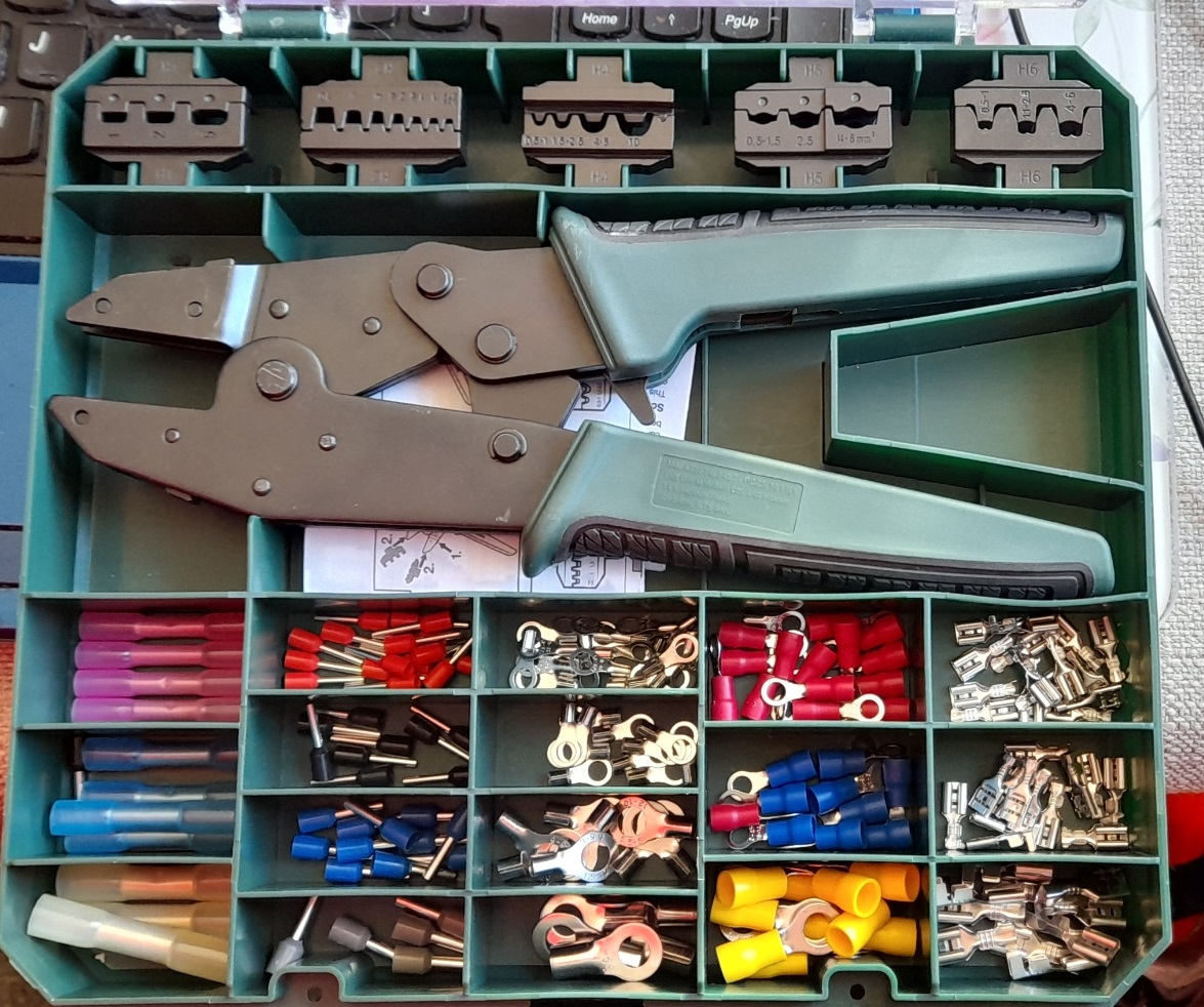

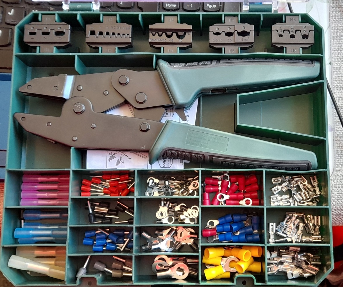

I see the problem, I do have the pliers, Crimp plyers.jpg but it does not have all the crimps, so likely need a soldering iron to continue using the quick connector. My set came from Lidi, the idea of the over centre pliers is the crimping pressure is controlled, but use another make of crimps, and calibration is not valid, so seems likely a soldering iron job anyway.
I see the problem, I do have the pliers, View attachment 404649 but it does not have all the crimps, so likely need a soldering iron to continue using the quick connector. My set came from Lidi, the idea of the over centre pliers is the crimping pressure is controlled, but use another make of crimps, and calibration is not valid, so seems likely a soldering iron job anyway.

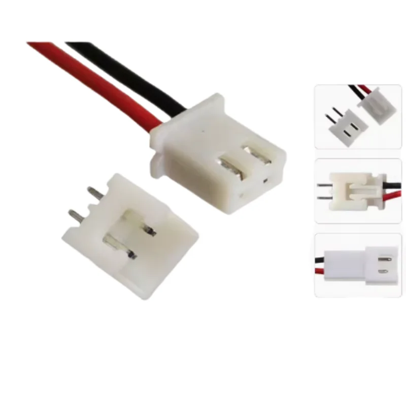

If you check that the pitch is 0.1", then it is probably these: https://www.aliexpress.com/ssr/300000512/BundleDeals2?spm=a2g0o.productlist.main.3.68583ec4k3VAf7&productIds=1005008528175625:12000045574324357&pha_manifest=ssr&_immersiveMode=true&disableNav=YES&sourceName=SEARCHProduct&utparam-url=scene:search|query_from:|x_object_id:1005008528175625|_p_origin_prod:&pvid=06918d29-1bf5-4101-9c77-1e3396db689e
Look down the page for
230 Pieces 2/3/4/5p Male and Female Pin Terminal Kit Housing Pin Header JST XH-2.54 4Value Connectors Adaptor​
£1.30 free shipping.
The tool is available but not worth it for one crimp.
Thanks, much appreciated.
