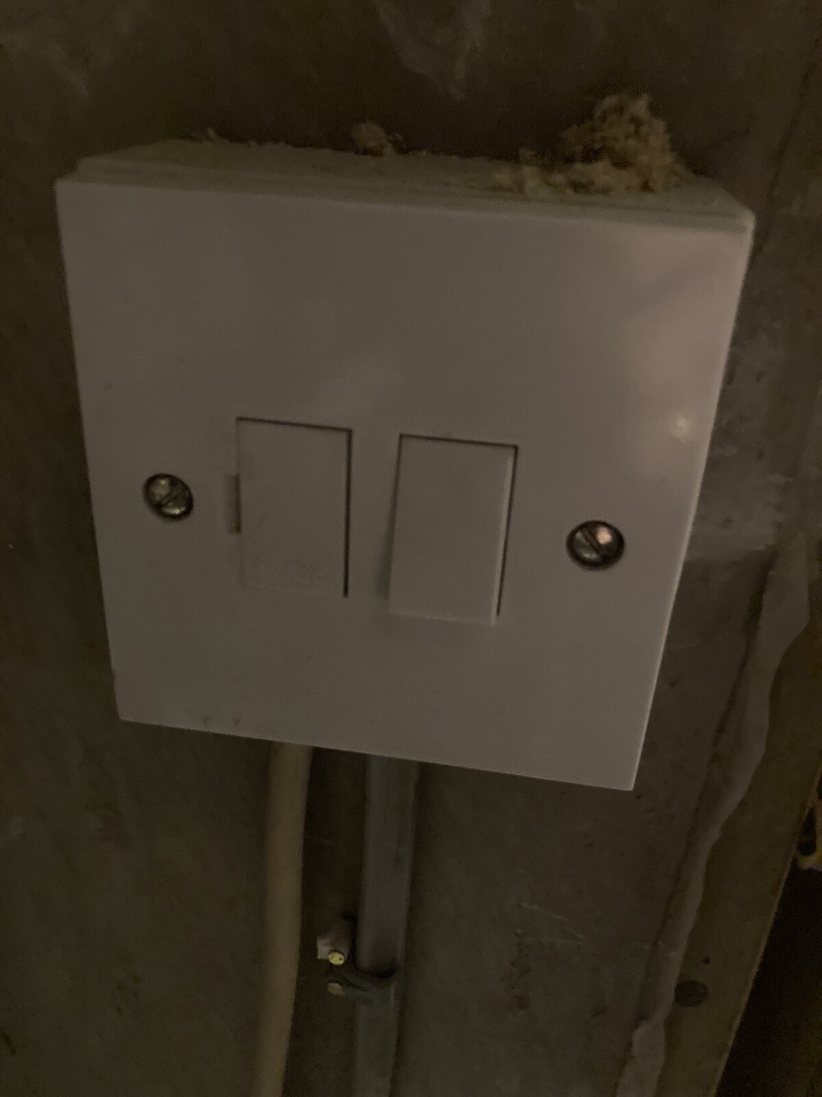

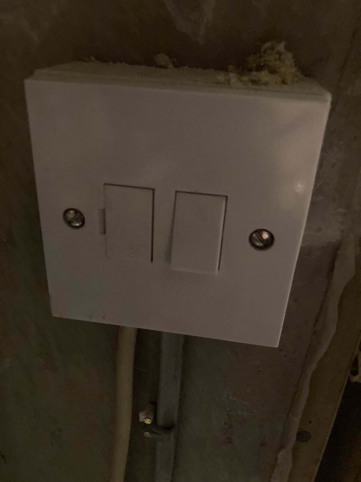

EFL had a look at the immersion heater connection. Looks like the existing control is a switched fused spur. Not switched on at the moment only use it in summer.
As you suggested that does have an Earth connection in and out of it. Would I just take an Earth wire connected to it and the new mirror?
If I took a new three wire supply from it to the mirror would it work even if the immersion heater is switched off?
Sorry meant to include photo
Mmmm. I suppose you could, but it would be better to connect the whole mirror cable.
You would need another Fused Connector Unit (FCU - not actually a spur) with 3A fuse and connect the wires to it from the same terminals as the incoming cable (grey one) in the immersion FCU.
That, of course, assumes the immersion FCU is powered all the time and not controlled by anything else.
