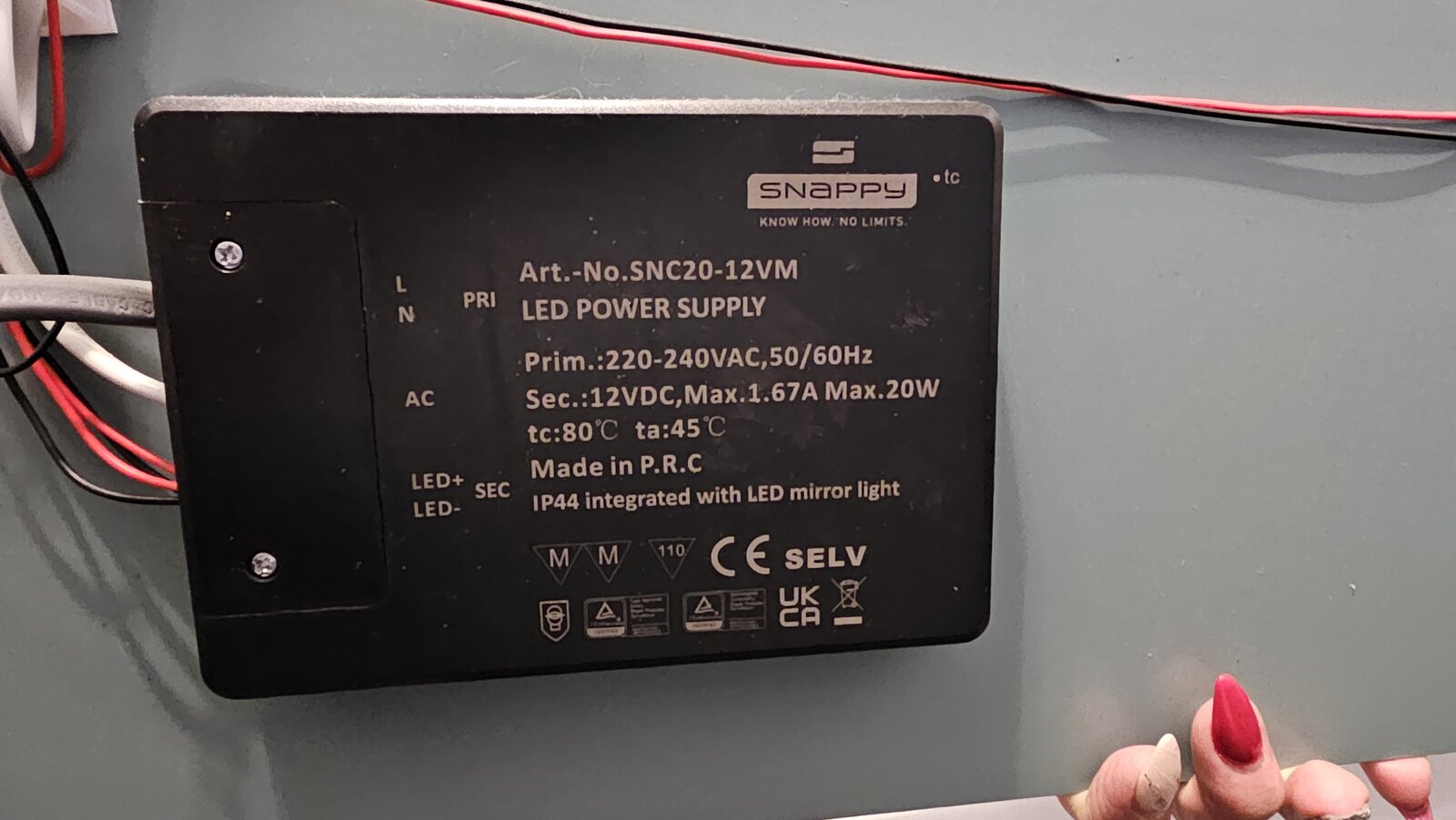

I recently redone my bathroom and I planned to add LED mirror with demister pad. However, I am not sure about wiring it up.
I was planning to wire it up with 1.5mm 2core and earth cable to lighting circuit which is protected by 6A RCD. I wanted to tap into the circuit in the loft with a junction box.

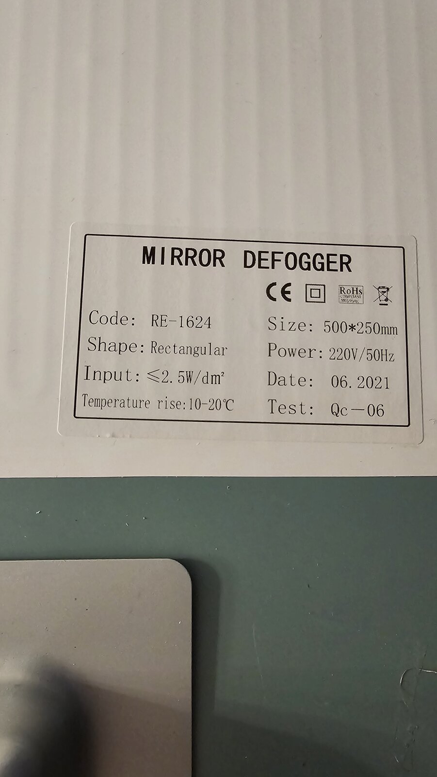

The mirror has its own switch and I wanted to connect it with permanent live from the circuit, so I can turn mirror on without turning lights in the bathroom. By pressing mirror switch it will also turn defogger on. The mirror is also double insulated which does not require an earth connection.
Here is my question: Will this be fine to do?
I don't want the mirror to trip the lights when it is on.
I have attached a photo from back of the mirror to give better idea what I am dealing with.
Many thanks for advice.

If you are picking up the perm live from the ceiling rose, I don't see a problem.
Do connect the earth at the rose even though it is not needed in the mirror. Run it into the mirror and put a connector block/etc over it. In the event that anyone ever accidentally drills in to the cable, they will be protected by the RCD in the consumer unit, assuming that you have one.
Why do you think that might happen?
Just a thought. LEDs do not pull to much load but I am not sure about defogger, as this a heating element. Thanks for advice.
