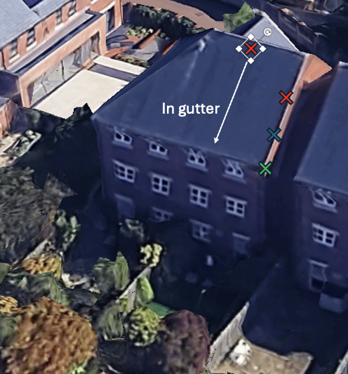

Why not stand back at both front & rear elevations and take pics - your pics might suggest an access route?
It would be best to show where the missing "shingles" are missing from?
Zoopla or other realtors might have taken a drone view of your roof?

Sure, I've marked where the missing shingles are
Red crosses are individual snapped shingles. Blue cross is shingle that looks like it's about to fall over the side.
Green cross is snapped end of gutter (most water still goes down the pipe).

I cant see the roof clearly but what you call "shingles" could be fibre cement slates.
These composite slates are very fragile, & usually wont stand much pressure from careless roofers tramping across the roof.
Where did the ladder guy propose to position his ladder
For 1. fixing the verge and 2. the ridge?
The space between the gables would allow passage of a cherrypicker but there is a back garden wall running into the space - anyway, you could call someone with a tracked CP'er
& get a view. Some CP's would reach from the front over the ridge & down to the back gutter but access & a heads up CP operator view are needed.
