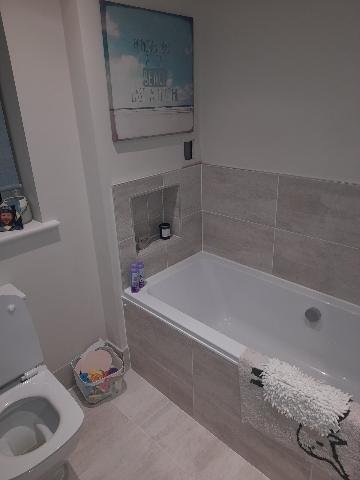

Hi all
After some advice....
We are getting fed up with our waste knocking each time we use hot water.
the knoking seems to only when we run the hot water from a cold start in the ensuite. Guess the pipe is just cold and the hot water makes it move enough to make noise.
I can feel the ticking and knocking if I put my hand on the pipe, so pretty sure it's not a copper feed knocking into it or anything.
Anyway any views on how best to dampen the noise off without taking the wall apart too much - planning to paint but not re tile or plaster! Wondered about some spray foam, or trying to pack some rockwool in there. Wall is block cavity with the battoned and boarded boxing in.
Thanks!

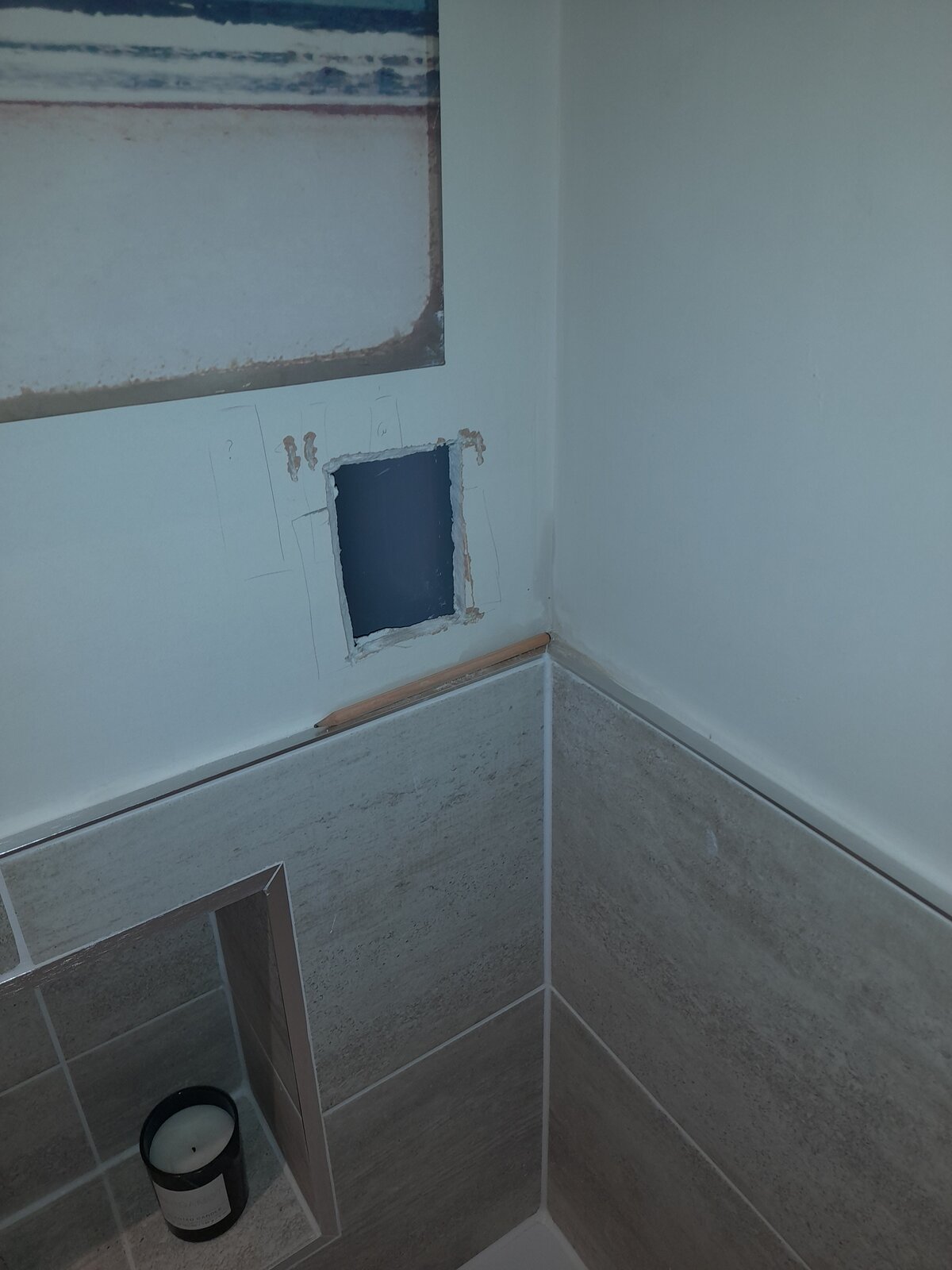

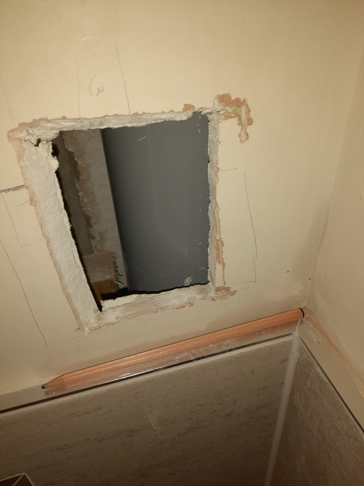

That might be my next step...its tiles but looks like a screw rather than adhesive for access....
Remove the screws then cut along the edge with a stanley knife and then try and prise off.

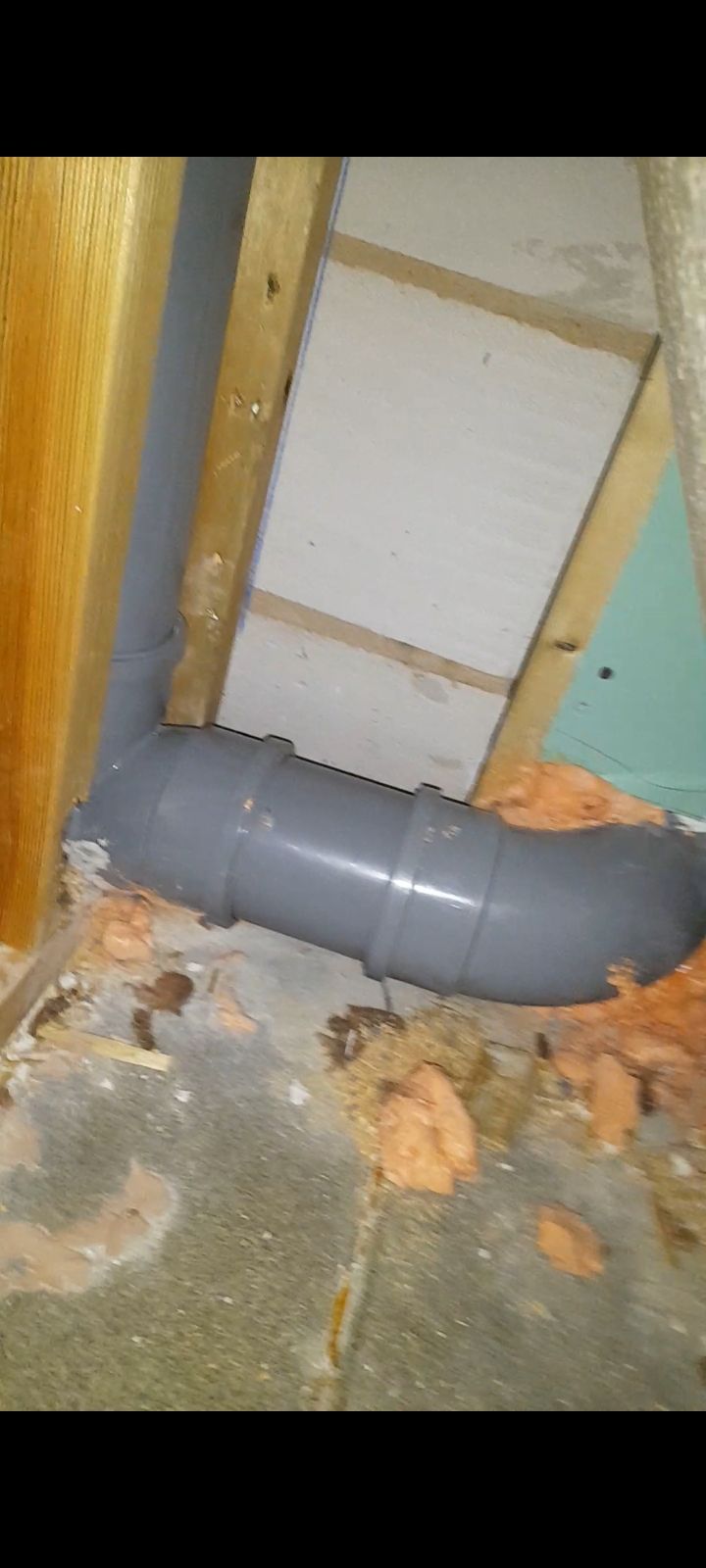

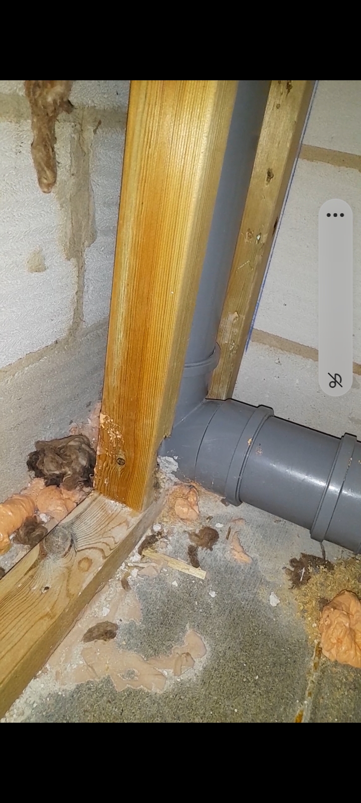

So......managed to get access under the bath. The spare inlet boss was touching an upright stud, so have trimmed that back which has helped stop the reverberating.
However, where the waste inlet from the other room joins the vertical stack inbetween the studs, the pipe is expanding and moving, almost like insufficent expansion room has been left in the joint. Still only makes the noise when the pipe changes temp. However I thought with these fittings it was not possible to over insert the joint.
Not sure on next steps now....access is a real pain, not sure how easy / worthwhile it would be to take the joints apart, trim / grease / reasssmble.
Or maybe the pipe must still be touching the floorboard or stud......
Time to call a plumber I think!
